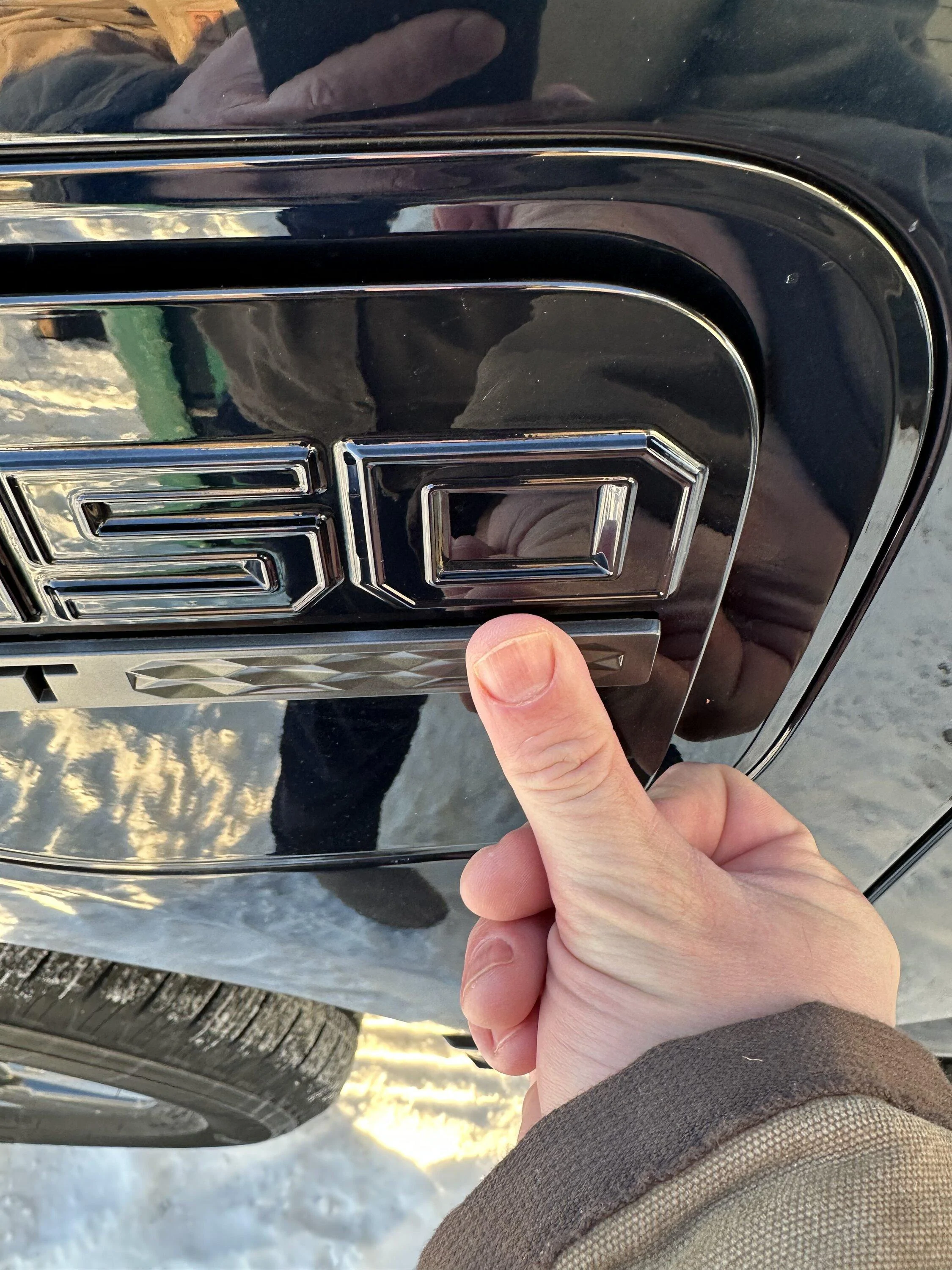

Anyone have a picture they can post with an arrow to the sweet spot on the door ?
If I find it I’ll put a sticker or something on it to remember.

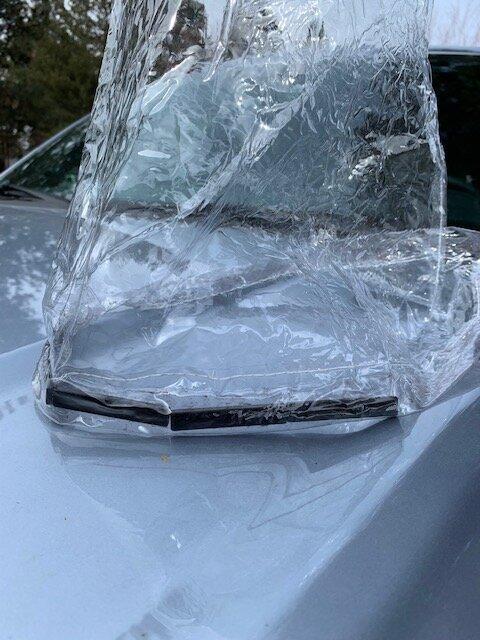

What I did at work a couple weeks back when we had freezing rain is i took a slice of a plastic grocery bag and let it overlap around the outside of the charger door. When i got home after work, i was able to open no problem. Any frozen ice flaked off easily when i moved the plastic. Not pretty, but cheap and effective. Next time though, i will double up the plastic just to make it a bit easier to grab onto without tearing.
thanks!

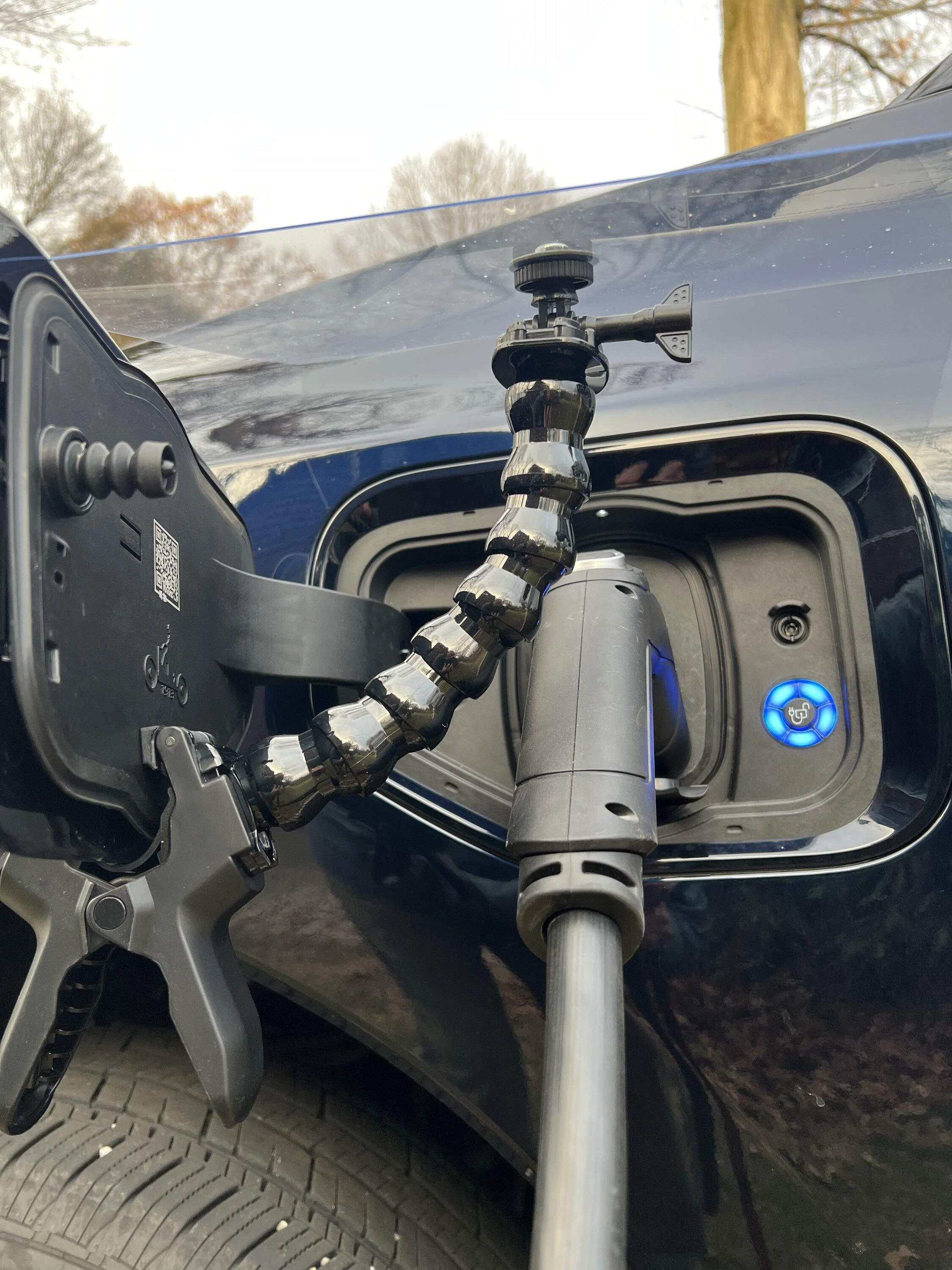

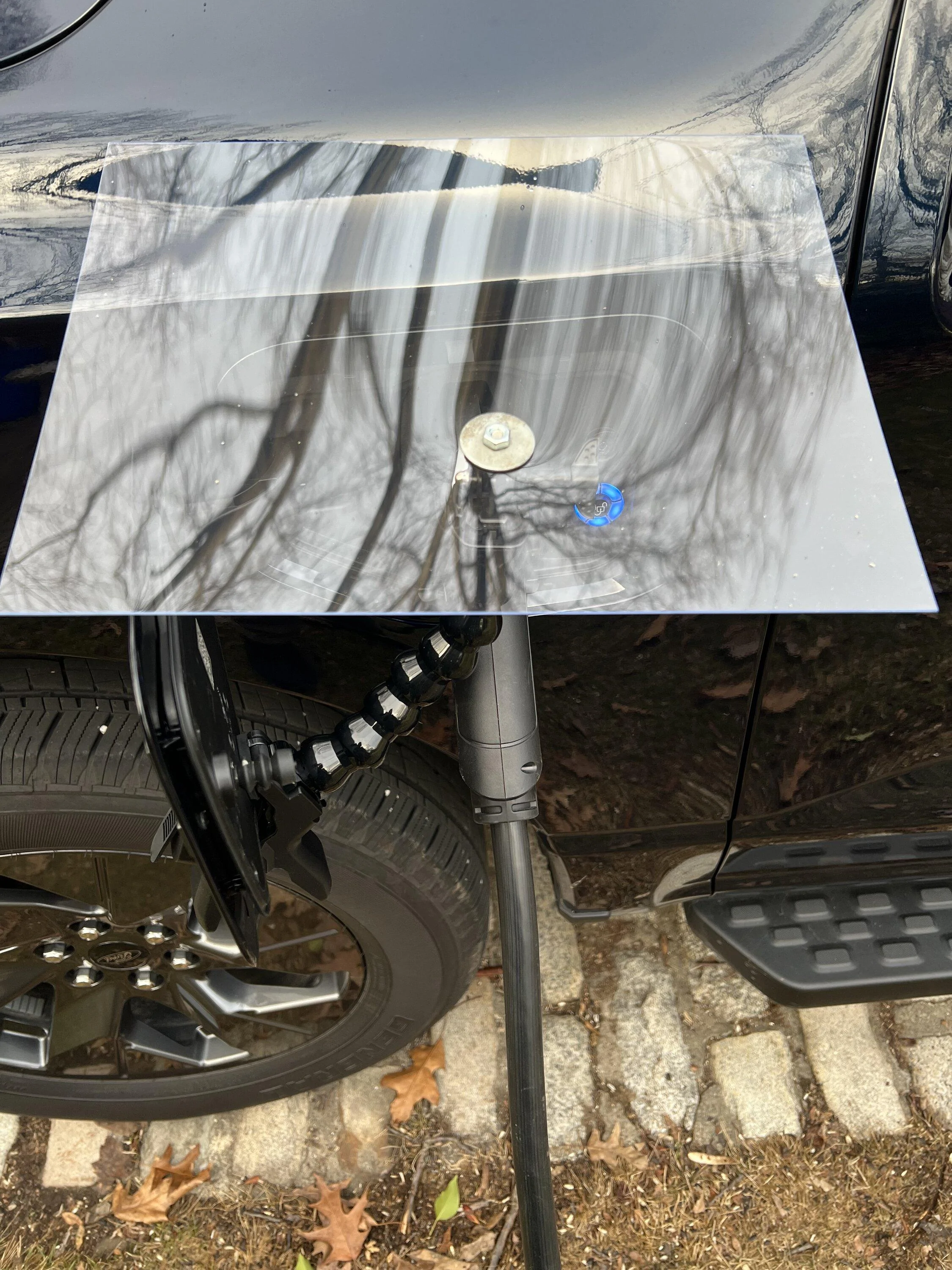

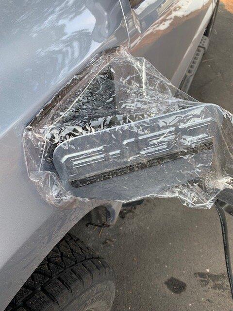

I posted this in another section of this forum but thought it may be of interest to some of you. I don’t like the idea of being plugged in overnight in the rain and snow so I got the phone camera clamp from Amazon for $10 and attached a piece of plexiglass to it. It works great and keeps all of the door mechanisms from get water on them and perhaps prevent more freezing issues.

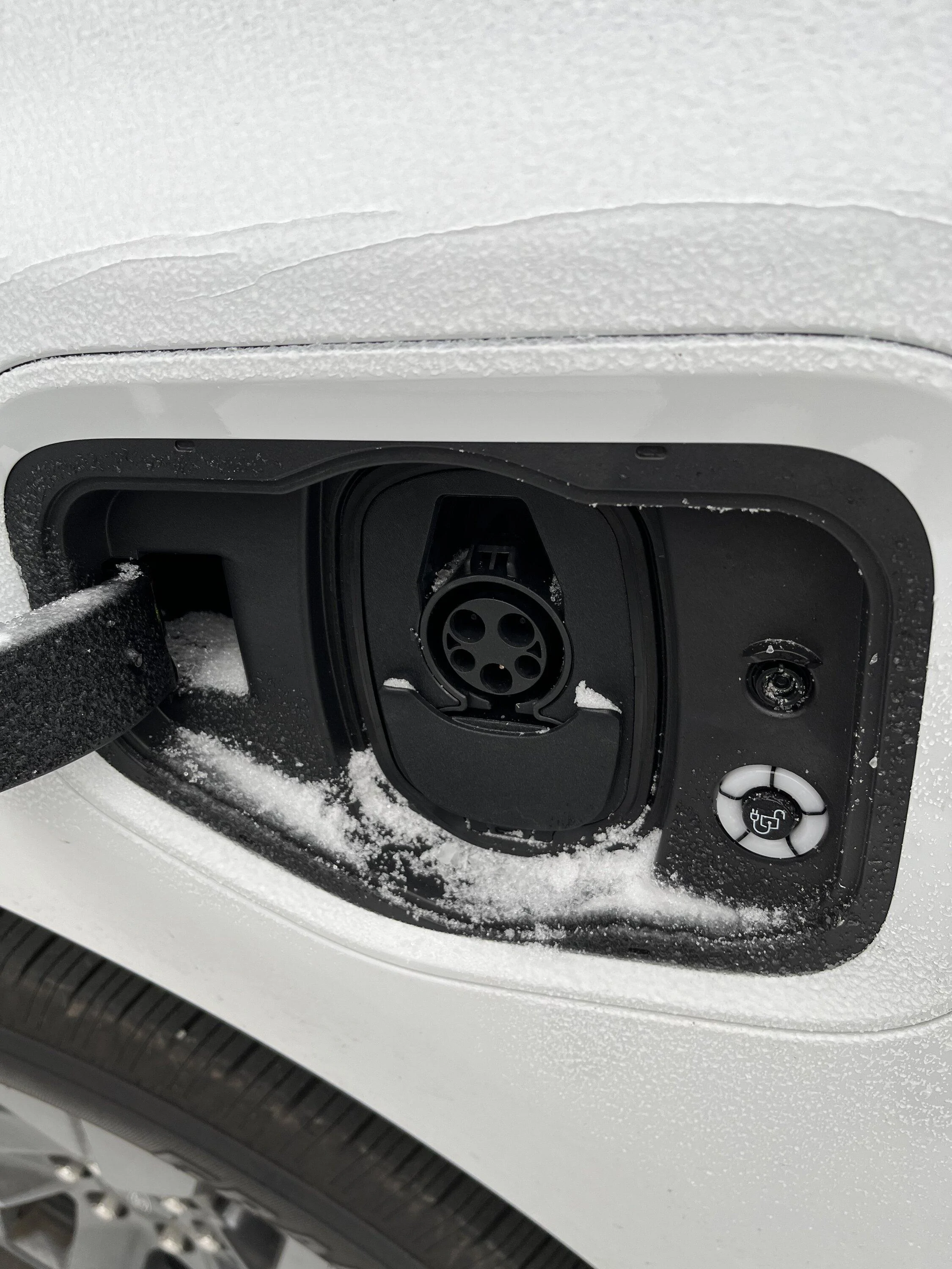

Yes, the charge port door feels cheap, latches and unlatches on the first, second or third try and icing is an issue. One would think the engineers at Ford could have debugged this issue during product development. If I remember correctly it gets cold in Detroit, rain, snow, freezing rain etc.

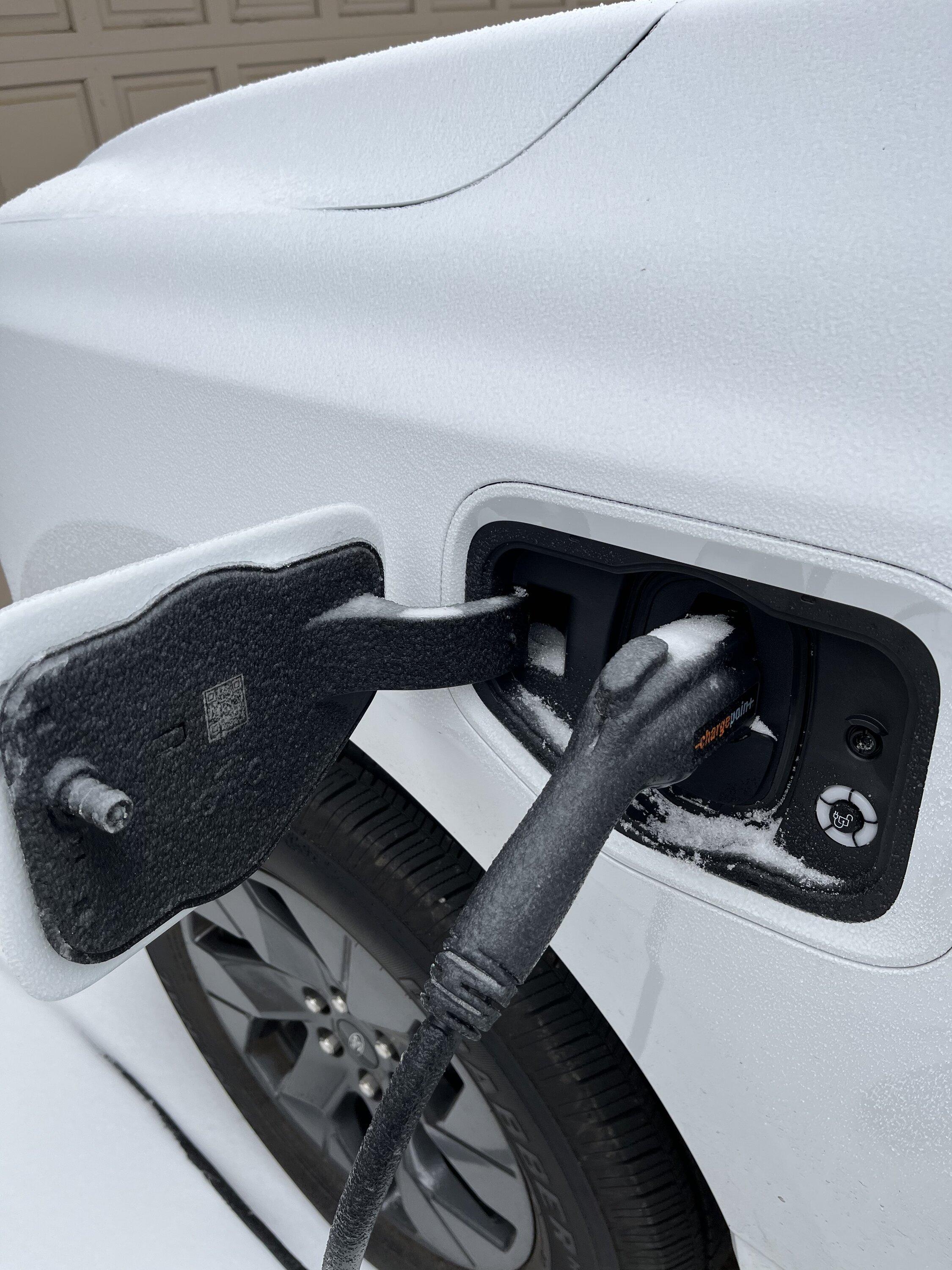

My charge port door latch froze open during freezing rain. The latch pin, door and port housing were iced up solid. This needs to be improved in future builds. I shouldn’t have carry a heat gun around to be able open or close the charge port door in freezing conditions.
Ford F-150 Lightning Charge Port Door Frozen 9293302C-5A5D-4BA6-B203-29BCFF2659A7
Ford F-150 Lightning Charge Port Door Frozen 8C9169FE-DA2A-40AB-8B6F-DCCDAAA1E8FC
