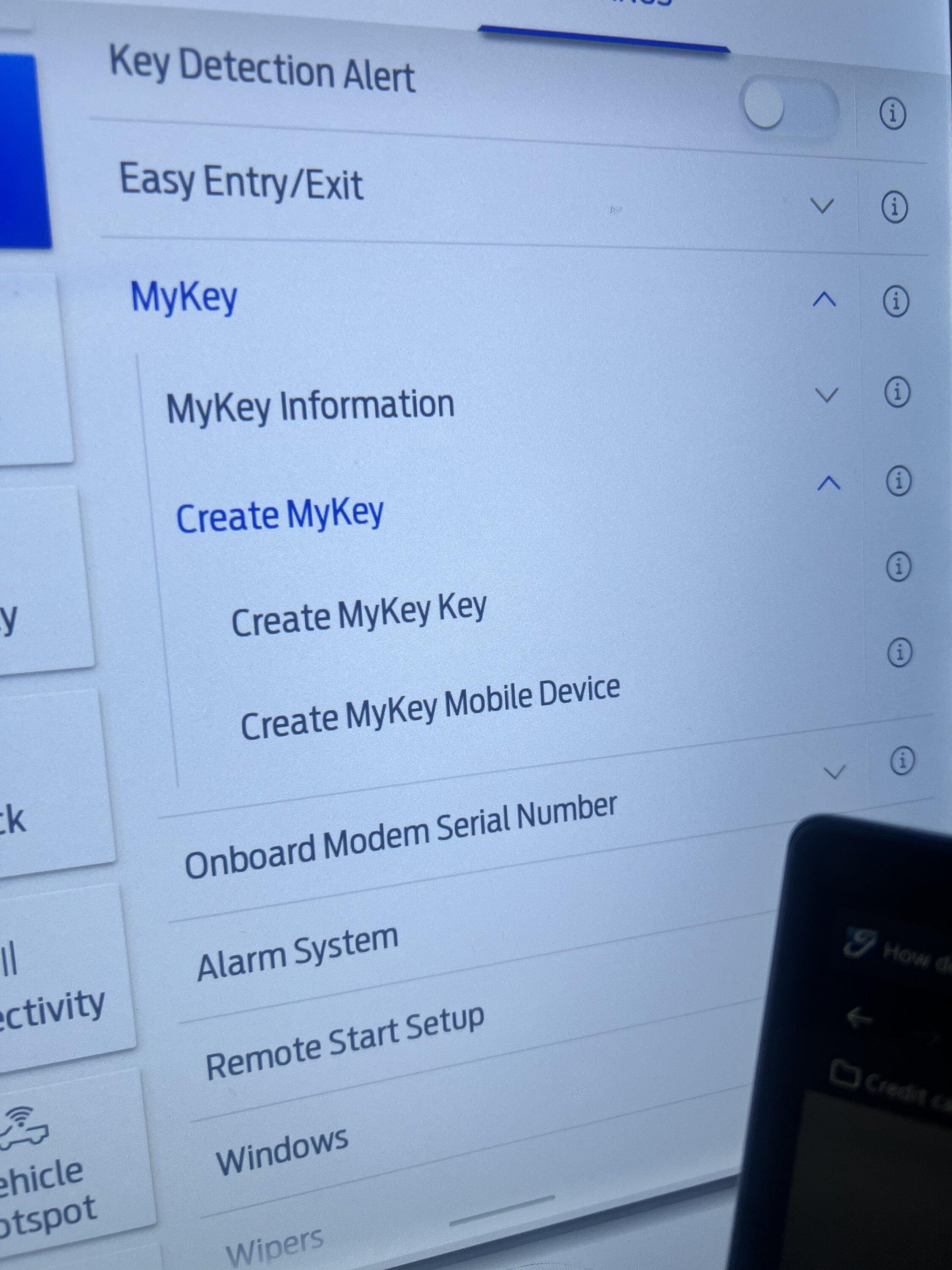

I did a manual update but i didnt check the my key menu. Do you guys have this?

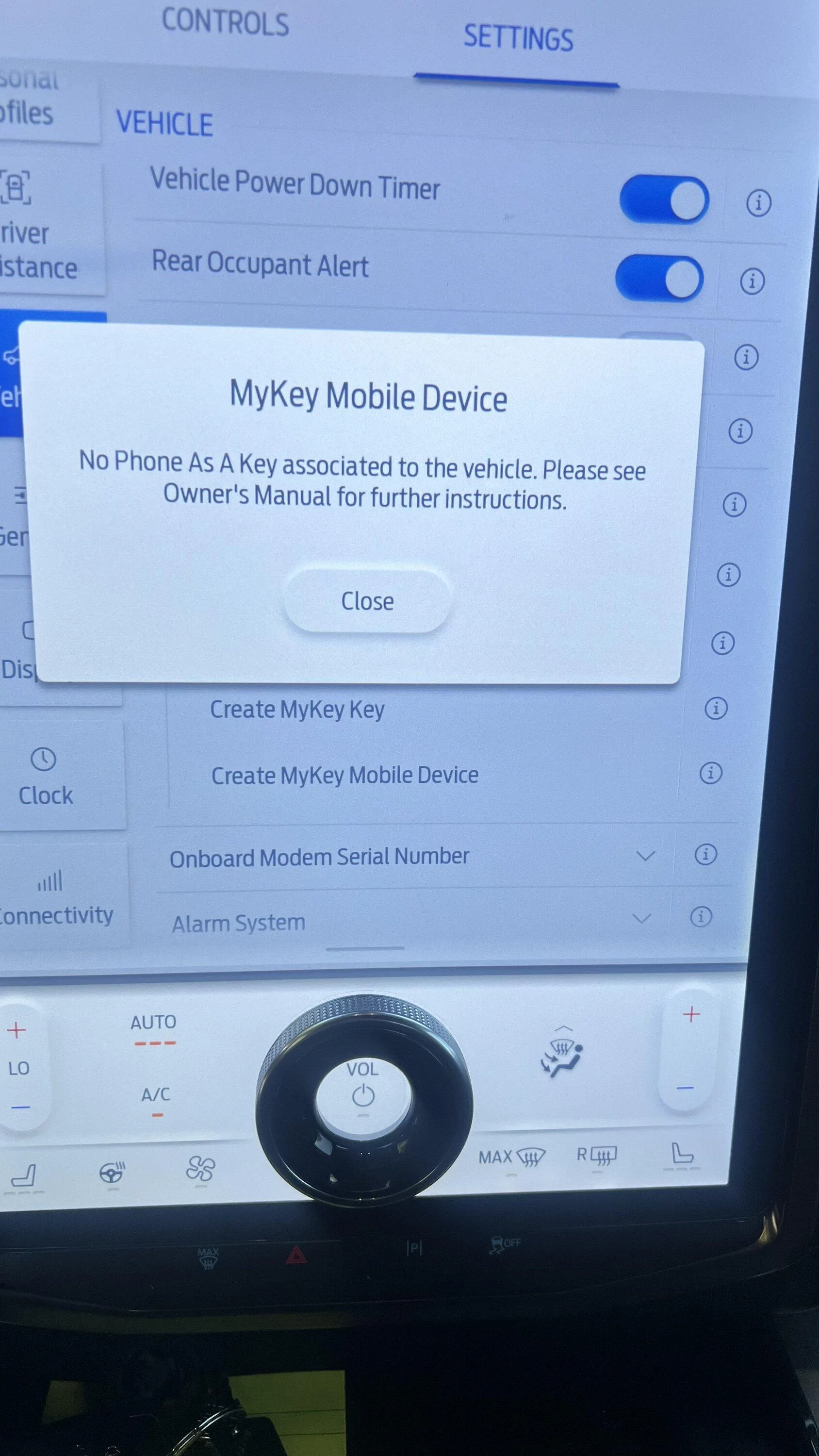

Should have checked if this was there before

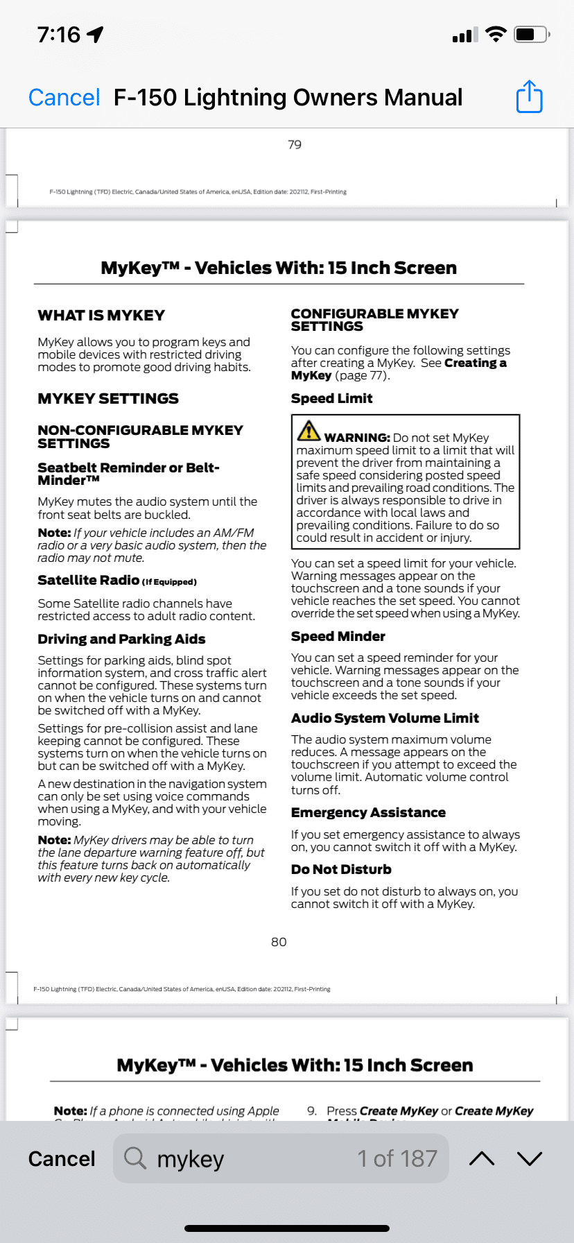

My key is different than Paak. It allows you to put limits on a specific fob
I know the difference I have a Mach e as well. Check the last shot I posted
