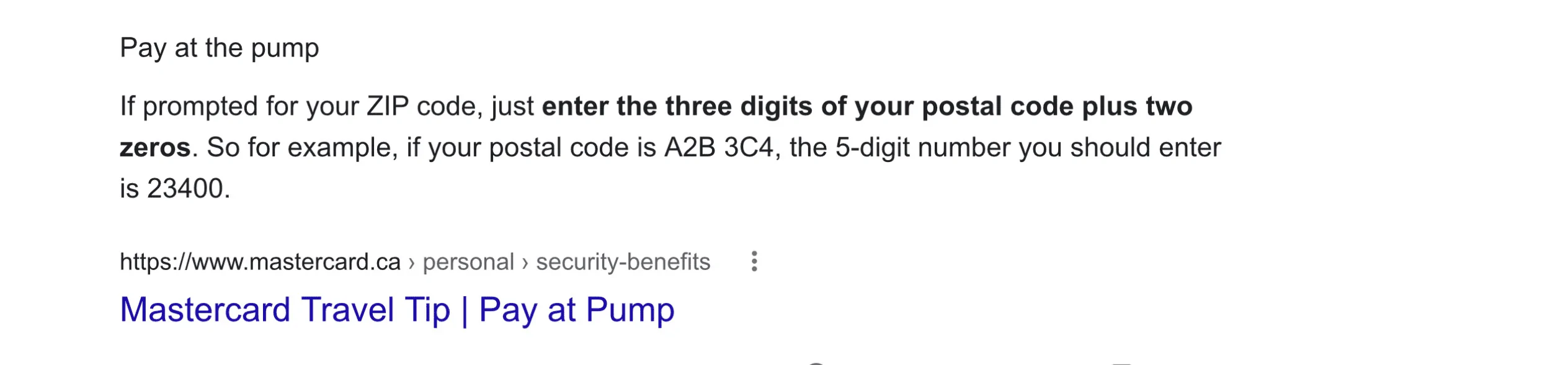

I have had several trips to the United States and never had an issue with charging whatsoever. I have used Electrify America, EVgo and Red E. As far as payment with U.S. apps, you simply just have to do the following. I know you mentioned you tried that, but that has worked for every American app for charging that I have used. I even have my truck set up for EVgo Autocharge, where you just plug in the vehicle, and it bills you without you having to do anything on the charger. You have to set up Autocharge in the EVgo app with your vin. I have never used the Blue Oval network, as far as I am aware. It does not work If you are from Canada you can find the chargers, but you cannot use it for payment. Even in Canada, I cannot get it to work. I have not used the new feature, Charge Assist, in the US yet.

I live in Thunder Bay, ON and drive to Minneapolis. I think the problems charging are with the PAYMENT. I've used the Zip Code trick above and it works (enter the numbers of your POSTAL CODE followed by two zeros). But it is SO TYPICAL in the US that they don't think about us Canadians. In Pine City Minnessota there is a BRAND NEW, BEAUTIFUL charging setup at the Circle K - and no matter what it will NOT accept my Canadian credit card! I've found the other chargers work.
