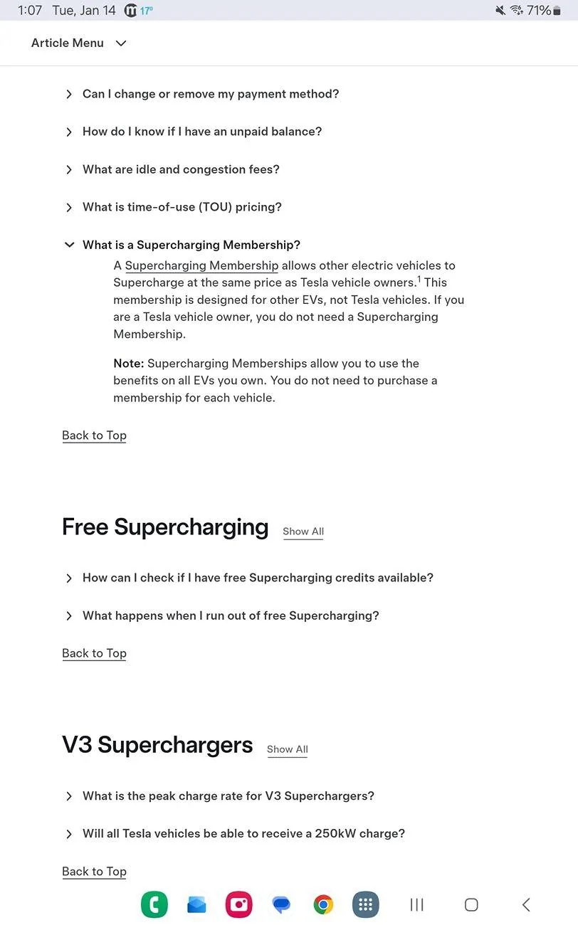

Assuming you are using the Tesla app, make sure you put in your vehicle and indicated you have an adapter. Put adapter securely on nozzle, then plug in.
If you aren't paying for the Tesla membership discount, just use Plug and Charge.
What is the "Tesla membership discount?"
