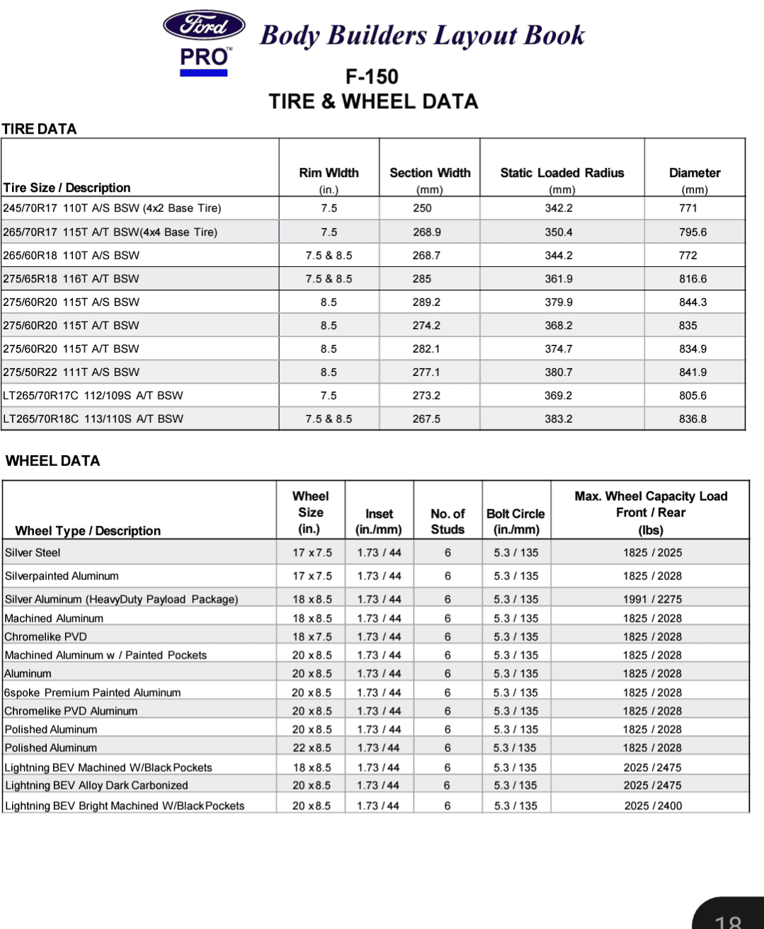

Be aware that of all OEM wheels for other F150 models, only the 18" HDPP wheels are rated for the much higher weight of the Lightning. There are a number of aftermarket options though.

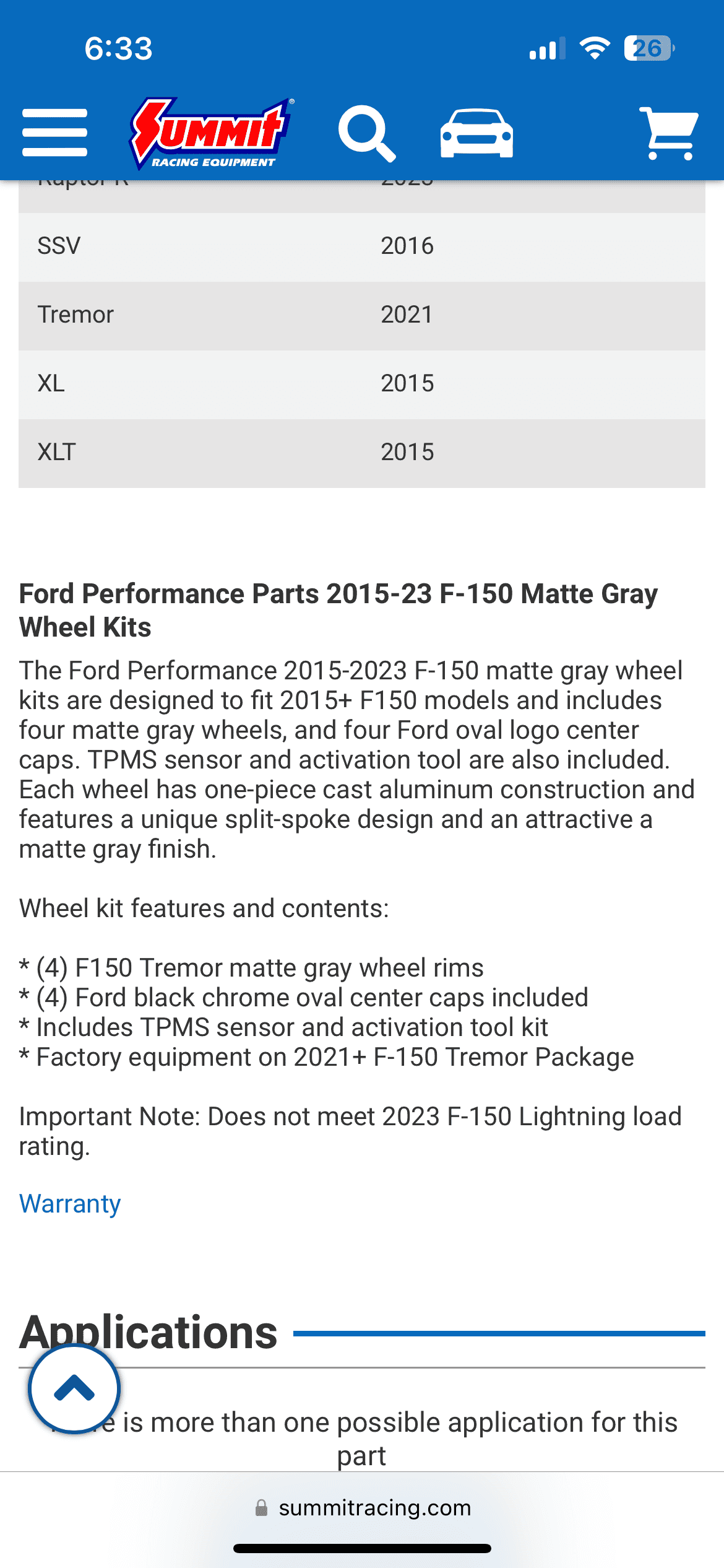

Here is the page from the Ford Body Builder's Layout Book. This is the page from the 2023 book and for some reason it shows a lower (1991lbs) rating for the HDPP wheel on the front axle than 2015 when this wheel came into production, but still 170lbs more than all the other non-lightning wheels (1825lbs). The slight reduction in rating seems to have happened around 2020.

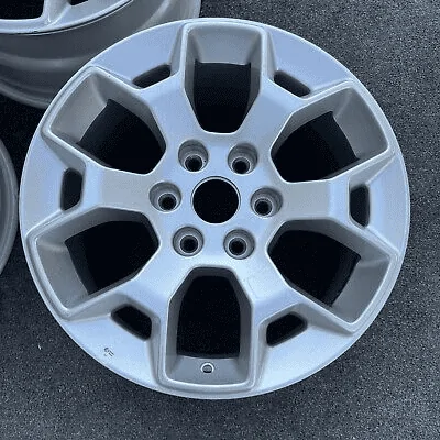

The HDPP "64H" wheel is also known as a 10341. Yes I know that isn't the right length to be a full Ford part number, but that's how it seems to be listed everywhere. Here's one (unfortunately not a set of 4 or 5...) for sale: https://www.ebay.com/itm/114394362283
Watch out, there are a few other Ford wheels that look similar, but they don't have the high load rating. Look not just at the number of spokes but how they branch out when they meet the rim. The 10341/64H wheel looks like this:

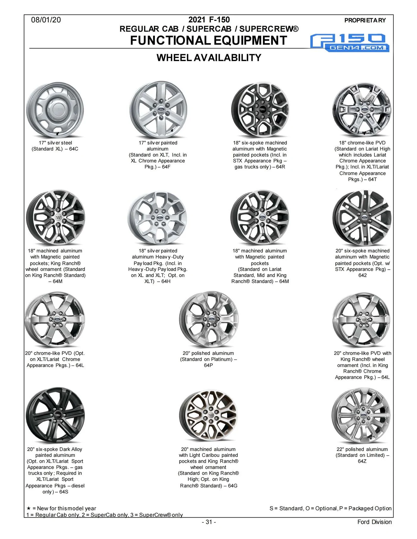

Wheel Specifications
Wheel Type Wheel Size (in.) Maximum Wheel Capacity Load Front/Rear (lbs.)
Silver-painted steel (64C) 17 x 7.5 2,025/2,249
Silver-painted aluminum (64F) 17 x 7.5 2,025/2,249
6-spoke machined aluminum with gloss black-painted pockets (64X) and Magnetic-painted pockets (64R) 18 x 8.5 2,025/2,249
Silver-painted heavy-duty aluminum (64H; Heavy-Duty Payload Package) 18 x 8.5 2,100/2,400
Machined aluminum with Magnetic-painted pockets (64M) 18 x 8.5 2,025/2,249
Chrome-like PVD aluminum (64T) 18 x 7.5 2,025/2,249
6-spoke machined aluminum with Magnetic-painted pockets (642) 20 x 8.5 1,875/2,083 ....STX
Machined aluminum with Light Caribou-painted pockets (64G) 20 x 8.5 2,025/2,249 ... KING RANCH
Chrome-like PVD aluminum (64L) 20 x 8.5 2,025/2,249
6-spoke Dark Alloy-painted aluminum (64S) 20 x 8.5 2,025/2,249
Polished aluminum (64P) 20 x 8.5 2,025/2,249
Polished aluminum 64Z) 22 x 8.5 1,950/2,166

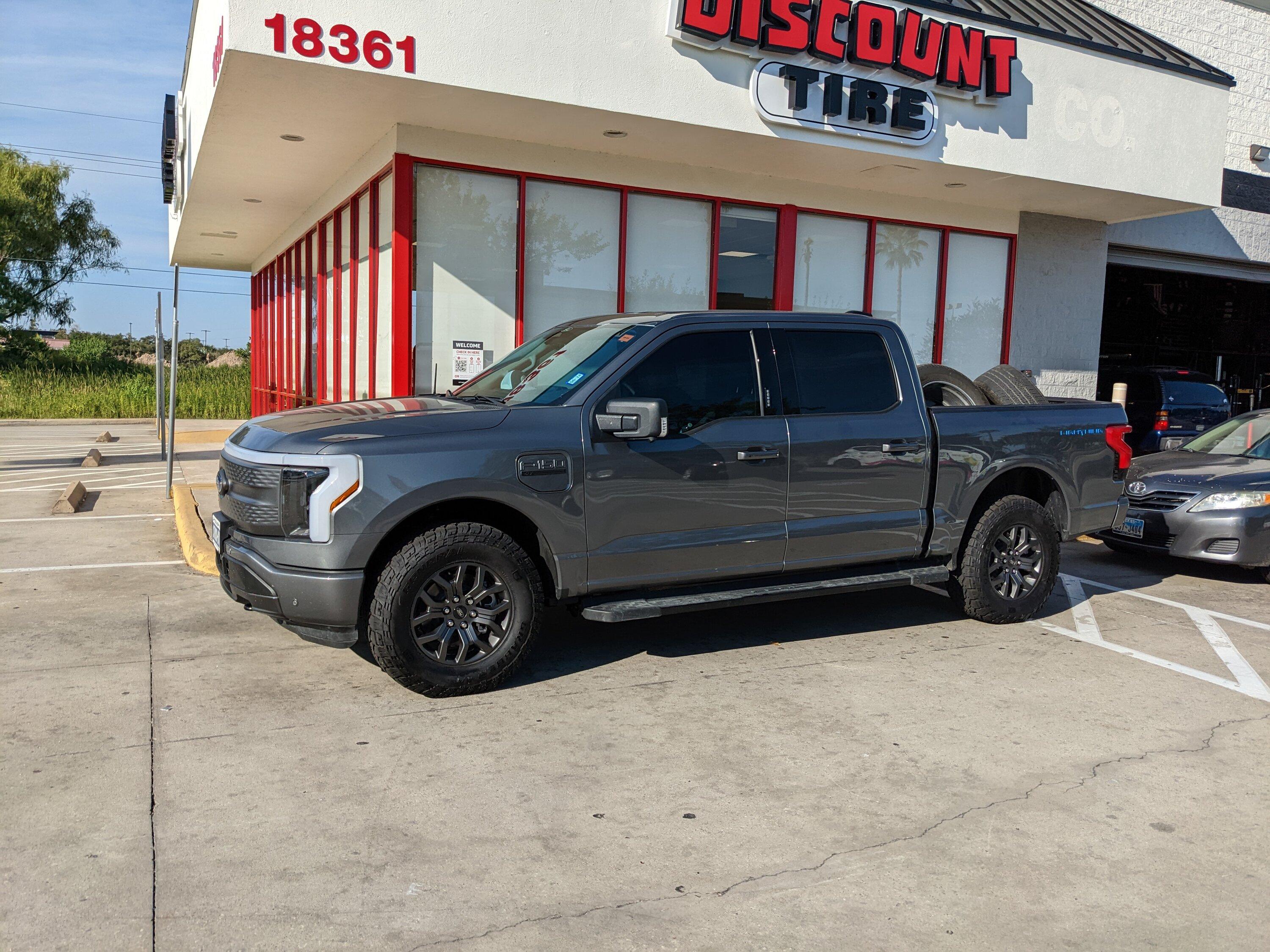

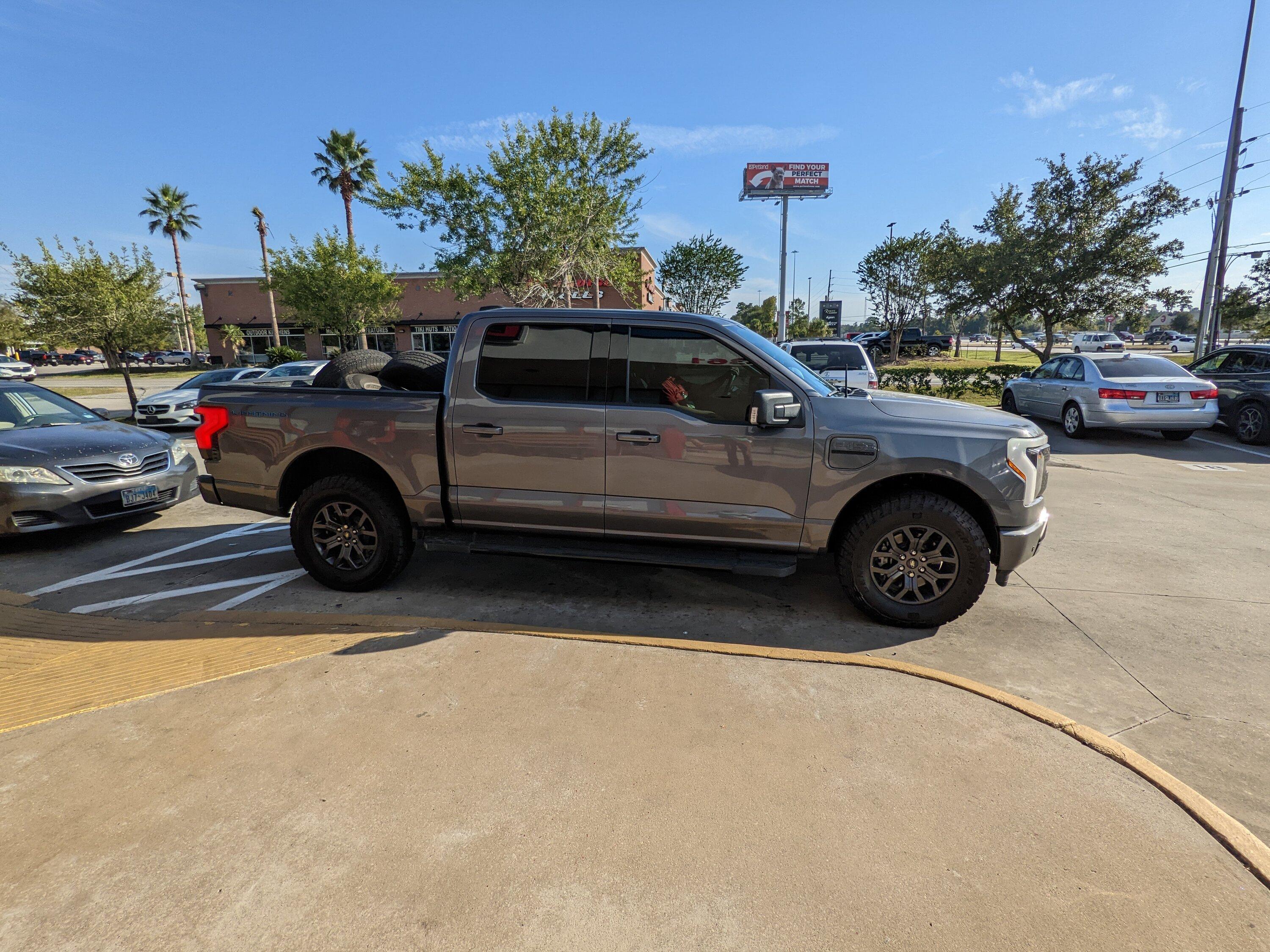

I found a set of Tremor take-offs close by in here in Texas. Picked them up one night and had them put on the next day. I appreciate the more aggressive tread for sure.
I have listed my stock wheels and tire for sale in the classifieds.

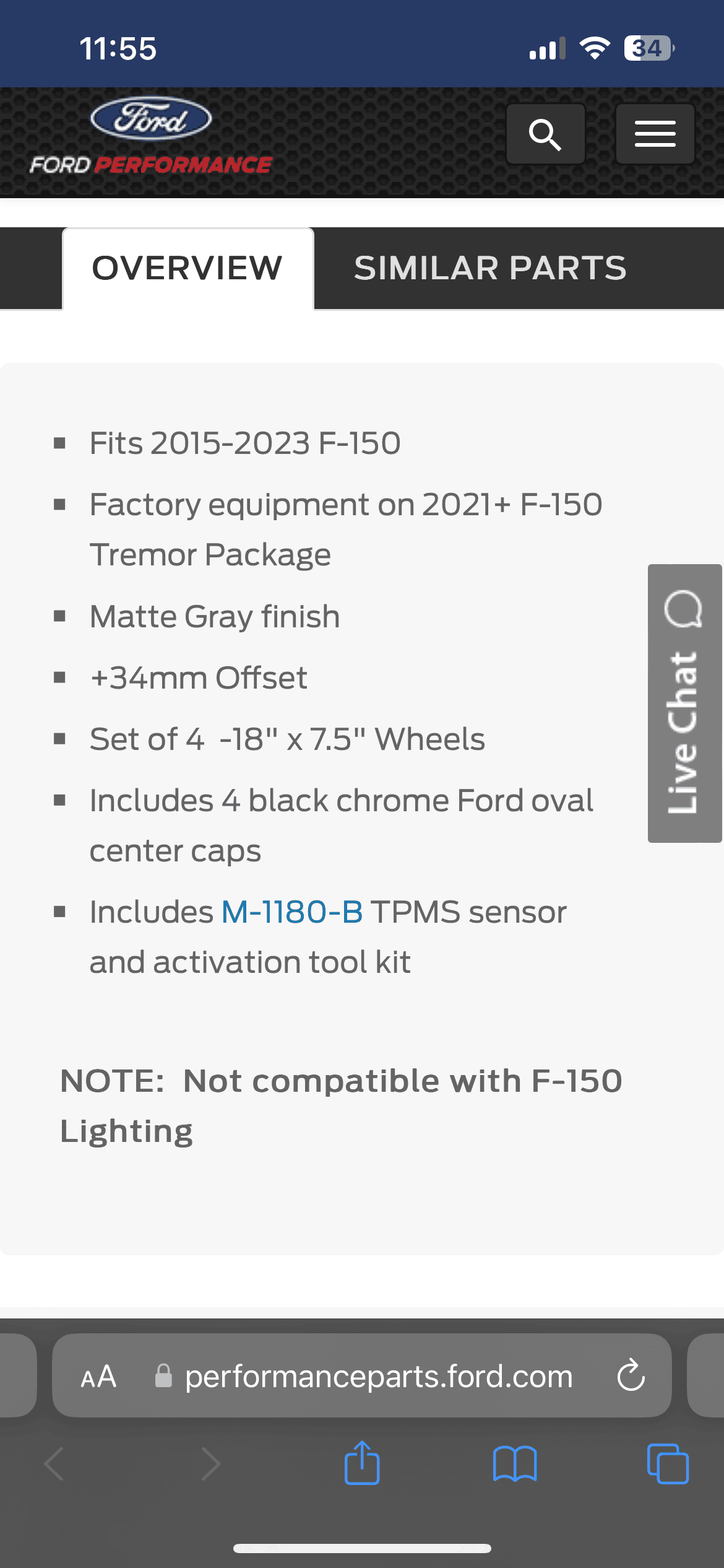

Did you use the TPMS that came with them? I'm looking at buying the set that comes with TPMS (and programmer) and was hoping that they would be able to be programed to the lightning.
Thanks!
