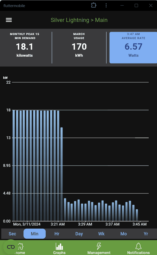

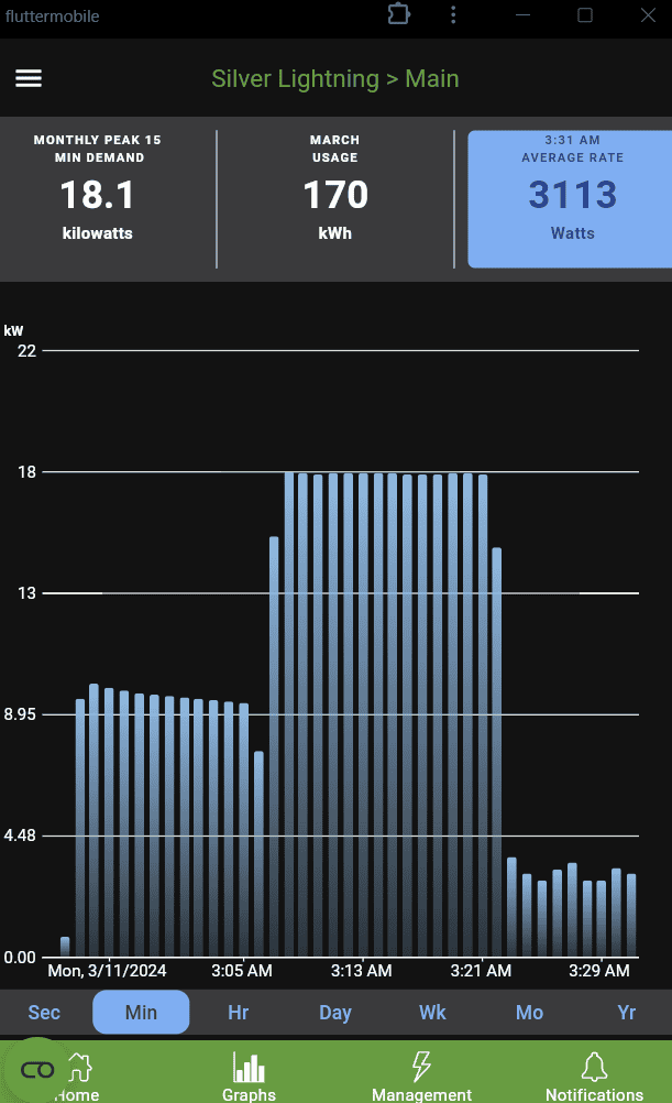

I used departure timer this morning to prepare for a drive to the airport scheduled for a leave time of 3:45, I set the timer to 3:35, it kicked off the battery warming phase at 2:53, timed out at 3:45 as intended, used 8 kWh of energy to get battery and cabin warm, though seat & wheel were chilly.
The event was created Sunday afternoon, though that might be the distinction.
Exactly, I parked and plugged in Saturday night and didn't touch it until this morning. I edited the schedule today. The truck cabin was heating by the time I made it to the end of the block, battery temp was a little cool but it had maintained a 100% power level. Only -6 deg C but I'm so happy to have the heated wheel now.
