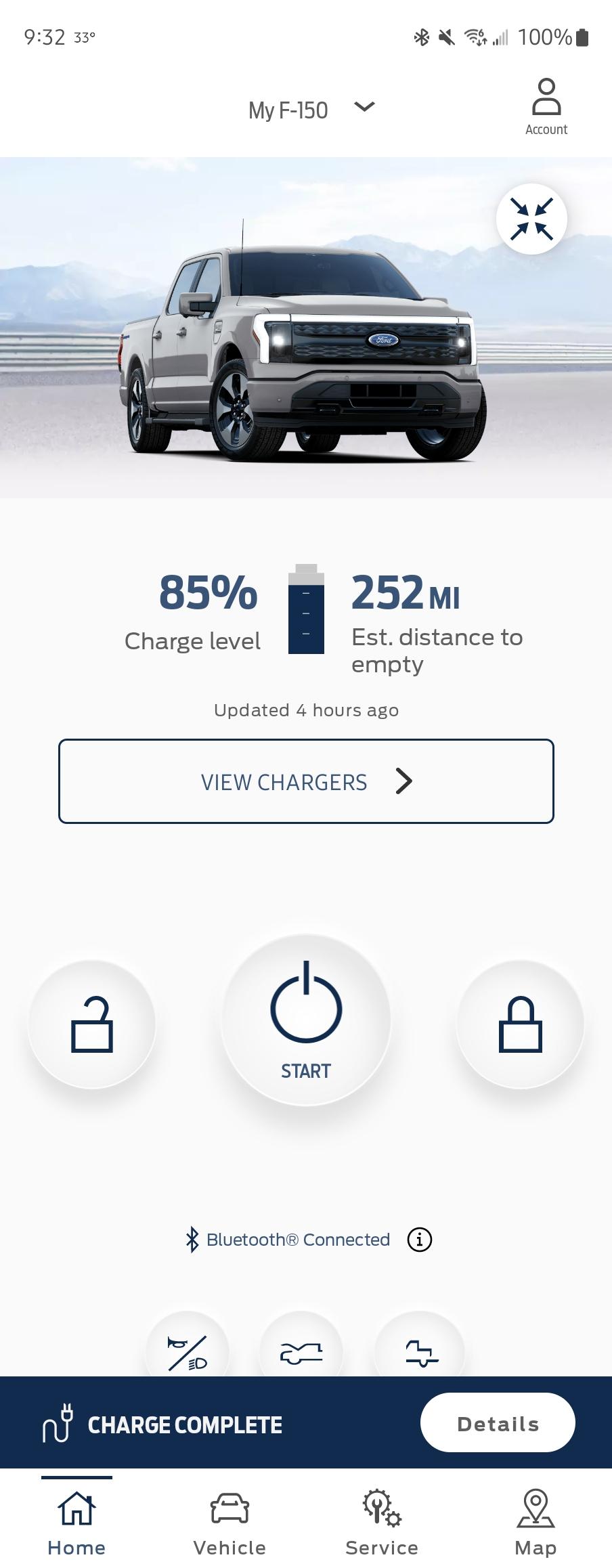

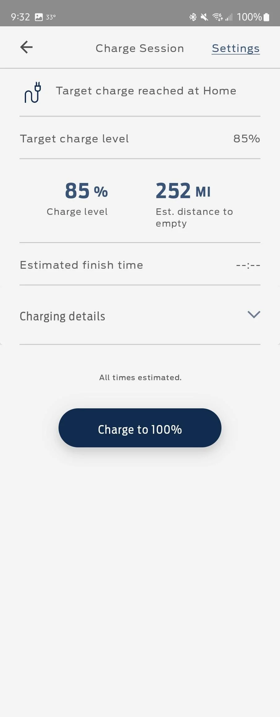

On my home charger (Grizzl-E) I have set preferred charge time based on my power providers best rates (11pm - 7am). So usually I plug in and it starts charging at 11 pm. Normally that is fine, but if I get home at 5 and want to top off to run some errands at 7pm, is there a way to to tell the truck to charge now (at 5pm) and not wait until 11 without turning off the preferred charging times? This would be a rare thing for me so I don't want to have to go in and change the settings every time.
For clarity, did you set up your preferred time in the FordPass app, or somehow through your Grizzl-E?
If through FordPass, after plugging in you can open the app, click on the "Waiting to Charge" notification at the bottom of the screen (mine below says "Charge Complete" since I charged overnight) and then there is a "Charge to 100%" button. If you hit it, it changes to "Resume schedule" and you could click it again when you have enough juice.
I don't know of a way to just charge on demand to your preferred max.
Hmmm... I haven't tried that yet. It might work. Will let you know. Thanks for the idea.
Just to close the loop - it worked as advertised. I plugged in at about 4:30 PM and the Ford Pass app showed that it would start charging at 11PM. I pressed the charge to 100% button and it immediately began charging. I let it charge for a while, and since I wasn't actually going anywhere that evening, pressed the "Stop Charging Button". The charging stopped and the button on the Ford Pass app changed to "Resume Schedule". I pressed Resume Schedule and the truck proceeded to charge at 11PM as normal. Thanks for the help @TheWoo
