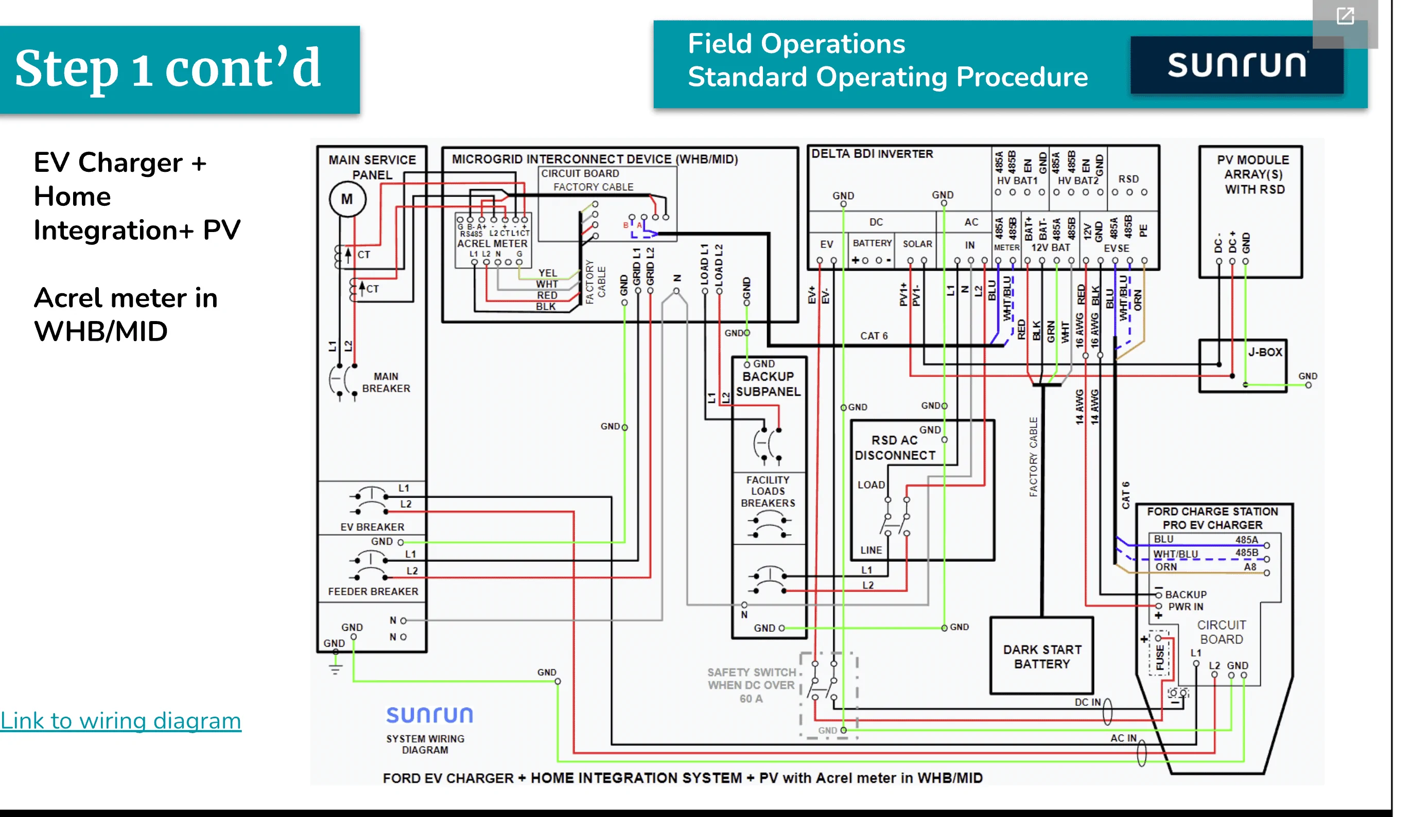

Also, here is a link to what Sunrun calls their “Ford EV Field Website”
https://sites.google.com/sunrun.com/sop/sops/ev-chargers/ford-ev-charger?authuser=0
its essentially a training website for installers and was very helpful, it allowed me to access some of the documents that Tofan posted in the replies above.
Again, if you don’t mind to explain how and why the critical loads panel is not necessary, I would greatly appreciate it, and also provide detail as to how you wire the system without the critical loads panel as it is located in FORD’s detailed wiring diagram I also linked between the transfer switch and the AC disconnect, which then connects to the Inverter.

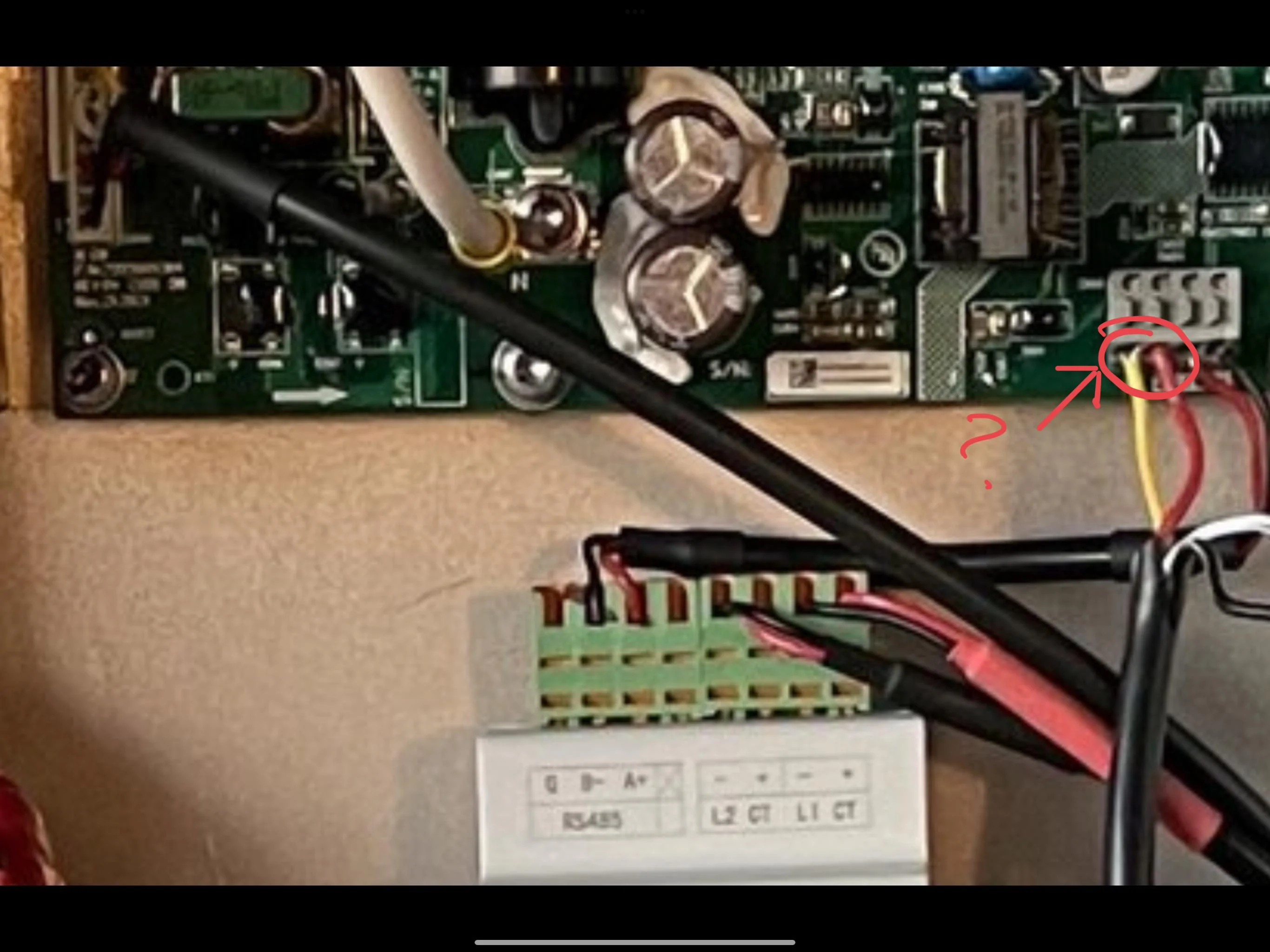

The AGF-AE-D/200 meter has a flashing yellow for the RUN. This is a communication failure.
I have good continuity on the coms.

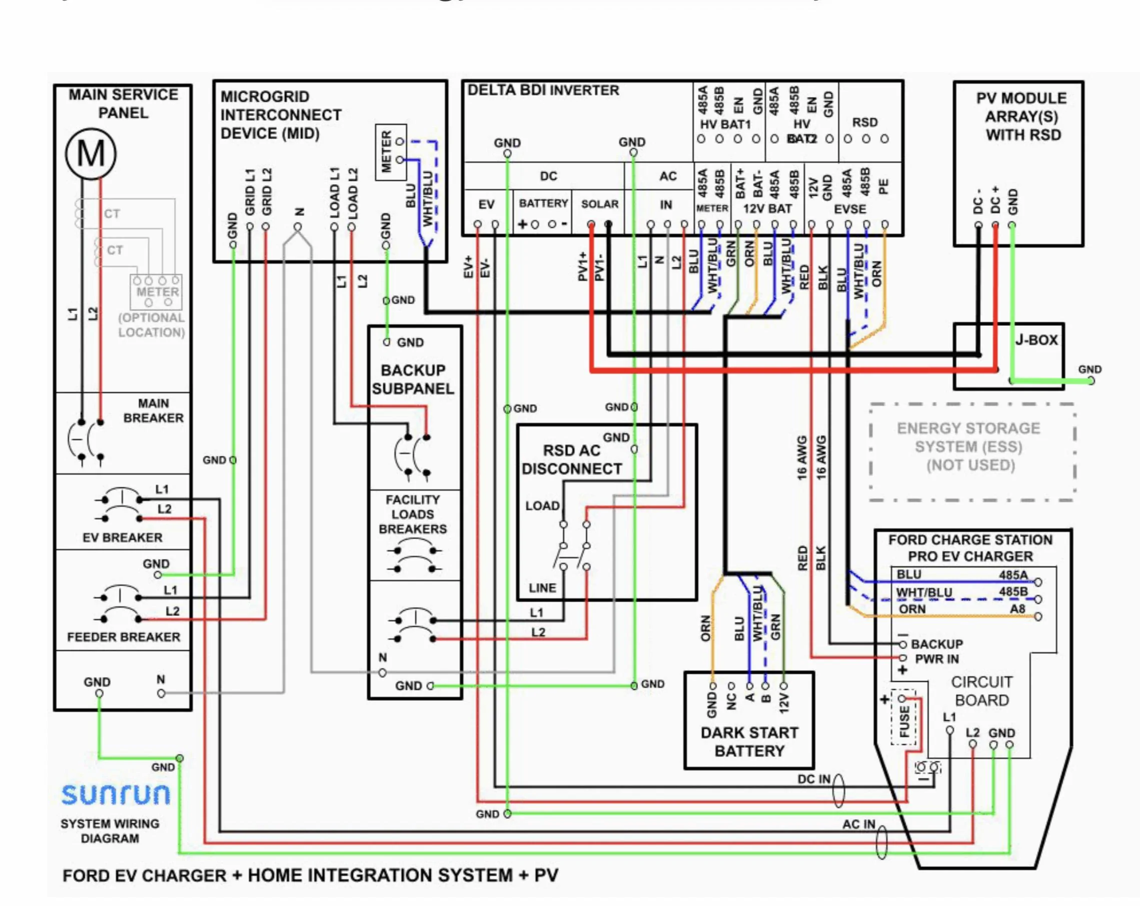

I would double check the connections I marked in the photo, I'm not familiar with what the red arrow is pointing to and in most of the documents I've seen that provide instructions on how to install this stuff as well as the training materials from SunRun, these particular communication connections were not referenced during the install process. Could be causing the error possibly.
Ford F-150 Lightning Charge Station Pro and Home Integration System self-install IMG_1091
EDIT***
So after studying some other documents in the training module, it looks like the B-A+ RS485 on the acrel meter has a factory wire that connects it to the circuit board and so that means the Yellow and red wire I have circled are the wires running to the inverter and so it seems like everything is correct in that area. Confusing when the videos in the training show RS485 B-/A+ connections going directly from the Acrel meter to the inverter. As I said in another post, we have not started the wiring process yet so I haven't look inside of the MID to see this "factory cable".
See the wiring diagram to see the reference to the "factor cable"
Ford F-150 Lightning Charge Station Pro and Home Integration System self-install diagram
