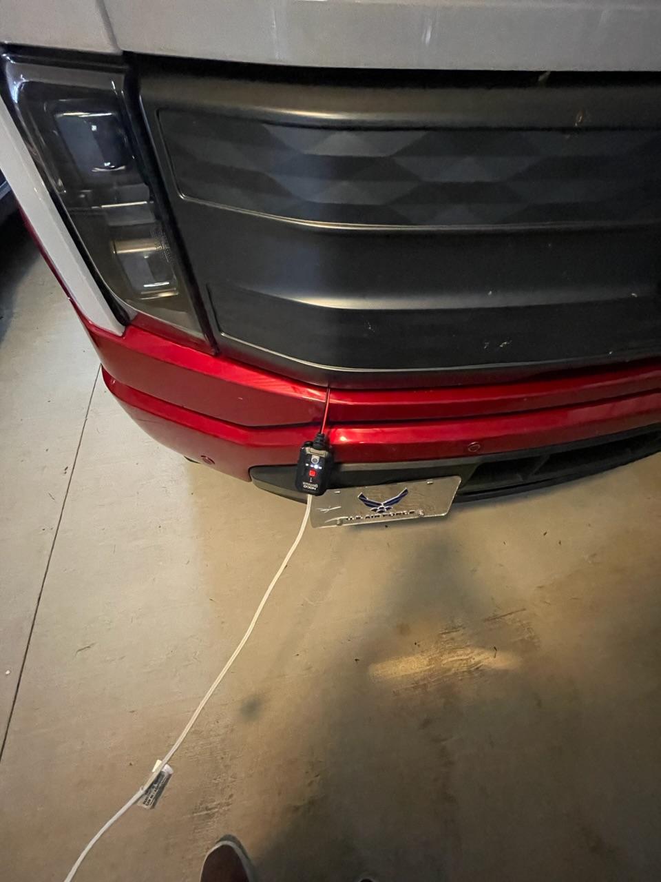

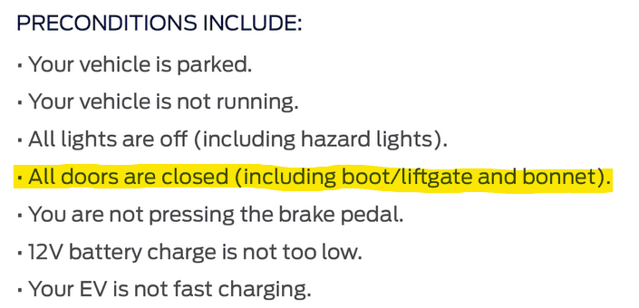

On a side, related note, is there a way to partially close the Frunk? I have an extension cord running in to power the NOCO. Ideally I'd like to partially close it to keep the weather/leaves out. But given all the posts I've seen about Frunk issues with manual closures, I'm reluctant to try.
I closed the frunk on top of the charge cord. There is a gasket there that cushions the gap. It did not damage the cord. If you connect to the jump points, that is outside the frunk gasketed opening and the gap is different i.e., check for clearance.
I was concerned that keeping the frunk open, even partially, would keep an inhibit update from occurring. According to the update instructions:
Ford F-150 Lightning Charging 12V Battery 1698289681112
I had to Google it but boot = trunk and bonnet = hood. So it appears frunk needs to be closed. Would be great if someone tested this.

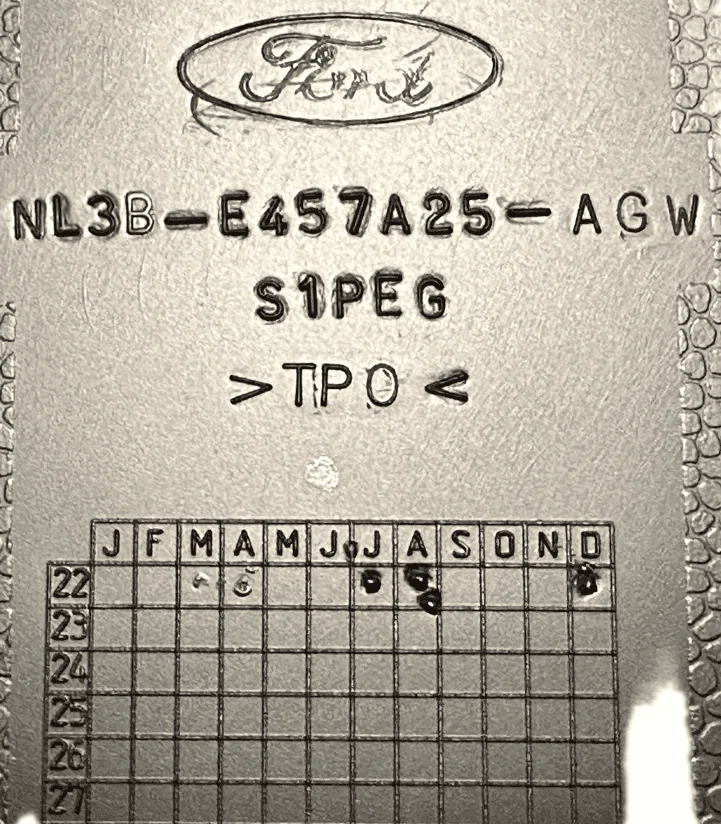

As I was trickle charging my 12-volt battery the way Bruce suggested in his OP post, I noticed the back of the front cover had a typical calendar date system embossed in the plastic, as typically found for dating battery installs (but more usually found on the battery itself to avoid switcheroos). I didn't see any dating on the visible part of the battery through the opening in the back of the frunk. Also, the possible years of date use only run to 2027. Seems more likely to be a dating system for frunk construction, with the 2027 year being the maximum possible use of that frunk design or the current Lightning design. The other funky thing is several months in the calendar are "checked off."
Does anybody have any idea what the calendar date system is for on the inside of the frunk 12-volt battery cover? For reference, my truck was originally scheduled to be built in February 2023, so that might correspond with the last date marked on the frunk cover calendar being December 2022. (somehow, my iPhone turned the dark plastic into a golden plastic. So much for true color rendition on the iPhone with lighting from 2700K "amber" LED light bulbs).

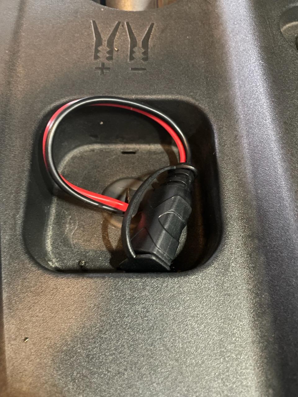

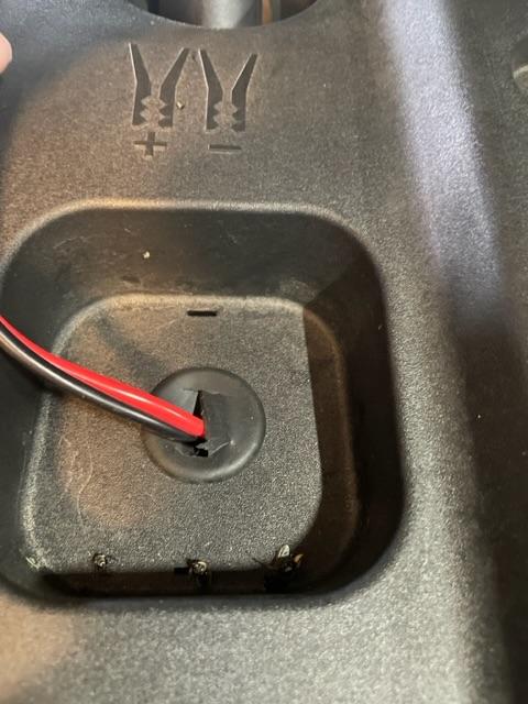

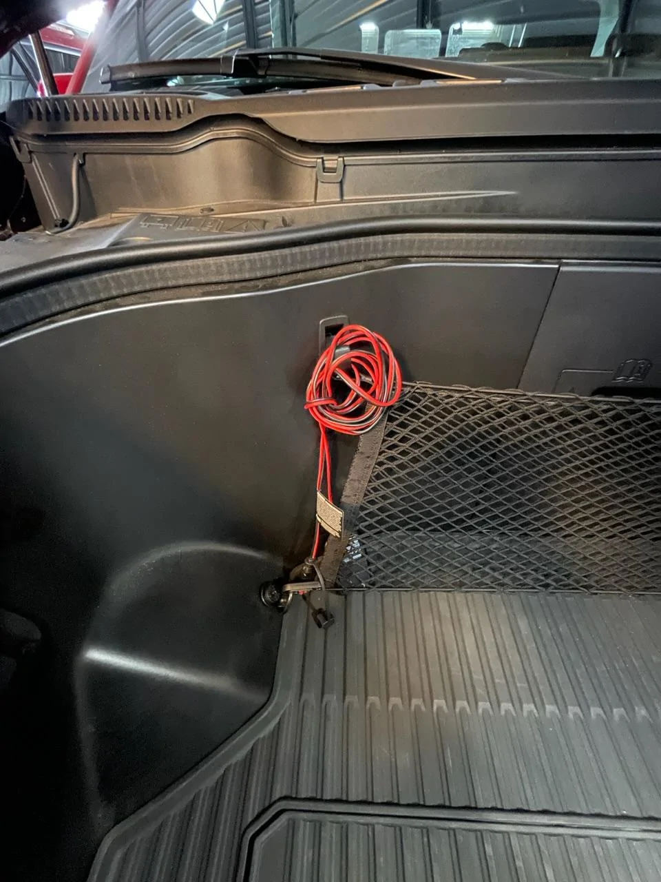

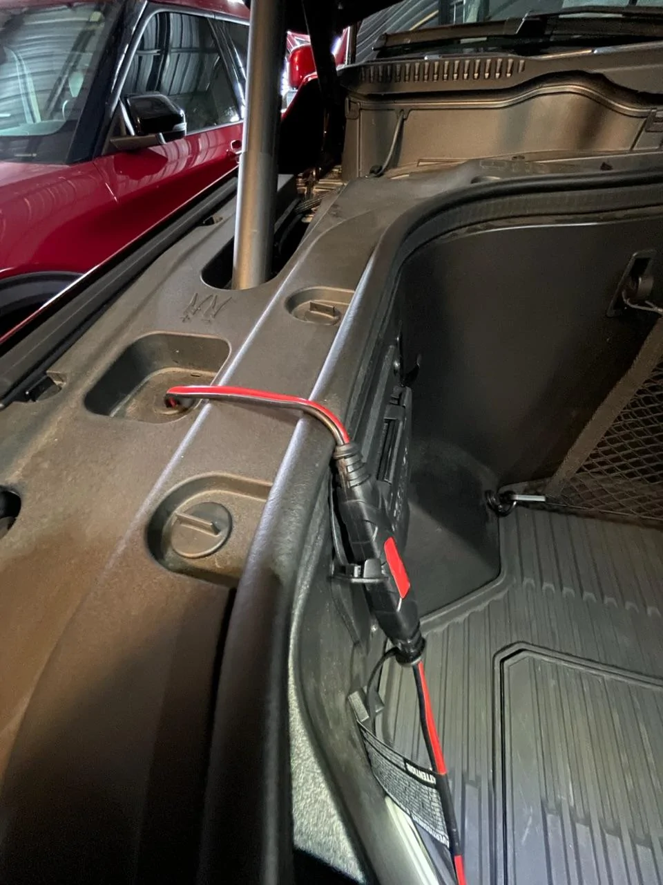

I have put a series of pics together to demonstrate how I installed my trickle charger so as not have to remove the frunk side panel every time.
The main feature is the grommet I installed in the panel. It must be large enough to allow the connector pass through it. (I’m my case it was 3/4”)
After that it is just a matter of connecting the charger to this midline connector and plugging it in. (No more removing the cover.)
I keep the charger stored in the frunk so it always handy.

Hi, what is the advantage of hooking the tender up at the jump points, as you show, as opposed to putting a similar grommet in the LVB compartment cover, and hooking up the neg terminal downstream of the BMS sensor? Or is it just a personal preference? Thank you for the info. https://www.f150lightningforum.com/forum/threads/charging-12v-battery.16979/#post-342220

I have used a trickle charger on my Lightning several times without resetting the BMS with success each time in terms of getting the updates to load.
And yes I have always used the jumper points to do so. As a matter fact I have actually modified the side fender panel to allow the trickle charger leads to remain attached and all I have to do is connect the charger and plug it in. No more pulling all this fragile turn clips.
Good luck.
Any pictures of how you contacted them to the battery and where the charge leads come out at?
