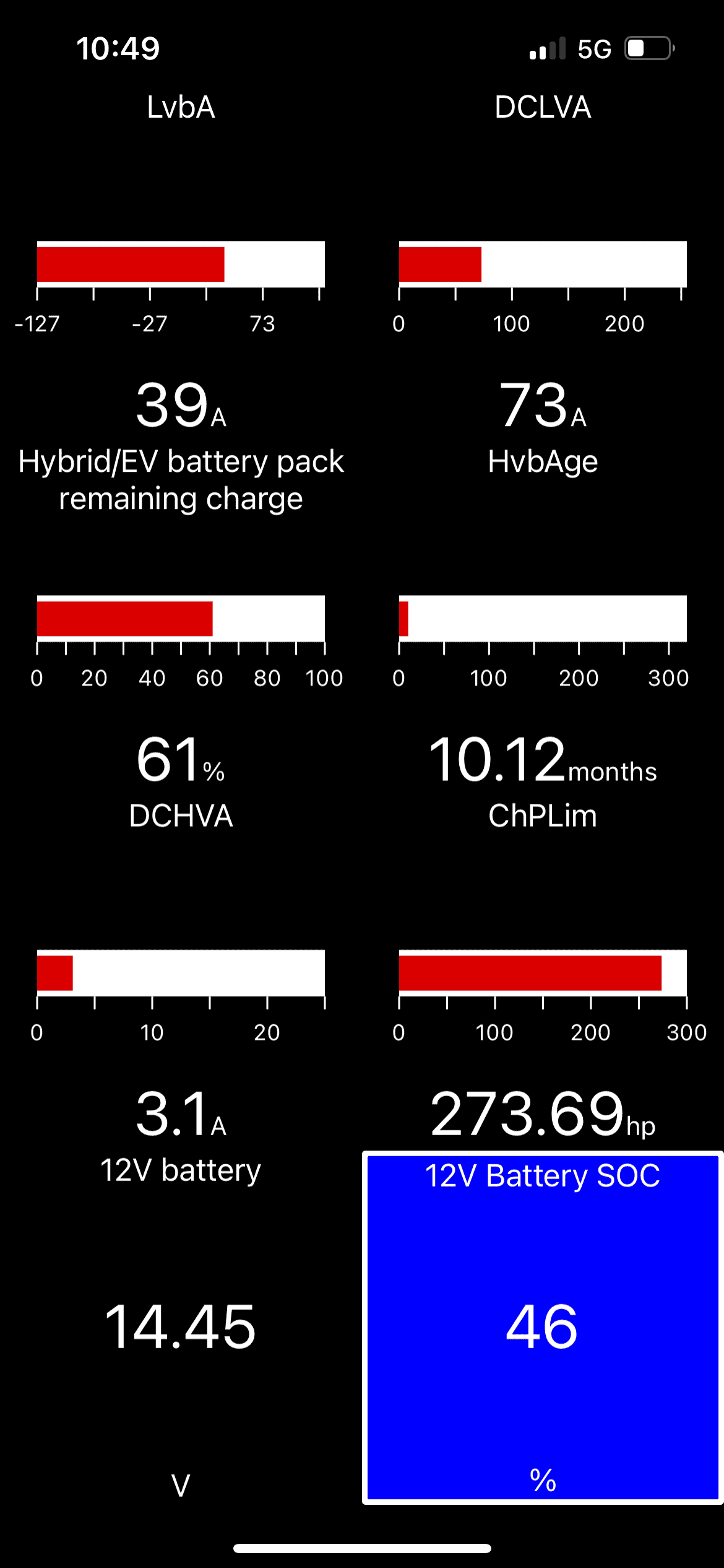

Check out the very top of page 4 for a good explanation of when and how the 12V battery gets recharged when you're NOT driving and just plugged in at home. Also, I've seen 12V battery SOC at around 50% first thing in the morning on multiple occasions, and I don't have aftermarket gadgets of any kind attached. You gotta remember that this 12V battery is only 35AH. That's it. It doesn't take much to drain it in short order.
