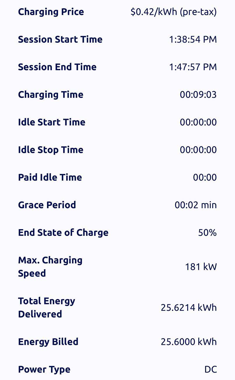

My fastest is 192kW peak. I think it mostly comes down to state of charge at plug in and battery temperature.
