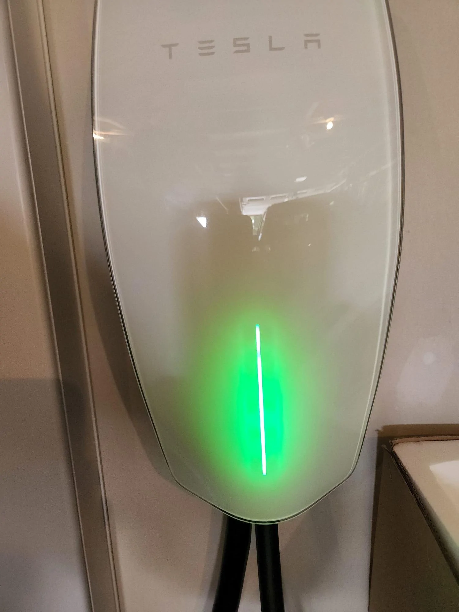

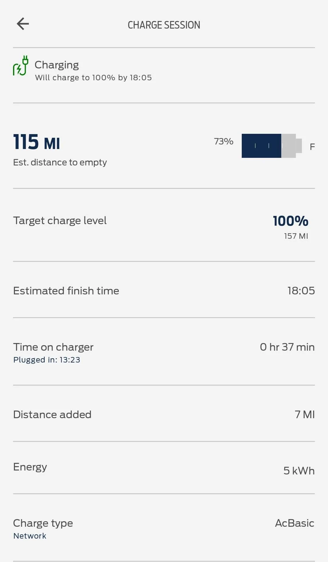

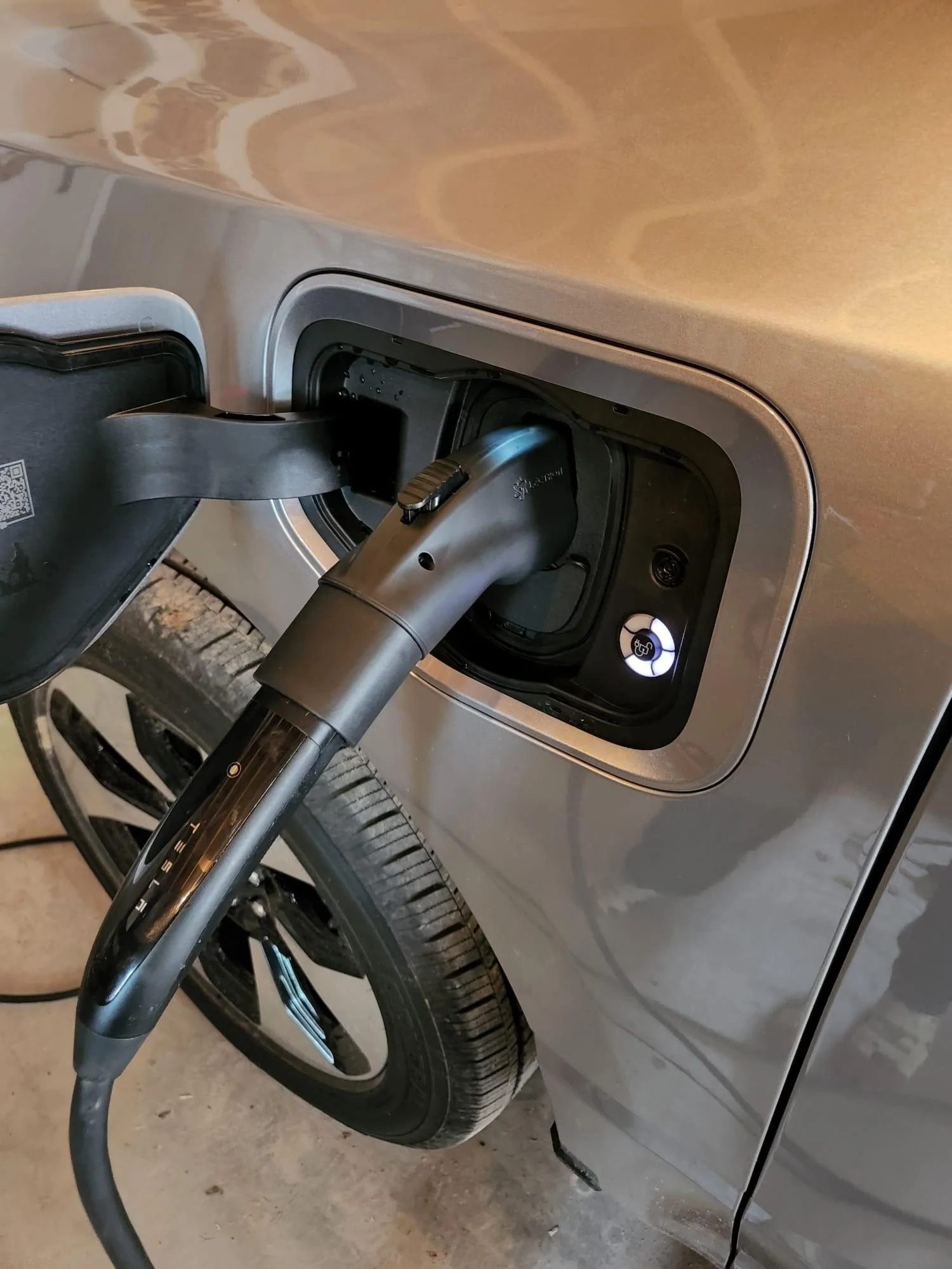

It works! This charger is plugged into a NEMA 14-50 (backed by a 50amp breaker) and is faster than the 110v (20amp) it would be plugged into otherwise. You need to make sure that your tesla wall charger is not locked to Tesla-only.
NOTE: This doesn't work with Tesla SuperChargers - only destination and resi chargers.
This is the model I am using: https://ev-lectron.com/collections/...tination-chargers-and-mobile-connectors-black

That is fine if you are using it on a portable or personal Wall Connector where you can control the amperage setting.
If you are going to use that on a Destination charger you should verify that the Destination charger is not putting out more than the adapter is rated at X 80% if you are going to charge for more than 3 hours.
I have seen too many users use those imported adapters on destination chargers with high outputs and overheat the adapter and the plug in the side of the Lightning. Using an underrated adapter is not worth the possible damage and who knows how long it would take to get a replacement charging port for a Lightning..
