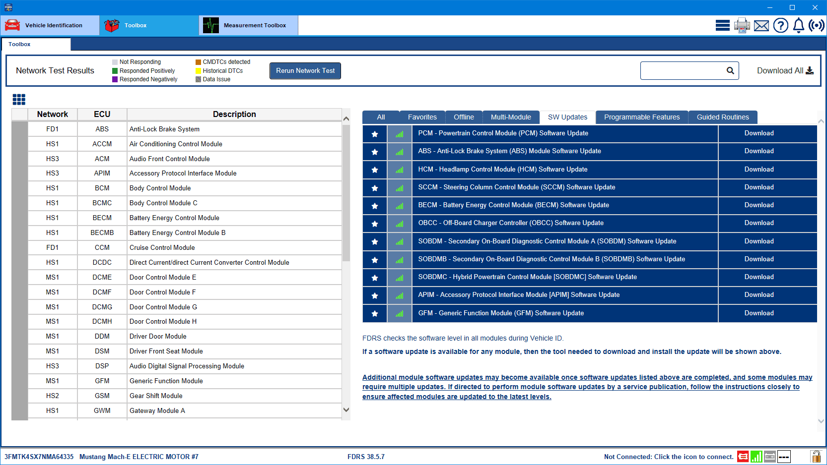

You can certainly take it in for CSP 23B50, but it has shown up for many people as PowerUp (OTA) 6.6.0.
OTA 6.6.0 updates all the powertrain items in this list:
So after the update the PCM, ABS, BECM, SOBDM, SOBDMB, and SOBDMC would drop off the list.

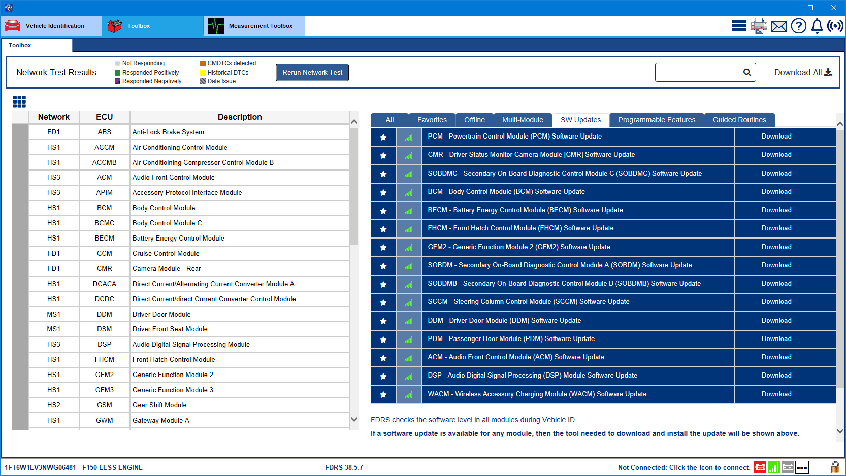

Mike, I just updated to the 6.2.0 redeployment (23-PU1103-NAT-VCE). Please let me know how I look.
1FT6W1EV3NWG06481
Thank you.

Here's what it looks like this morning:
Ford F-150 Lightning Checking for updates with FDRS 1FT6W1EV3NWG06481-7-Dec-23

There is the PowerUp list that is community maintained that provides clues as to what OTA equates to what FDRS module update. You sort of have to follow along with the progression to note what appears in FDRS and what folks are getting at the same time as an OTA.

Thank you. Now I just need to find someone in NJ that can update these for me since I don't have the hardware or software to do so.

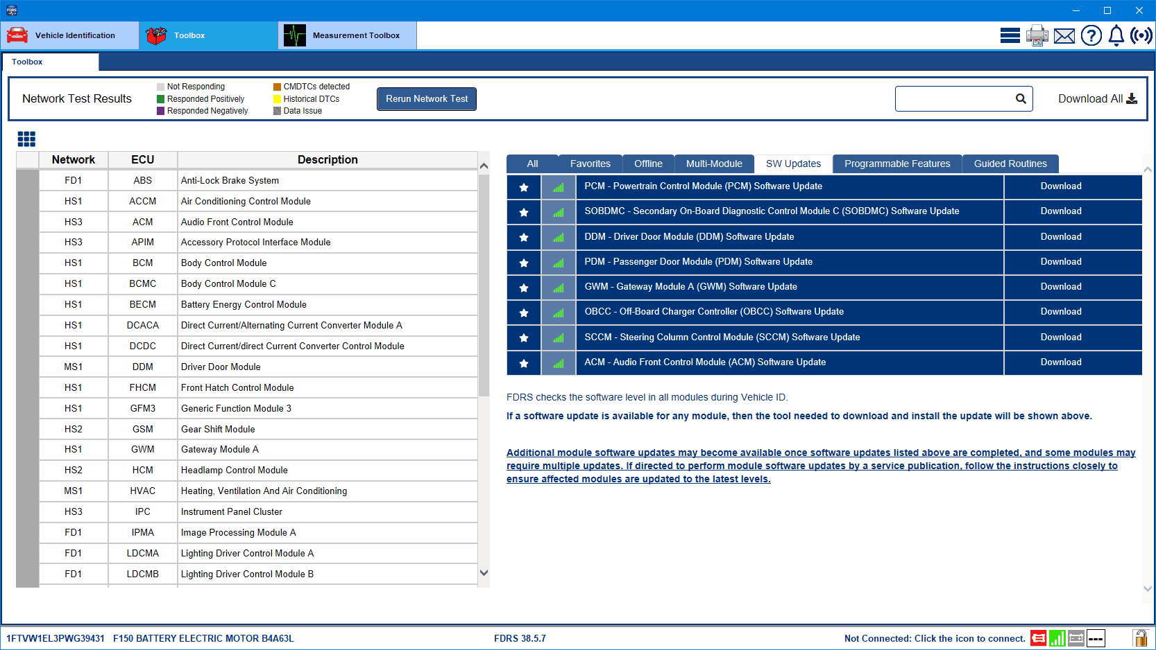

Hi - would someone be willing to check my VIN? Thanks!! 1FT6W1EV4PWG01972
