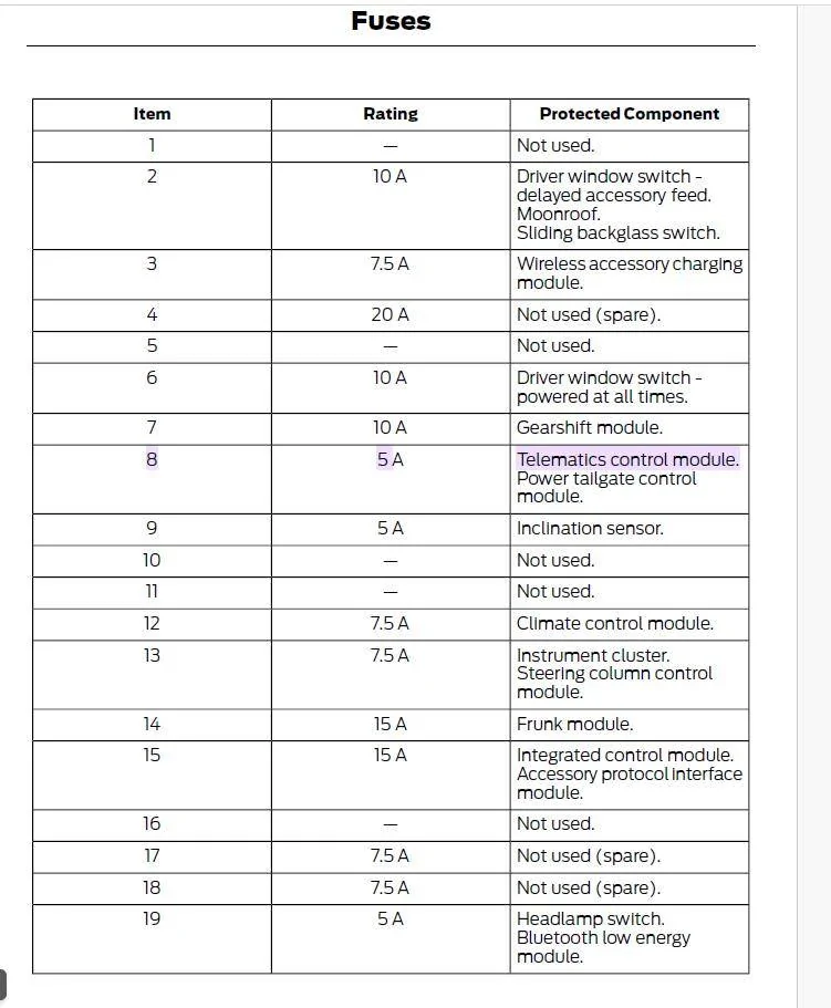

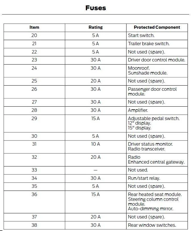

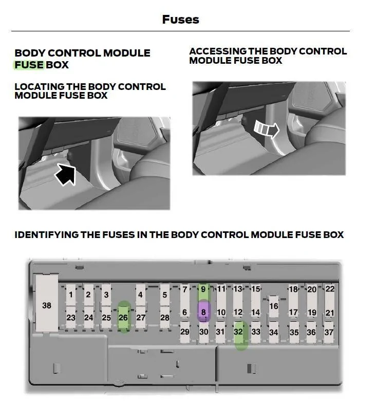

Updated chart, so the 8/9 ... and so on are covering multiple systems on the one large fuse.

So after pulling fuse 32 and going on one trip of about 2 miles, the modem was locked up again when re-starting the truck. Interestingly enough during that time I received the karaoke 10.1.0 OTA.
I believe this is why I say that fuse 32 is not a reliable solution though. I believe there is something else going on that the fuse just doesn't take care of. I have gone ahead and pulled all 3 connectors off the modem for about a minute. The next time I will pull both fuse 8/9 and 32 at the same time and see what happens. If that doesn't fix it, then I will pull the whole battery terminal, as I should be up to date on software after the 10.1.1 update.

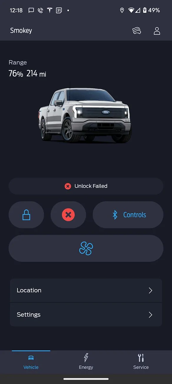

Welp, not sure where I am now. I woke up this morning to receiving the 10.1.0 update for Karaoke and Public Charging, but now I can't operate the vehicle from FordPass. Lock, Unlock, and enable HVAC all fail, but it seems to know where it is and reflects the correct-ish SOC. Other connectivity features in the vehicle work (Alexa, Charging Stations, etc).

What you are describing are Bluetooth issues and have nothing to do with the modem issues we have discussed. I would turn off Bluetooth on your phone and back on.
I can say for sure the mechanism is different because I can have none of the connectivity working but the app still works for lock/unlock etc if I am within Bluetooth range.

This is not a Bluetooth issue. If I am standing within site of the vehicle, I can operate all of these features. I'm in my office and the vehicle is parked the the parking garage 2 blocks away, it is using the internet and its modem. I use the HVAC feature most days to cool the vehicle before I get to it and now it's not working.

I've been trying the remote connectivity for 2 days for Lock/Unlock/HVAC and no go. Everything else has been working though. Connected Nav, Alexa, Charging Stations, Location, and reflecting correct-ish SOC.
So, I went ahead and unplugged the modem and plugged it back in.
Bingo, remote features started working again.
It seems to be yet another failure mode. Not being able to start my HVAC is a minor inconvenience in the grand scheme of things, but it's still something I'd like working as advertised in my brand new $80,000 truck.
