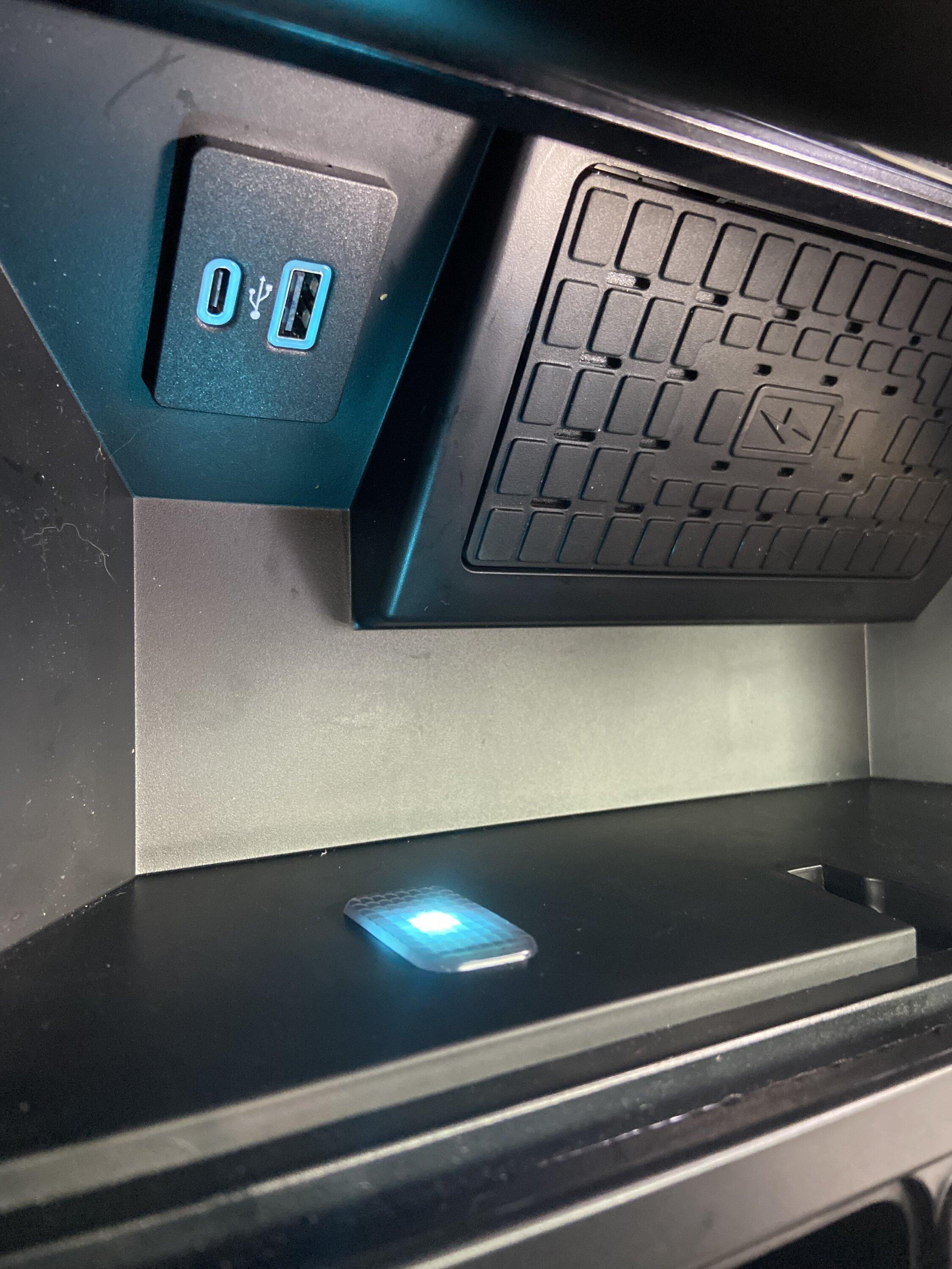

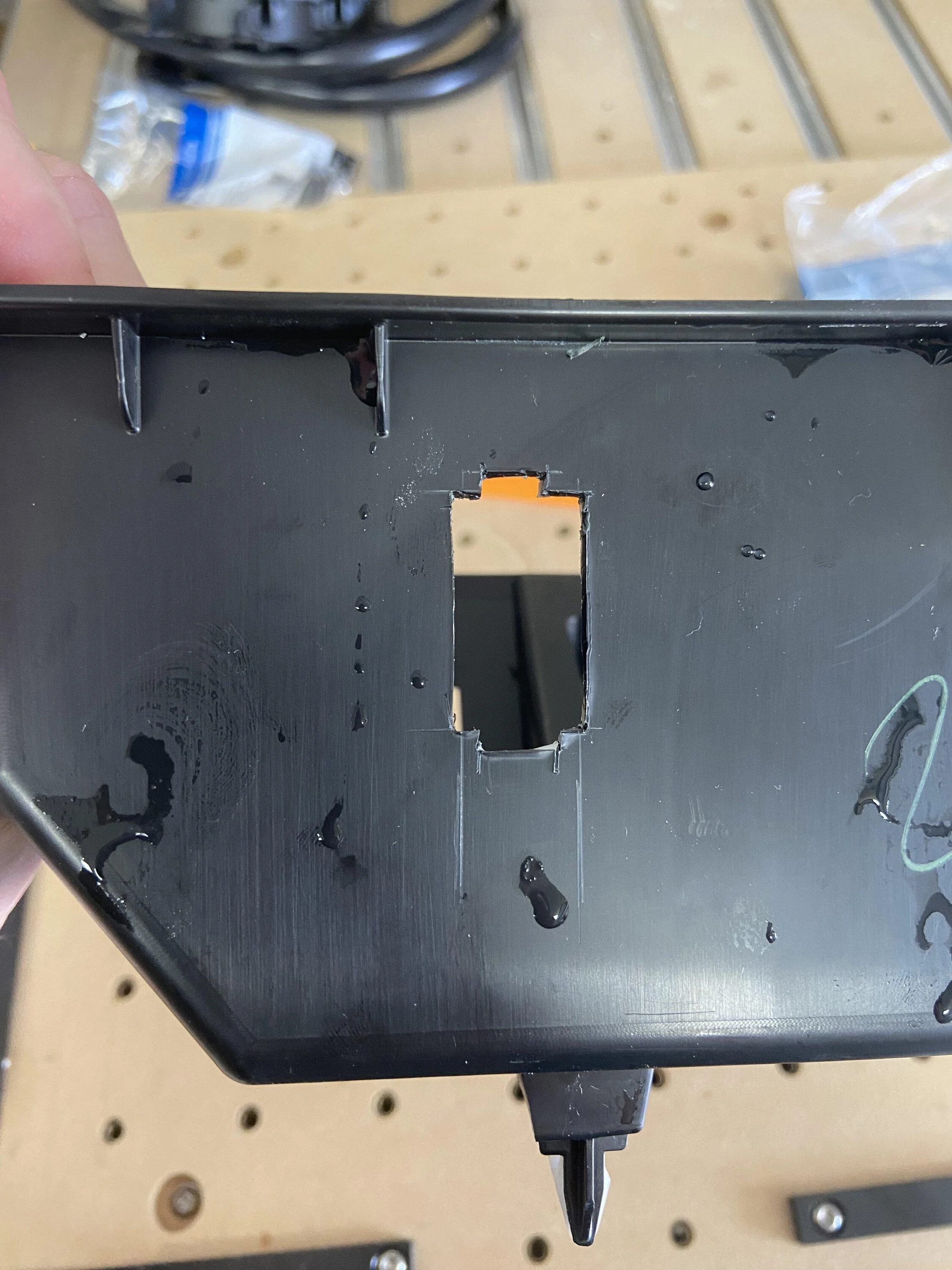

Just finished the install! Great thread and I really like the end result.
Only small issue I had is I ordered the Media Bin ML3Z-1513594-BA, and I'm not sure if I ordered the wrong part, but the mounting for the wireless charging pad is different on my 2023 Lightning. Because I had no way to transfer the wireless charging pad, I ended up reusing my existing media bin and transferring the light hole dimensions with calipers and using a fresh razor blade was able to cut it clean and accurate enough that the light popped right in and installed cleanly. I wish I remembered to take a picture of the two media bins side by side.

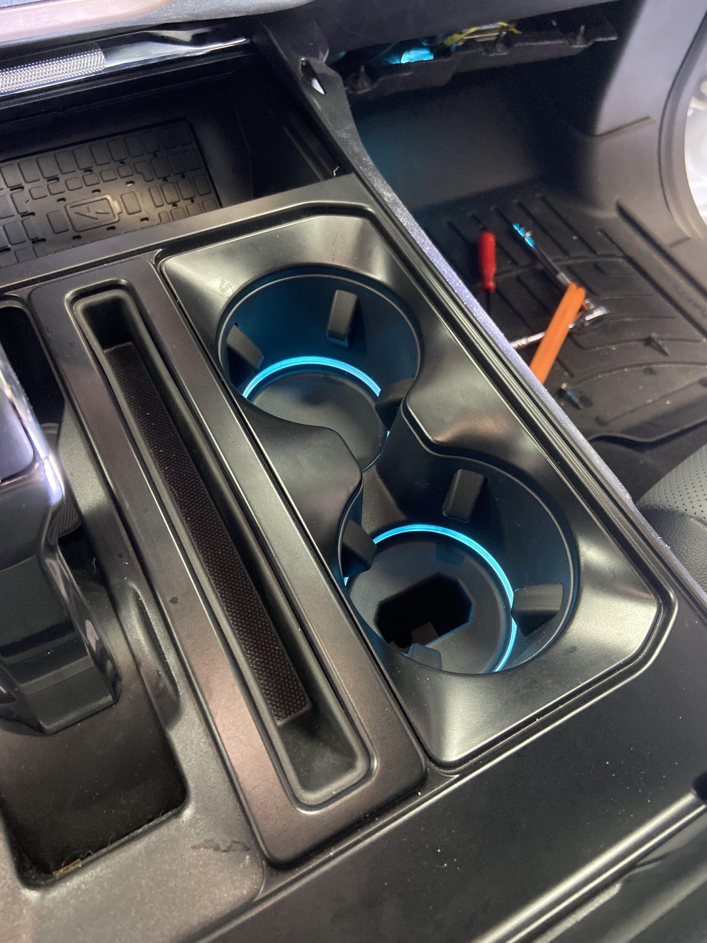

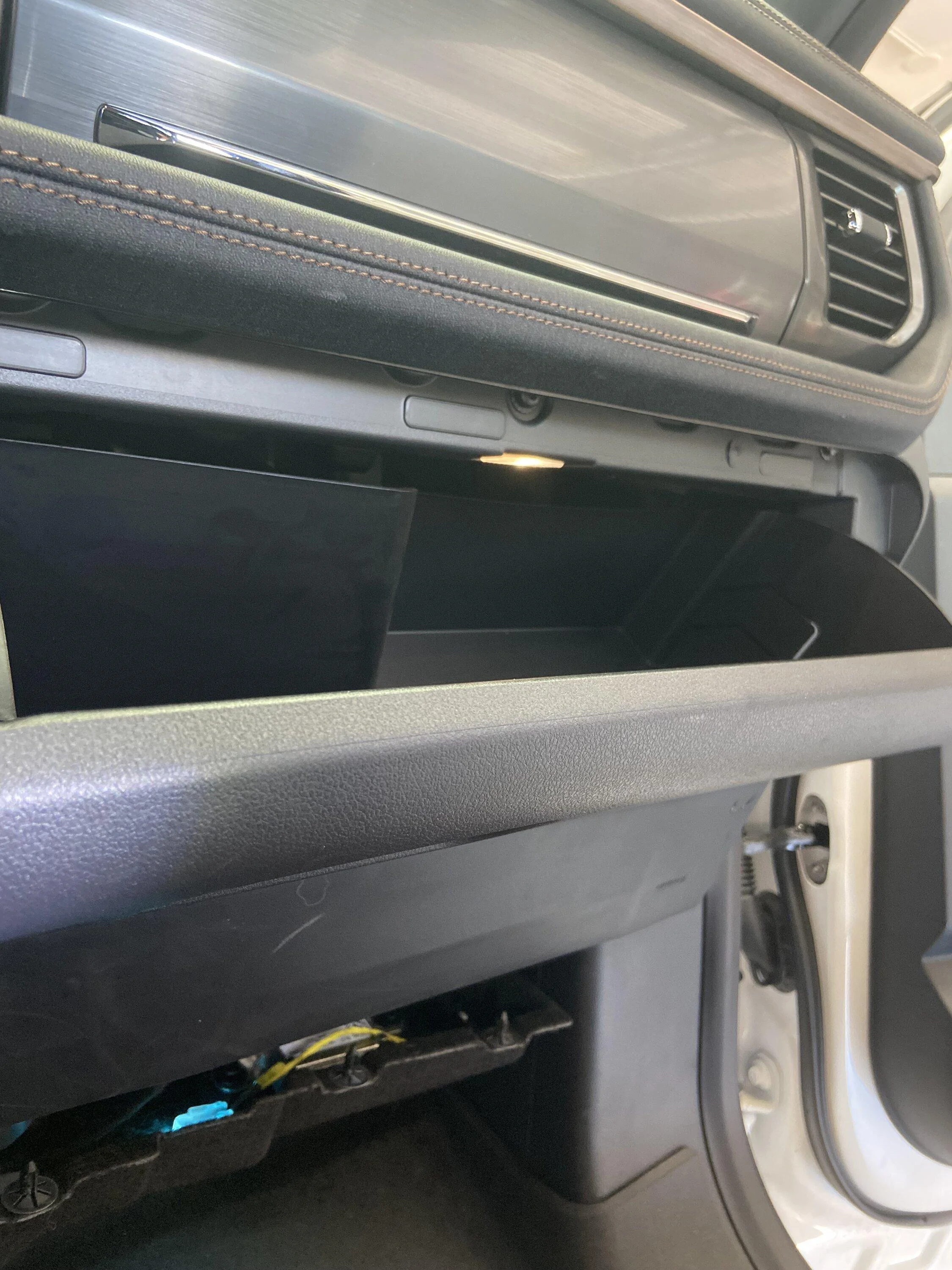

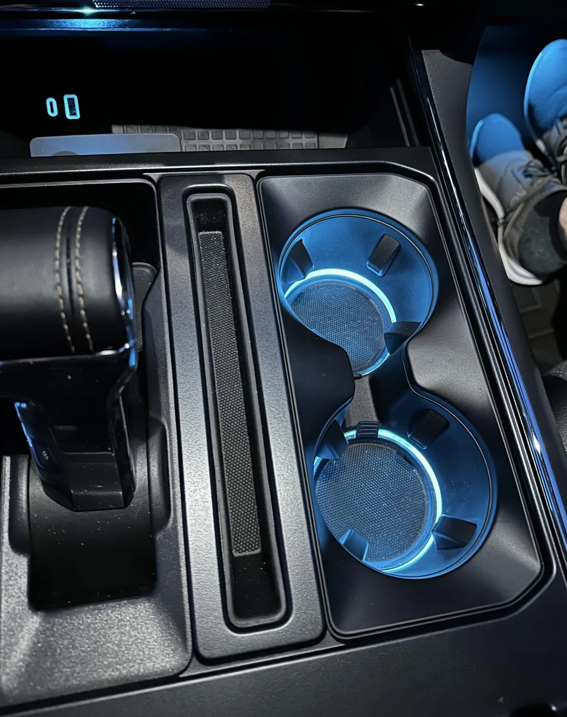

I finally am getting to this….
The single plug from the foot well ambient harness goes back to the cup holder light plug.
“run the harness that now has a T in it to the ambient light in the foot well”
The 4 plug harness taps into center console light then short end feeds media light and long end feeds glove box light.
So both long harnesses go to center console.

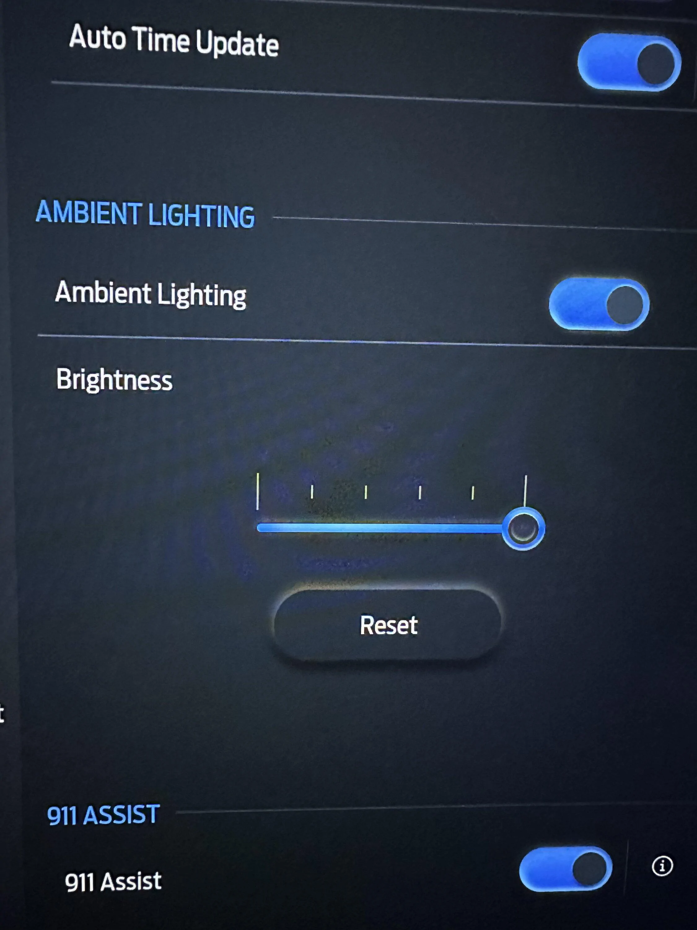

Initially the cup holders only lit when I shut truck off and/or got out.
I tried adjusting ambient lights I initially could only get cup holders to light when I shut truck off.
See next post after I figured it out….
Mujenpwr
Feb 19, 2023
NJ
2022 Lightning ER
I figured it out LOL. Ambient Lightning was off in touchscreen.….

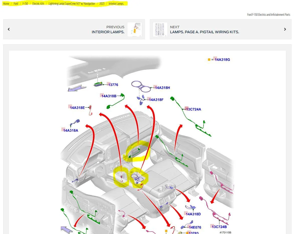

Thanks for being generous with the information, and willing to take a hit to those of us in the Great White North.

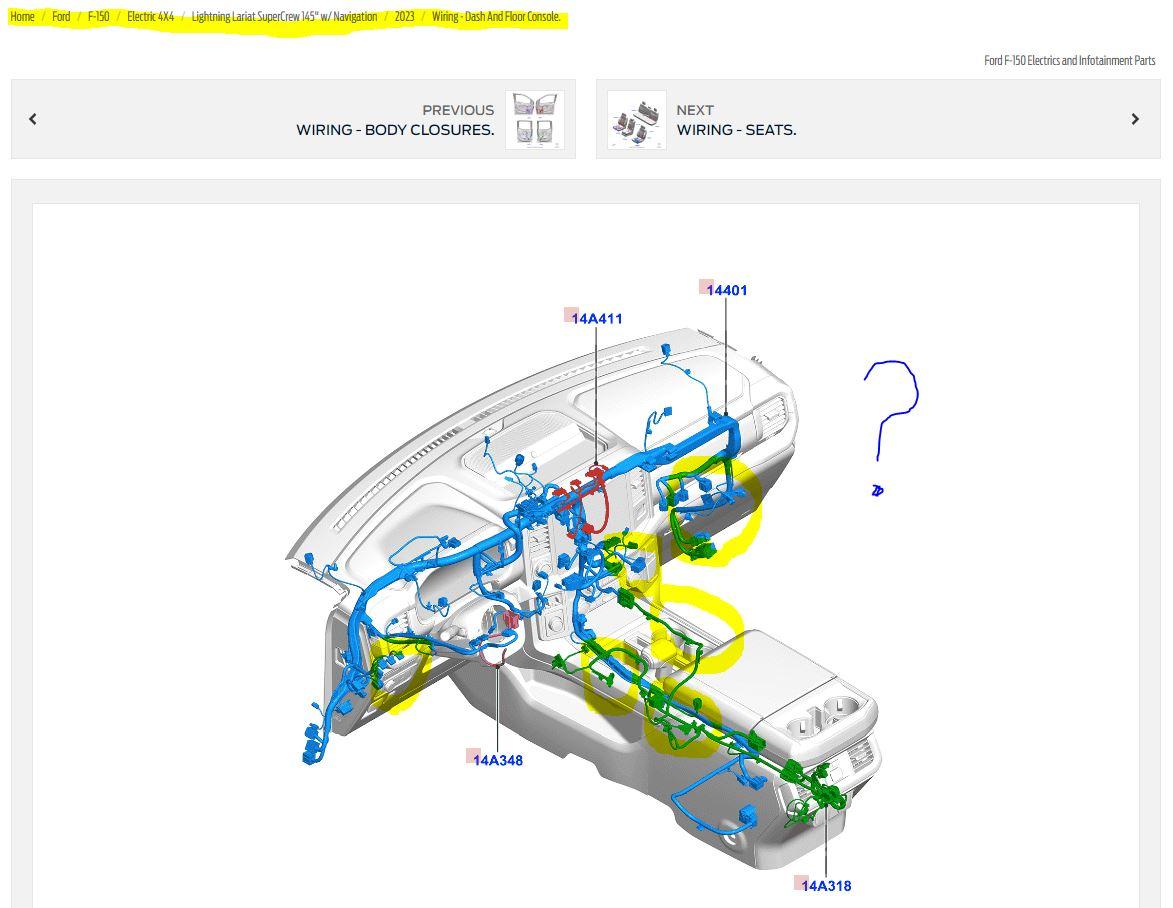

I did look up those part numbers and I was able to Take the Molex/Mauser part number you gave and cross reference them to the Ford OEM Wiring harness.
For others that are interested
Electrical Connectors
Ford Part
14S411C - WPT1103 (Molex 31067-1070)
14S411P – WPT1182 (Molex 31067-1010)
There is also the 14S411J - WPT911 But this seems to be a mirrored flip of the plug required as far as I can tell.
Next Steps is to order the parts from Ford and see what I get and then consult the drawings for the pin identification. This also brings me to my next question. What part of the existing cabin lighting system are you tee-ing in to? The 2023 Lighting sheet shows all the lighting that's been deleted on the drawing for the 2023 F-150 Lightning. I have attached a picture. So the drawing for the associated wiring harness isn't going to reflect that actual locations of an available cabin lighting electrical connectors to tee in to. I have highlighted some potential spots. Three of these obviously don't exist.

you need to look at my 90 page post on the ICE forum, I’ve got good pictures telling you where everything goes.
