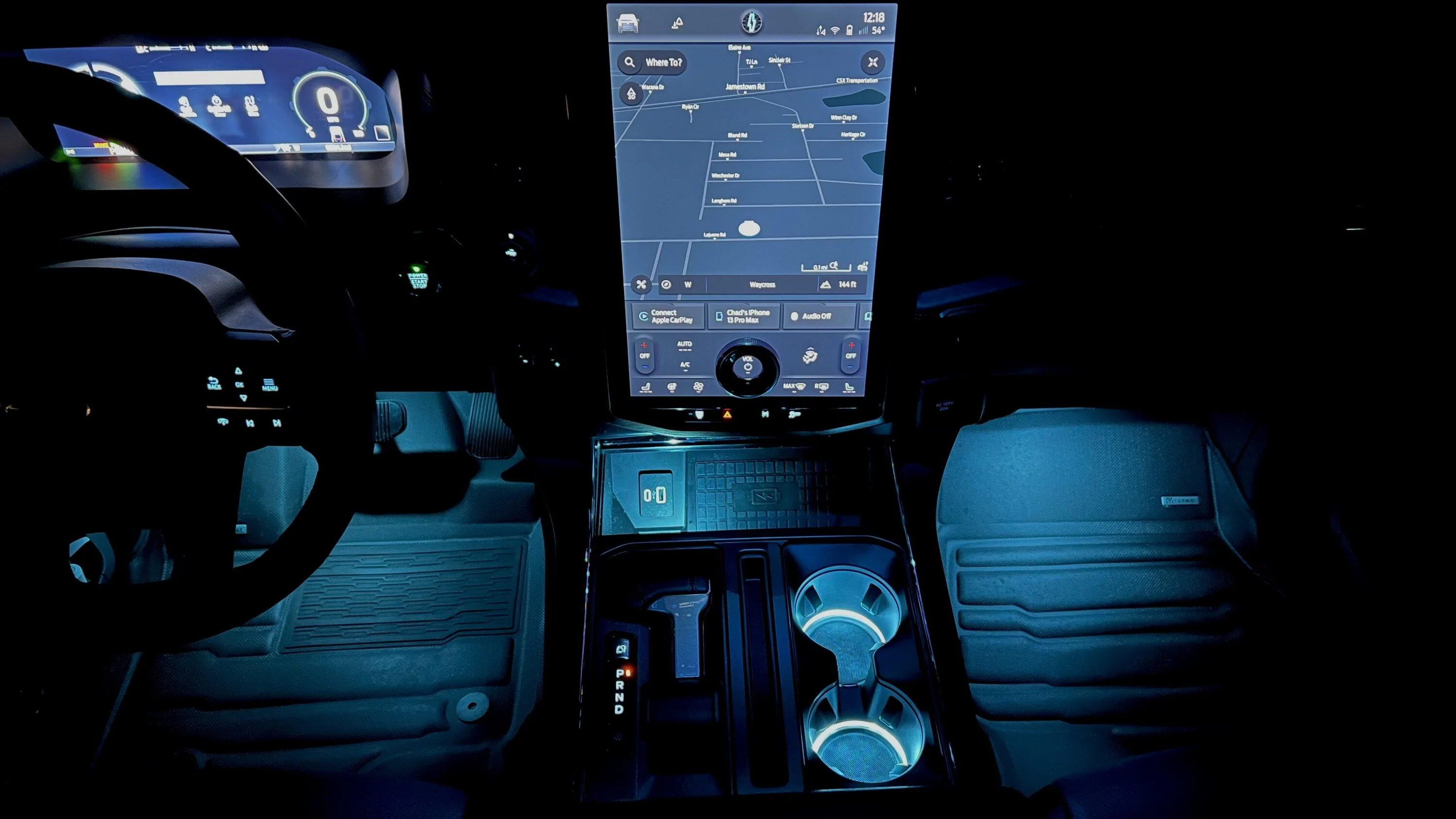

Ford F-150 Lightning Cup holder light installation/media bin light/glove box light IMG_4271
I really like how this turned out and was actually easier than I thought it would be. I don't if anyone has noticed from my previous posts, but I'm quite fond of this shade of blue :LOL: Thanks @JHForman812!
I purchased all the parts from lascoautoparts.com and had them within a week.

Looks great! And looking forward to working with @JHForman812 once I take delivery of my truck.
This may be a strange question, but are the lights for all of these mods always blue? I'm guessing they're not addressable and I haven't seen any options to order different colors.
47
3,064
4,374
Fixed color not addressable. The media bin and console are blue. Glove box is white. No option to change colors like the Mach-E or even my son's 2013 Escape.
