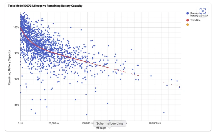

We should all hope the Ford Lightning battery does as well as the Tesla Model S batteries. This is an owner-self-reported study (I wonder what @MickeyAO thinks of the results-whether they're for real?).
Source: https://maartensteinbuch.com/2015/01/24/tesla-model-s-battery-degradation-data/
Ford F-150 Lightning Did my dealer inadvertently hurt my battery? 1676873340135
The owners' data is tabulated in the following Google Sheets spreadsheet with self-reporting of each owner's charging lifestyle.
Tesla Battery Survery - Google Sheets (text version of the link is:
The following seems a rather tempered summary of real-life experience with EVs and how best to treat your vehicle's battery to be one of the scatter points above the trendline instead of below it.
(the date of the article seems to be from about 2020, as the most ancient comments are 3 years old).
