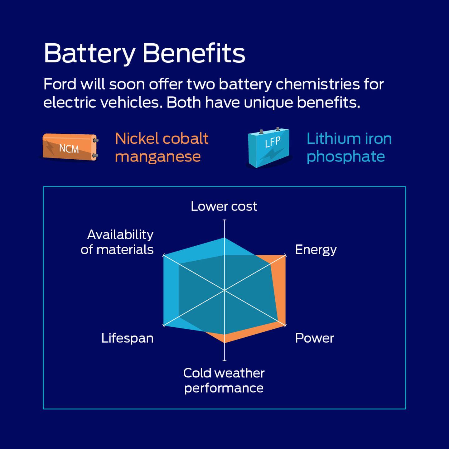

Perhaps the Tesla techs were thinking of lithium iron phosphate (LFP) batteries, which I've read that Tesla has switched to on standard models. An article today in The Verge explains the differences between lithium batteries with nickel, cobalt, and manganese (what the Lightning has now) and the LFP batteries that Ford plans to make at its new $3.5 billion plant in Michigan. A quote from the article ( Ford’s EVs are getting faster charging and more affordable batteries thanks to new chemistry - The Verge):
“They are exceptionally durable and they tolerate more frequent and faster DC fast charging,” Lisa Drake, vice president of EV industrialization at Ford model e, the company’s EV division, said during a briefing with reporters Monday. “And they actually perform best when they’re being charged from zero to 100 percent regularly. And that is ideal for customers who want to drive all the way to empty and then charge quickly back to 100 percent.”
There's a neat graphic in the article that illustrates the relative pluses and minuses of the two types of batteries.

For those interested in the graphic, but don't want to skim the article:
Ford F-150 Lightning Did my dealer inadvertently hurt my battery? LFP_vs._NCM_At_a_Glance
