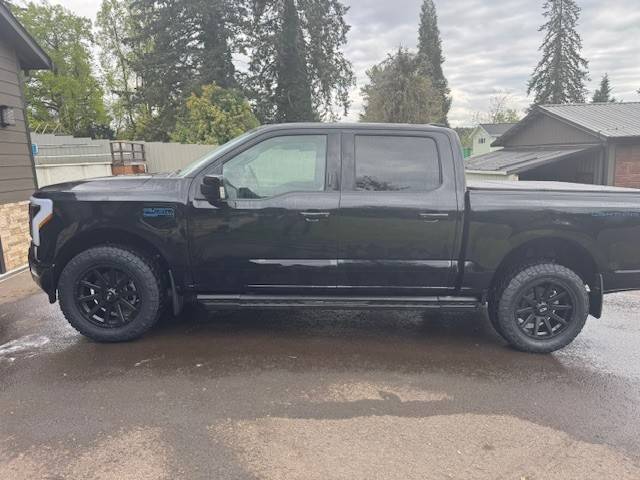

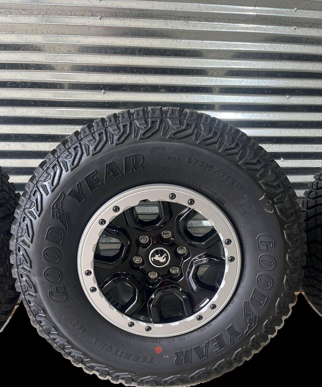

First the good news... Set of ION 143 20x9 on a set of Ridge Grapplers (Stock size). I wanted +18 offset but after they couldn't find a set decided to try to zero offset. As you all may know the stock rims where +45 Offset on 20x8.5 rims weighing 37 lbs. Wrapped in a set of Goodyear Wrangler Territory HT's weighing 39 lbs for a total of 76 lbs

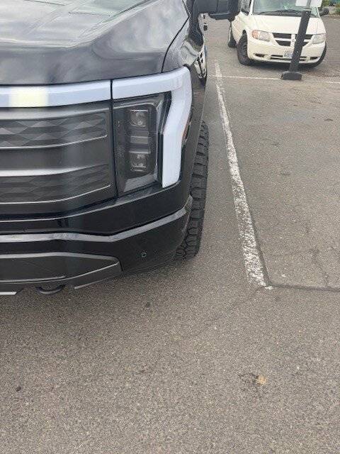

ION 143's weigh just 29 lbs and a set of Nitto Ridge Grapplers (Model 217630) in the 275/60R-20 size are 47.22 lbs so pretty much the same weight. I know I will lose some range due to rolling restance etc.... but now it looks like a truck. It also drives better. Poke is barely there, I can barely see the tread in my mirror.

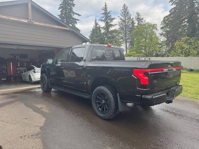

Some better pics
0 offset 20x9"

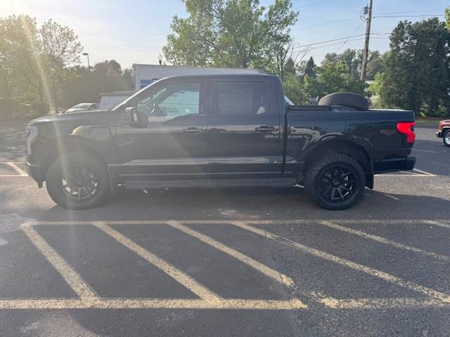

That rim/tyre combo looks pretty nice. I can’t help but think that you would have better ride quality and look even more like a truck with bigger sidewalls though. I know that I am probably in the minority because I am old (over 50), but I think a smaller wheel and taller sidewall looks the most “truck like”. The 20 inch wheels are as big as I would go, but if 17s were available stock, I would have gone smaller! The picture below is the same tyre you got, but the 265/70/17. They make a 285 that should fit… maybe I will try it since yours look so nice.
Yes, wonder if you can go with a smaller diameter rim on the Lightning, like the Bronco rim and tire?
The LT tire shown above is 54.48 lbs (vs 47.22 for the 20') but if you did the XL spec tire (Not the LT) it drops to 43.41 lbs.
I went with the same size as I didn't want to redo the speedo. The stock tire is rght at 33" and you'd have to go up to a 285 to get close to that (slightly under 32.76")
