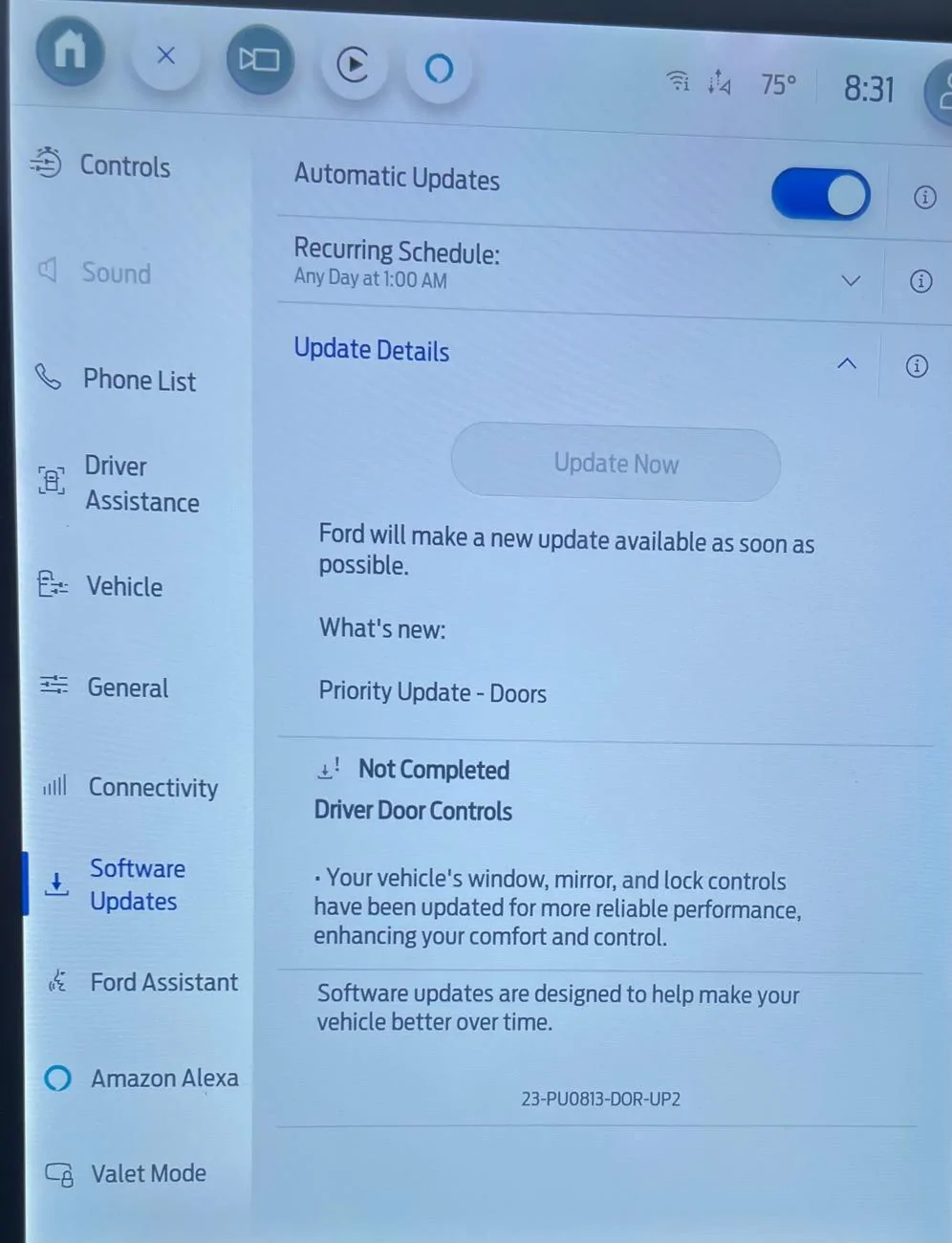

Sorry I can’t offer any help with your particular issue with this update. And not to pile on but, for more than a month now I’m stuck with the same update being “Not Completed”. My local Ford service department had my 2022 Lightning Lariat last week for five days and couldn’t advance the download. At the same time while the display states the update is ”Not Completed”, the center console display states ”Your vehicle window, mirror and lock controls have been updated for more reliable performance, enhancing your comfort and control.” I’m totally confused the contradiction and the lack of any explanation by Ford BEV as to how to clear the conflicting information. Also due to several reports of vehicles becoming bricked after installing this update I’ve elected to turn off the automatic update feature until the BEV team provides a workaround.
For a couple weeks I have had update troubles - keep getting an error message on FordPass that the update was "interrupted."
Not by me doing anything at 6:30am.
Mine is a "PowerUp" software update.
I see the HV battery warranty requires me to install these updates within a reasonable period of time (30 days).
"...failure to complete Ford Power-Up software updates within a
reasonable amount of time, typically 30 days.."
Truck is set for auto-updates, parked outside, doors closed and locked, not fast charging, lights are all off, all prerequisites are met.
I got one successfully in June - the 23B57 CSP software update.
I had the battery monitor sensor replaced - the 23B70 CSP.
No warnings about low voltage battery charge being too low.
Inscrutable.
