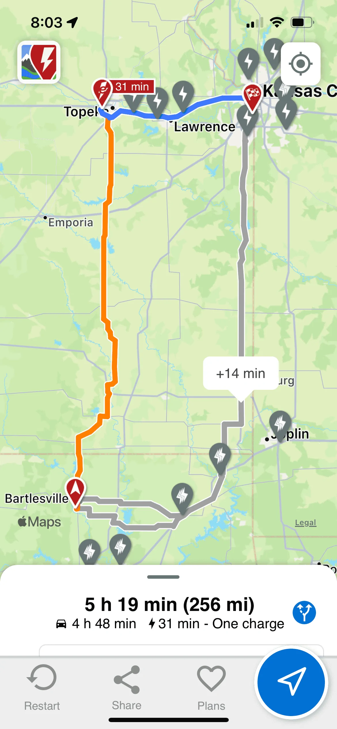

This coming weekend I’m heading to Kansas City with my SR XLT. 210 miles of no DC fast charging available. the preferred route is between the two ABRP routes shown.
Getting there shouldn’t be a problem with some conservative driving and 100% starting charge. Getting a full charge coming home could be a challenge.
In one of the ICE vehicles it is a 3:30 trip

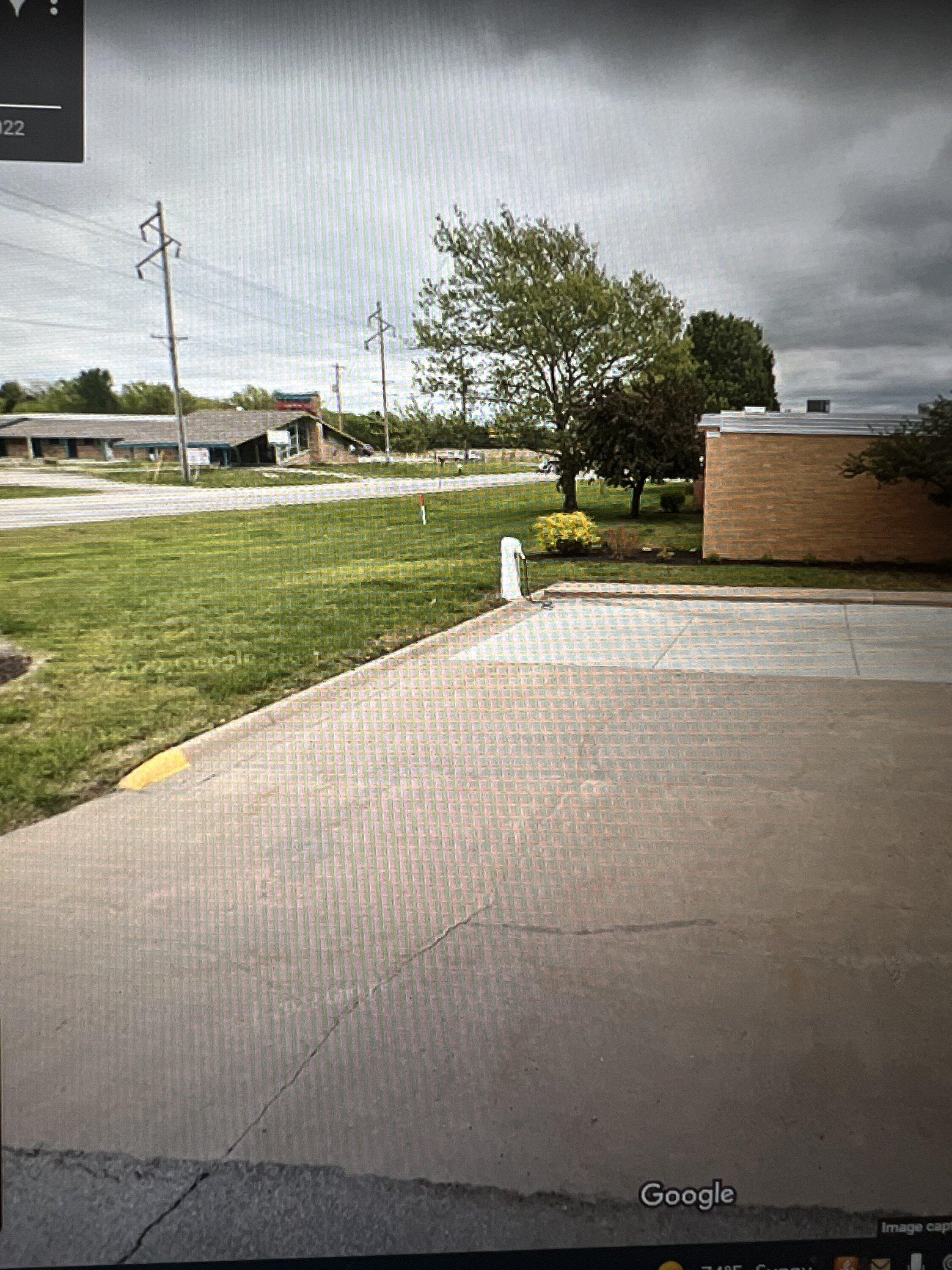

Finding several J1772 options that look like this.

Having done the route from Tulsa, OKC and Austin several times strongly urge that you go thru 44 and 49. ABRP is wrong on this one. The only other alternate is thru Wichita which is too long.
That way your biggest DCFC gap is 135 miles between Joplin and the new Harrisonville DCFC. There are lot more chargers on 44 and you will not have to think much on where to charge. Makes it so much easier all around.
Your risks are much higher on Highway 75 that something will go wrong esp. with an SR. The state highways are just not well connected.
I know you are thinking 210 mile range, but have you checked the wind direction when you plan to travel? IME you could easily find yourself well under 150 miles of range into a stiff Kansas headwind. Not to be underestimated.
Finally- When you do get to KC be aware none of 50 kw DCFC chargers that are there will work with the lightning as they are gen-1 CCS chargers. The EVgo, Chargepoint and EA stations work. I have tested most of them.
Just finished a weekend trip to the Lake of the Ozarks and had plenty of Electrify America options all of which charged at 160+ KWh on initial charging into my SR. I managed to average 2.1 miles per KWh with a majority of that at 76 mph on 44.
I think with conservative driving I won't have any issues (Hwy 169 is the preferred route). However if I do run into some headwinds then there are a bunch of 6KWh J1772 options along the way. I plan on checking two or three of the J1772 chargers on my way up (Independence, Chanute and Humboldt).
Even an hour spent at a J1772 would save me a bunch more time than travelling all the way to Joplin and Harrisonville. Most everything I'm doing in KC is on the Kansas side.
Have you used the EV Go charger at Oak Park Mall in Overland Park? I figure I'll re-charge there on arrival.
