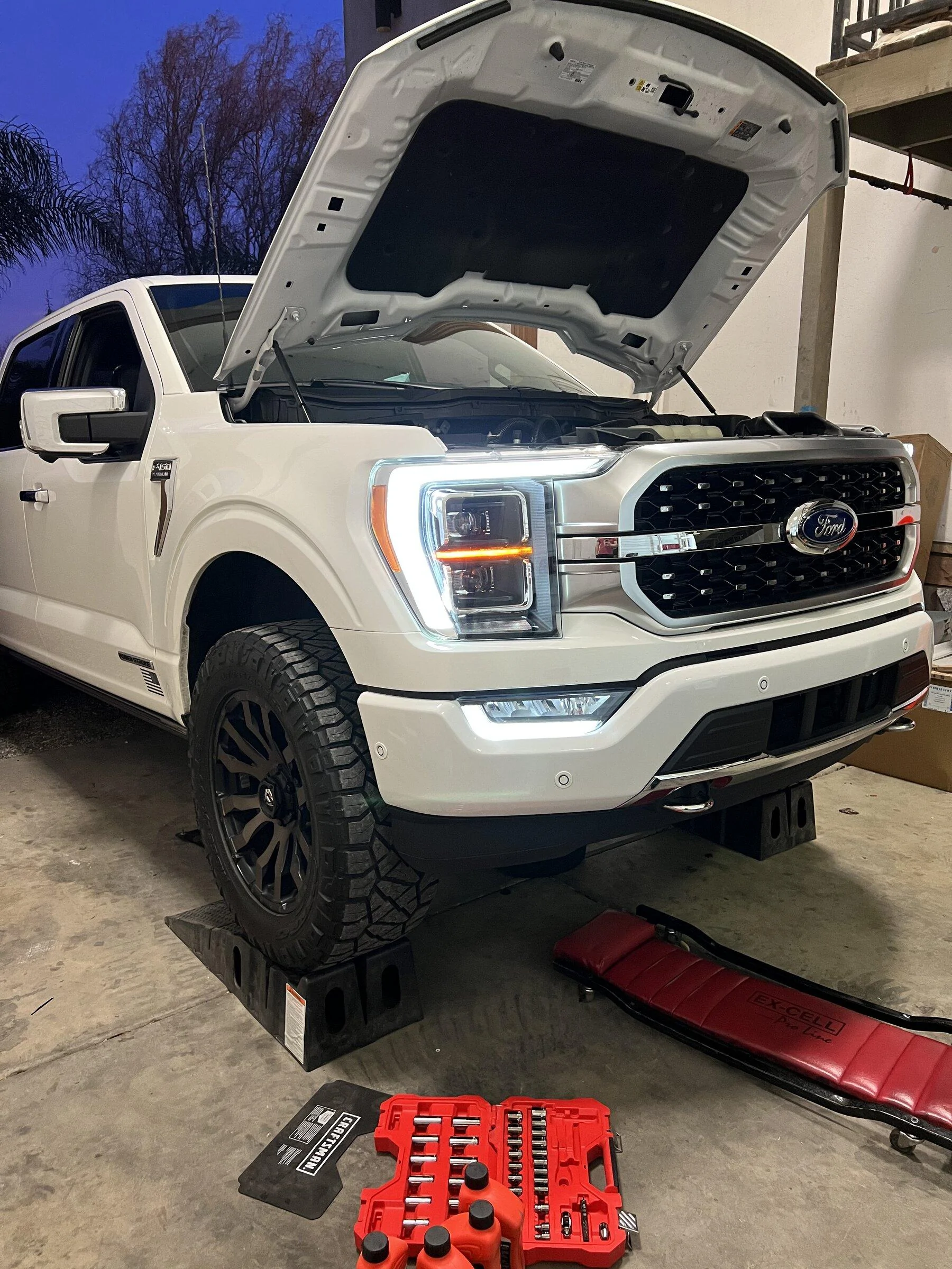

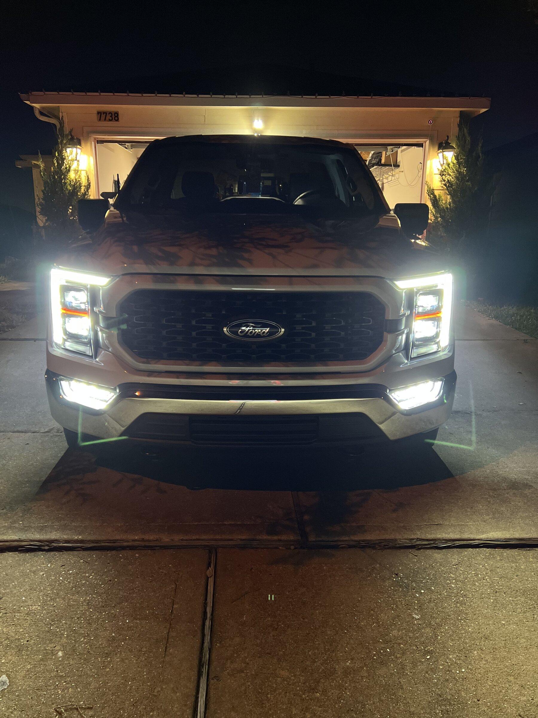

Some shots from last night.
Have followed the thread and can not see any mention of the centre orange bar that appears to be on in the above pictures. Have just got a Canadian spec Lariat with LED headlights and in all modes the centre bar does not light. Is this something to do with it being Canadian ? Is there possibly a Forscan coding I can alter to get it to work.
Your center amber bar should light as it does from factory. My new ‘21 Lariat (finally came in and traded in from a XLT) has it on with this mod; this mod shouldn’t interfere with it at all.
Thanks. It must be something the importers did then, to get it past SVA in UK. Have not carried out the brightness modification yet. Will check first to see if there is a wire at rear of headlight that feeds the centre orange LED. If so they may have cut that as unlikely to have known coding to remove this part only in Forscan.

The amber bar on my US Lariat only comes on with my Hazard lights (and turn signals). :-(

The amber bar on my US Lariat only comes on with my Hazard lights. :-(
Yeah. There are two.. the bottom one is turn signal only. The one between the two projectors is the side marker light. The bottom one won’t come on for parking lights
which amber line are you talking about? The signal one on the lower or amber line in the middle of 2 projector lenses? If it’s in the middle, it’s a steady burn and stays on but if it’s the lower one of the headlight, only turns on when you’re signalling. That’s it.
