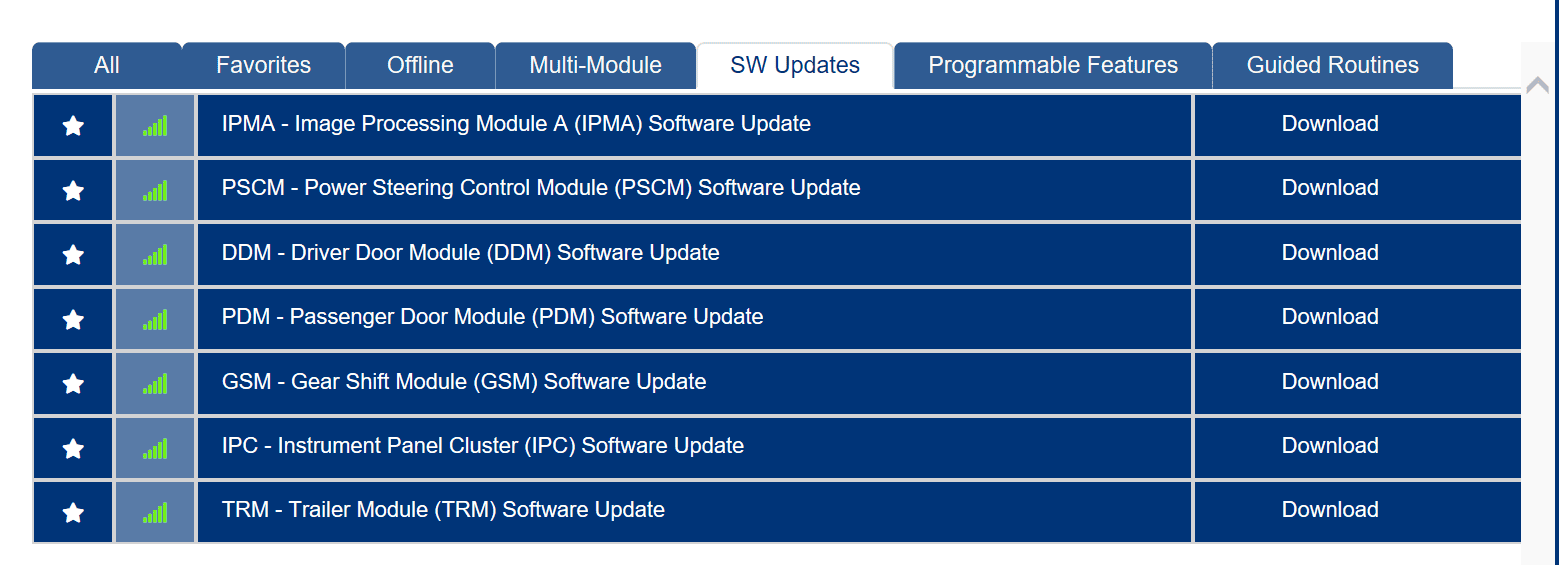

So I've been very vocal in my criticism of Ford this week for how hokey the FDRS update process is. I spent 4 days furious that they wouldn't give me the next set of APIM and GTW updates in FDRS even though I had completed everything in the queue. Thanks to @Bob_Mac I was finally clued into the fact that my IPC was corrupt. It wasn't the kind of corruption we saw with the Nano where there were a bunch spaces or junk characters in the data, but my IPC had one part number (F120) that was updated, and the second part number (F188) was still at the old rev, and corrupted by one letter. This was why the updates wouldn't come through. @Jesse-Infotainment was able to help me work around FDRS to load the F188 file and bypass FDRS. Within five minutes of getting the IPC part numbers to show up correctly FDRS offered me the next APIM update.
So long story short, pay attention to what the guys here advise you to do, and if your updates are not showing up, there is probably a reason, dig into the details.

What was your F188 part number? Mine is ML3T-14C026-BAK. I don't have the F120 listed in my IPC list. Maybe that's why I'm not getting any updates beyond what I got last week???

I'm an XLT with non-bluecruise and non-360. I'm stuck at 244 and have been for at least a month (after doing my initial updates via the nano.). I got my mongoose over a week ago, applied a few updates, but have not been presented with any additional updates to move beyond 244. My VIN is 1FTFW1E86MKD74376.
Someone in a different post mentioned their IPC has a F120 line in addition to F188. I've only got F188 so I'm wondering if my IPC has some sort of issue that's preventing me from getting any further updates.
For my 12" cluster I had
F120: MU5T-10F906-FDA
F188: ML3T-14C026-CPB (This one the corrupt one)
