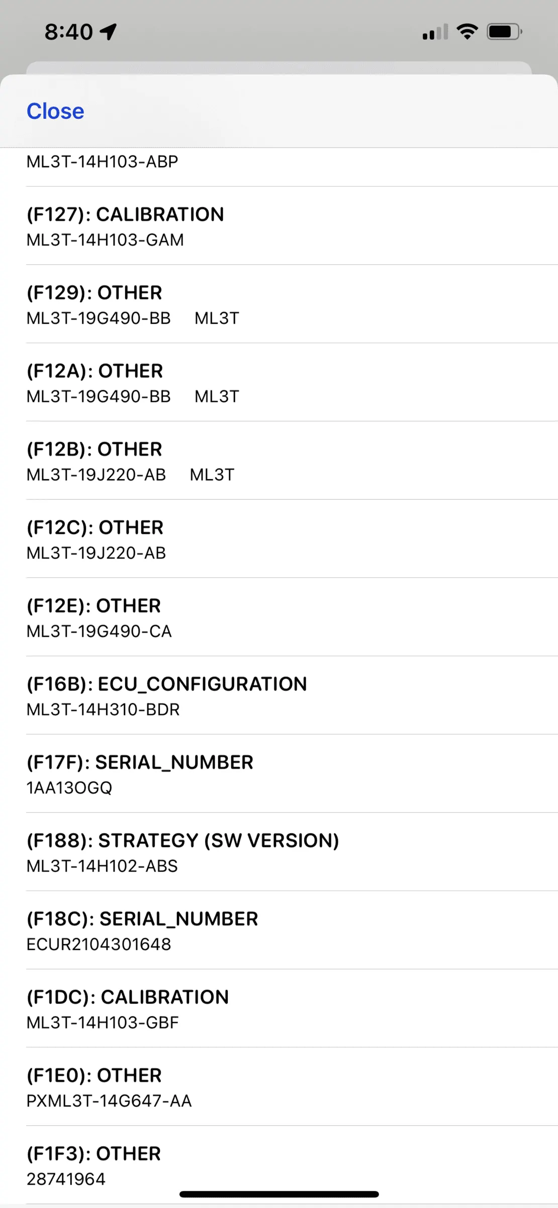

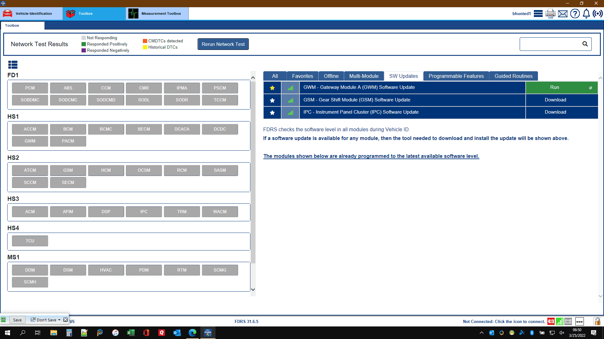

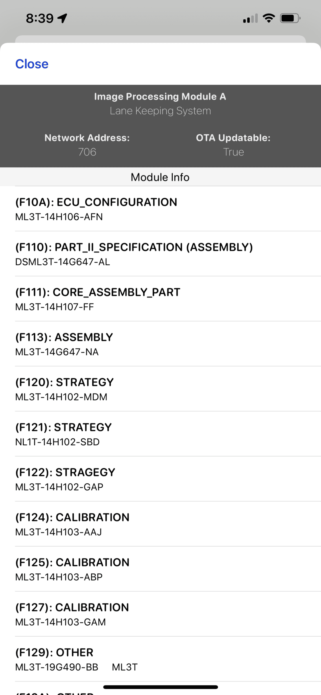

So my truck is at the dealer getting the BC updates installed but the IPMA updated failed on block 4 yesterday and since then he cannot complete IPMA or start GWM.
According to the tech, FDRS doesn’t show an update for the IPMA anymore. I can confirm that someone pulled my updates available shortly after and there was no IPMA update available.
I’m waiting to hear back if the module is purple or if there are DTCs showing.
I’m wondering if anyone has suggestions on how to proceed, he’s waiting on a recovery file from ford but they haven’t responded since early yesterday afternoon.
Would a PMI possibly work or would it show up as updatable if I hooked it to a different laptop?
I’m trying to help throw suggestions his way and prepare myself for fixing this myself if it’s not going to get done today.
Thanks

Here is my IPMA module I for if that helps
Ford F-150 Lightning ECU module programming guide using FDRS 0E427350-785B-4D7F-AF5B-AFC0C8126516
Ford F-150 Lightning ECU module programming guide using FDRS EE585301-9FD9-4E74-8934-2F871BDF5D4E

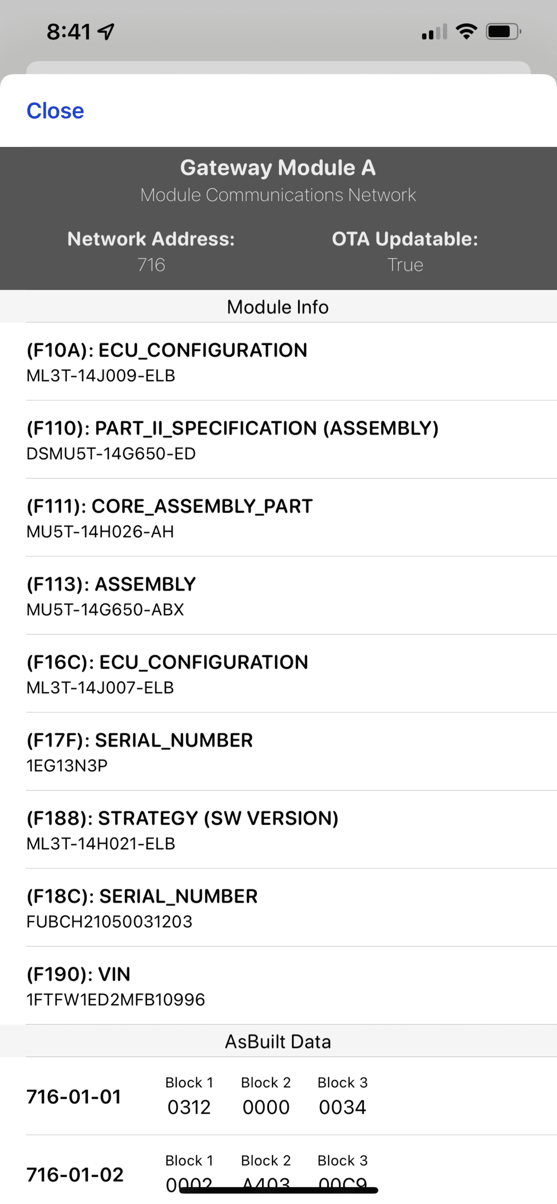

And GWM
Ford F-150 Lightning ECU module programming guide using FDRS 649F8617-4550-4C62-A1AD-21A13CCBD968
Thanks
1FTFW1ED2MFB10996
If you have to I can side load it and ship it back.
also tell him to PMI it before anything else.
i suggested he do a PMI. Thanks, but I’m in Canada, shipping cost and time would be crazy.

Yeah. Well a PMI SHOULD get you going again. I typically say to avoid on a IPMA but in this situation it will be the only way to correct it.
Let me know if it doesnt happen we will have to go a side load route. I can send you an IPMA I have shipping for the company its not bad I ship to canada all the time.
Why avoid an IPMA PMI normally?
You will need to recalibrate the lane keeping cam and your 360 cams. That alone can be a pain. Ive had to do it several times. the 360 cam calibration takes an hour. The lane keep about 20 mins. It can fail while or not stick. Now its not every time you do a PMI but if you had a fail during a update likely hood is youll need to.
