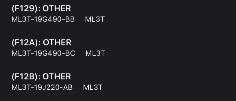

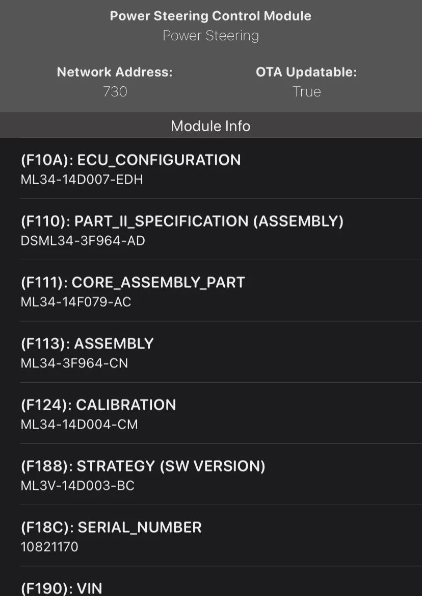

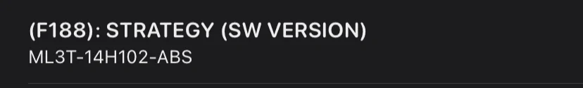

I’ve done all the updates and those 4 modules (ABS, GSM, IPMA and PSCM) won’t clear for me either. This is what I have for IPMA and PSCM. I also have 3 odd balls in the IPMA.
Ford F-150 Lightning ECU module programming guide using FDRS 63CC2184-8080-4A6E-8E96-14FA387B1564
Ford F-150 Lightning ECU module programming guide using FDRS EDAD95BF-393B-4ACA-85D1-9DFF1517A456
Ford F-150 Lightning ECU module programming guide using FDRS 1468C786-C0C5-46F5-8EA5-5A60D0519239

I managed to further track down your PSCM update which as per Ford is labeled as "Blue Cruise capability Coordinated SA for ADAS, PSCM, CCM and DSMC"
<NODEID>
730
<F10A>ML34-14D007-BDH</F10A> <= ECU_CONFIGURATION (MATCHES WITH FORD)
<F110>DSML34-3F964-AC</F110>
<F111>ML34-14F079-AC</F111>
<F113>ML34-3F964-BM</F113>
<F124>ML34-14D004-BM</F124> <= CALIBRATION (MATCHES WITH FORD)
<F188>ML3V-14D003-BC</F188> <= STRATEGY (MATCHES WITH FORD
<F18C>10080399</F18C>
<F190>1FTFW1Exxxxxxxxxx</F190>
</NODEID>
In other words, you PSCM is up to date and mothership is aware of it!
Now for IPMA:
<NODEID>
706
<F10A>ML3T-14H106-AFN</F10A> <= ECU_CONFIGURATION (MATCHES WITH FORD
<F110>DSML3T-14G647-AL</F110>
<F111>ML3T-14H107-DF</F111>
<F113>ML3T-14G647-LA</F113>
<F120>ML3T-14H102-MDM</F120> <= STRATEGY (MATCHES WITH FORD)
<F121>NL1T-14H102-SAD</F121> <= STRATEGY (MATCHES WITH FORD)
<F122>ML3T-14H102-GAP</F122> <= STRATEGY (MATCHES WITH FORD)
<F124>ML3T-14H103-AAJ</F124> <= CALIBRATION (MATCHES WITH FORD)
<F125>ML3T-14H103-ABP</F125> <= CALIBRATION (MATCHES WITH FORD)
<F127>ML3T-14H103-GAM</F127> <= CALIBRATION (MATCHES WITH FORD)
<F12A>ML3T-19G490-BB</F12A>
<F16B>ML3T-14H310-BMR</F16B>
<F17F>1AA13HR9</F17F>
<F188>ML3T-14H102-ABS</F188> <= STRATEGY (MATCHES WITH FORD)
<F18C>ECUR2103901732</F18C>
<F1DC>ML3T-14H103-GCF</F1DC>
<F1E0>PXML3T-14G647-AA</F1E0>
<F1F3>28741962</F1F3>
</NODEID>
