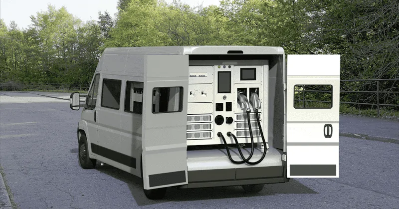

They exist.
Emergency roadside assistance carries them sometimes.
Here's an example:
56kWh Emergency mobile EV charging system
SETEC Power emergency mobile EV charging system is the perfect solution for roadside or remote electric vehicle rescue when the battery runs out. Installing SETEC POWER’s Emergency mobile EV charging system on the vehicle breaks space limitations and allows rapid deployment without infrastructure. This is ideal for fleet operators, car dealers, and other businesses as it provides cost-effective and flexible Energy as a Service. Additionally, it is compatible with all electric vehicles and offers DC charging.
Emergency mobile EV charging system Advantages
  • Charging services can be provided without permits or time-consuming major construction.
  • The built-in 56kWh battery pack provides 60kW DC power for EV charging.
  • It can be quickly deployed to locations where timely EV charging is required, including roadside or remote areas.
  • It can avoid the high rates associated with supplemental power during peak hours, thus effectively reducing operating costs.
  • It can be supplemented by public EV charging stations with CCS2 or CCS1, CHAdeMO, Type 2, or Type 1 charging cables.
  • DC fast charging for any DC-compatible EV via CCS1 or CCS2, CHAdeMO, or Tesla.
Ford F-150 Lightning External Battery to Charge LER Battery? Does it Exist? 1722131090703-3d
https://www.setec-power.com/emergency-mobile-ev-charging-system/
This one is kind of...huge!
Maybe there are smaller ones, eh?
