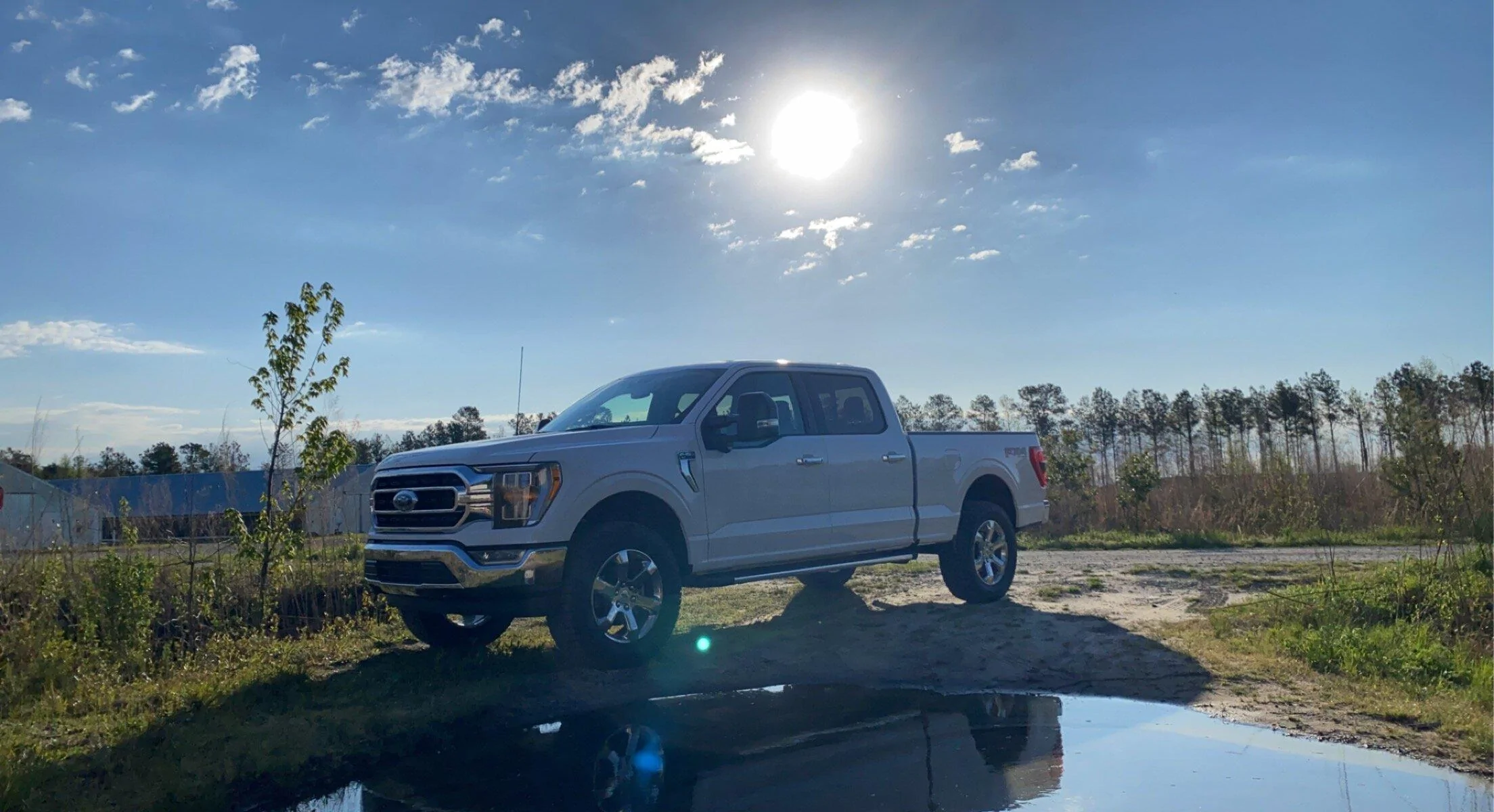

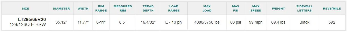

NITTO Ridge Grapplers 285/65R20. Lariat with max tow. Had them put on the Mammoth 2.5 Leveling kit as well. Zero rubbing. Also to note I had already installed weather tech mud flaps and they do not interfere at all.
Once the sun comes out I'll post more pics if there is interest in them.
Next week the tint guy gets the truck for a couple of hours.
Had to Edit, I have 295/65R20.

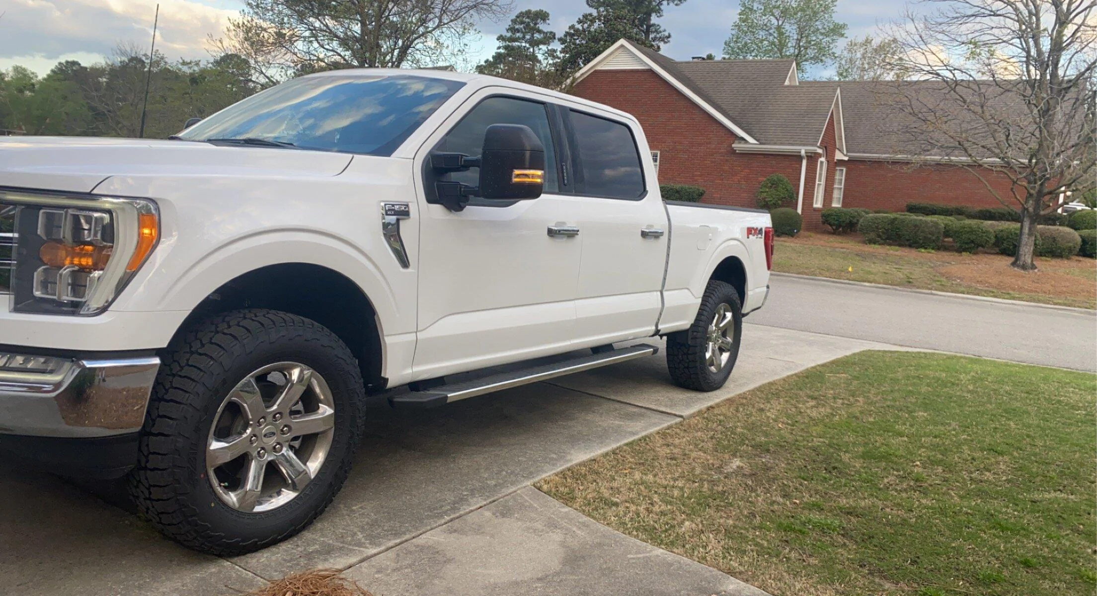

I had the dealer swap the tires from my trade ,same size Wildpeaks AT3 only had 1k on them so I figured it was worth a shot. The stock "AT" tires are a joke and would have been replaced either way.

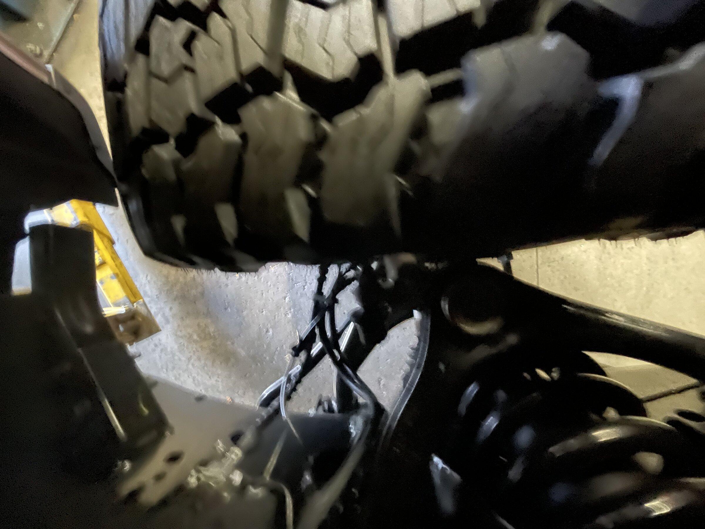

20” stock wheels
Mickey Thompson Baja Boss A/T tires
295/60R20
Falcon Tow/Haul Sport Leveling Shocks
No rub in the front
The rears rub on the extra reservoir dampening adjustment knob at flex point
