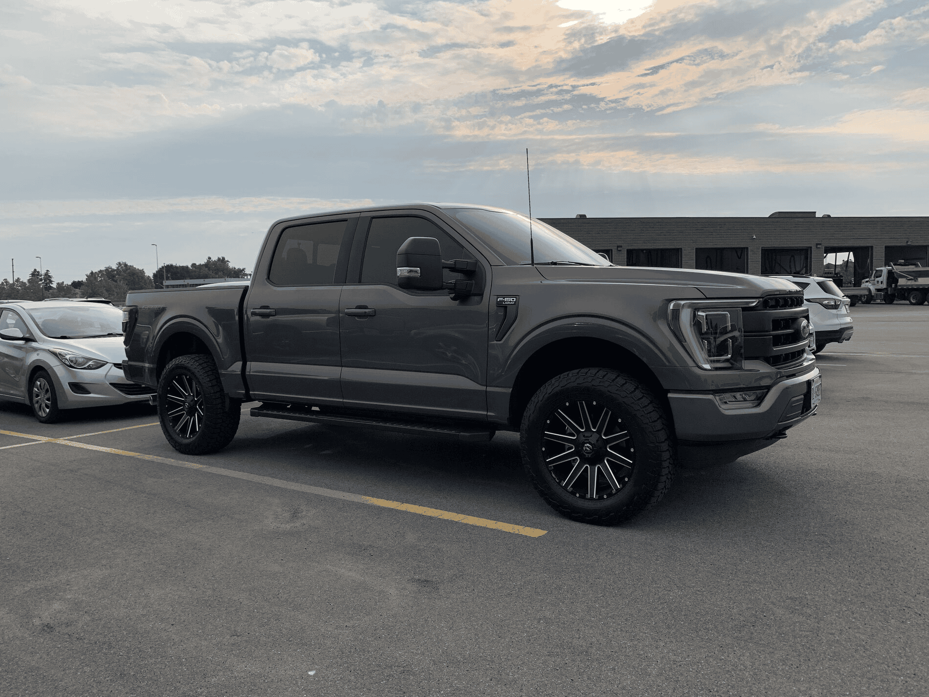

according to willtheyfit.com, this is pretty close to what I am shooting for. same amount of poke and diameter, cept mine will probably be on 18s (Fuel Shok).2.25" Readylift Level, 20x9 Fuel Rebel 6 with +1 offset, 295/60/20 BFG KO2 tires. Had to remove the front crash bar and trim the lower valence plastic just a little, but a 34" tire fits.
