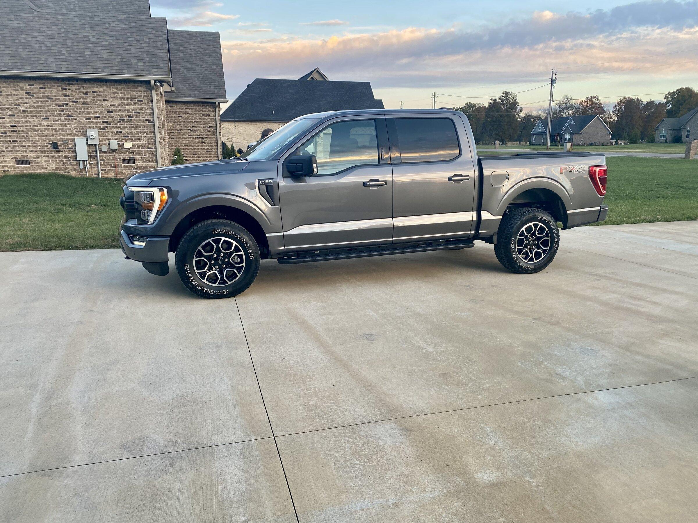

Very nice, Jpmpr33. Just wanted to try again to see if we could find out why the Rough Country brackets didn’t work.
They fit fine, just installed them yesterday

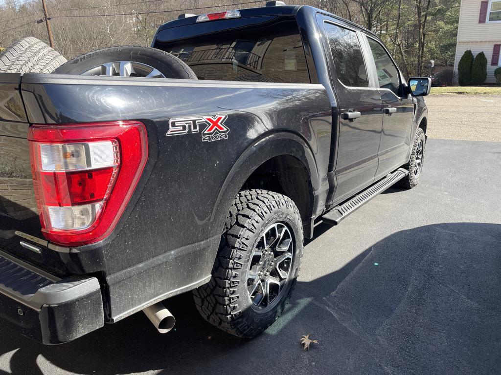

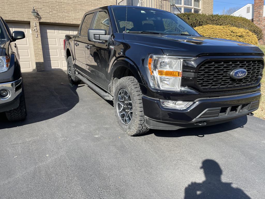

275/65/18 Goodyear Duratrac in load range C
The STX package came with 275/60/20
Speedometer @ 70mph was ~67mph on GPS....stock config in computer was 2547mm circumference (still incorrect for 20" setup but speedometer was accurate) and was changed to 2471mm and speedometer is now accurate.

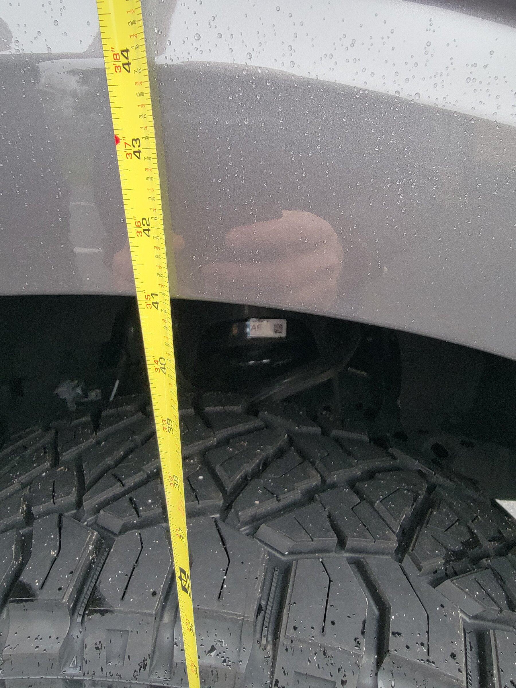

What’s your measurements on the new rake ground to top of wheel well?
I'll get measurements tonight when I get home. I listed the tires wrong I have 295/65R20's. Sorry about that. I edited my previous post.
Ford F-150 Lightning Factory Wheels with Aftermarket Tire Thread 1646919991993
OK I ran out and took some measurements. The camera angle is higher than the measurement shows.
Front Exact Measurement is 41 1/8.

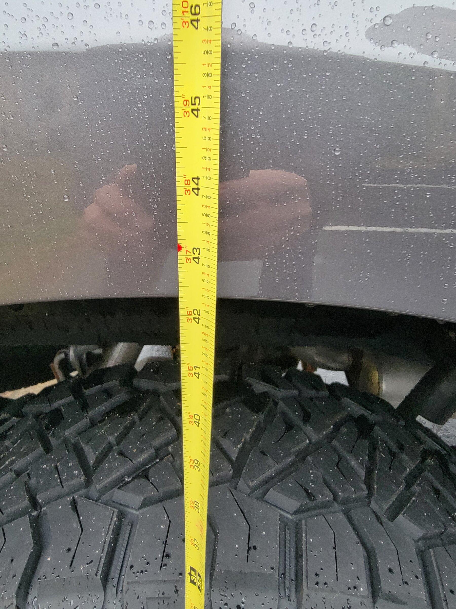

And the Rear measurement is 42 1/4

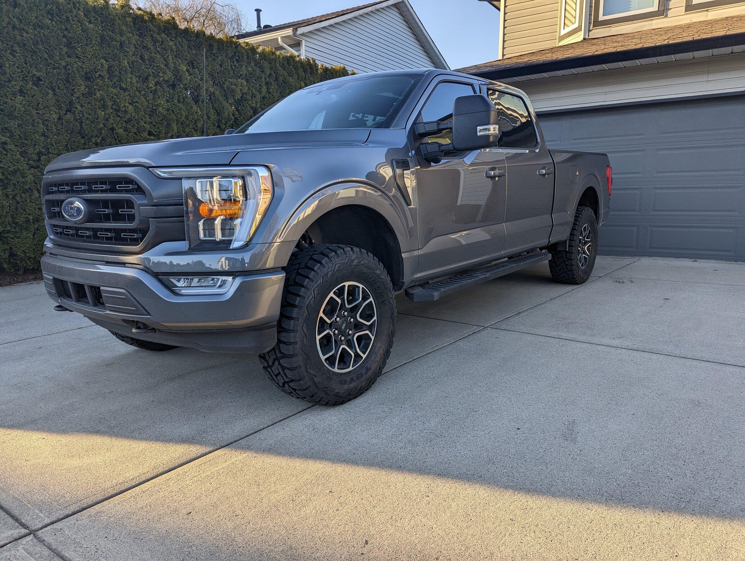

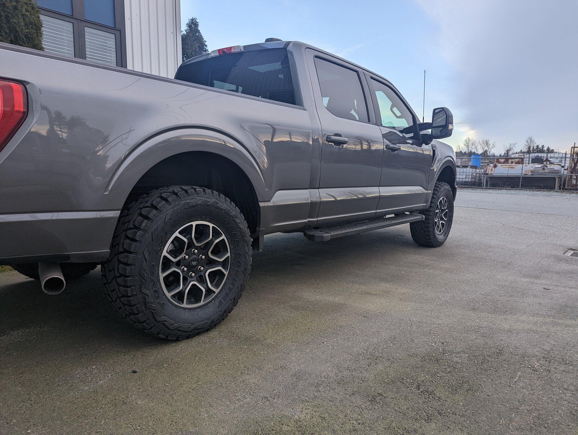

Just put the 35 x 12.5 x 18 Toyo Open Country RT on factory 22' Sport rims. 3" Rough Country Lift. Had to use a 1/4" Spacer up front was just touching the A arm.

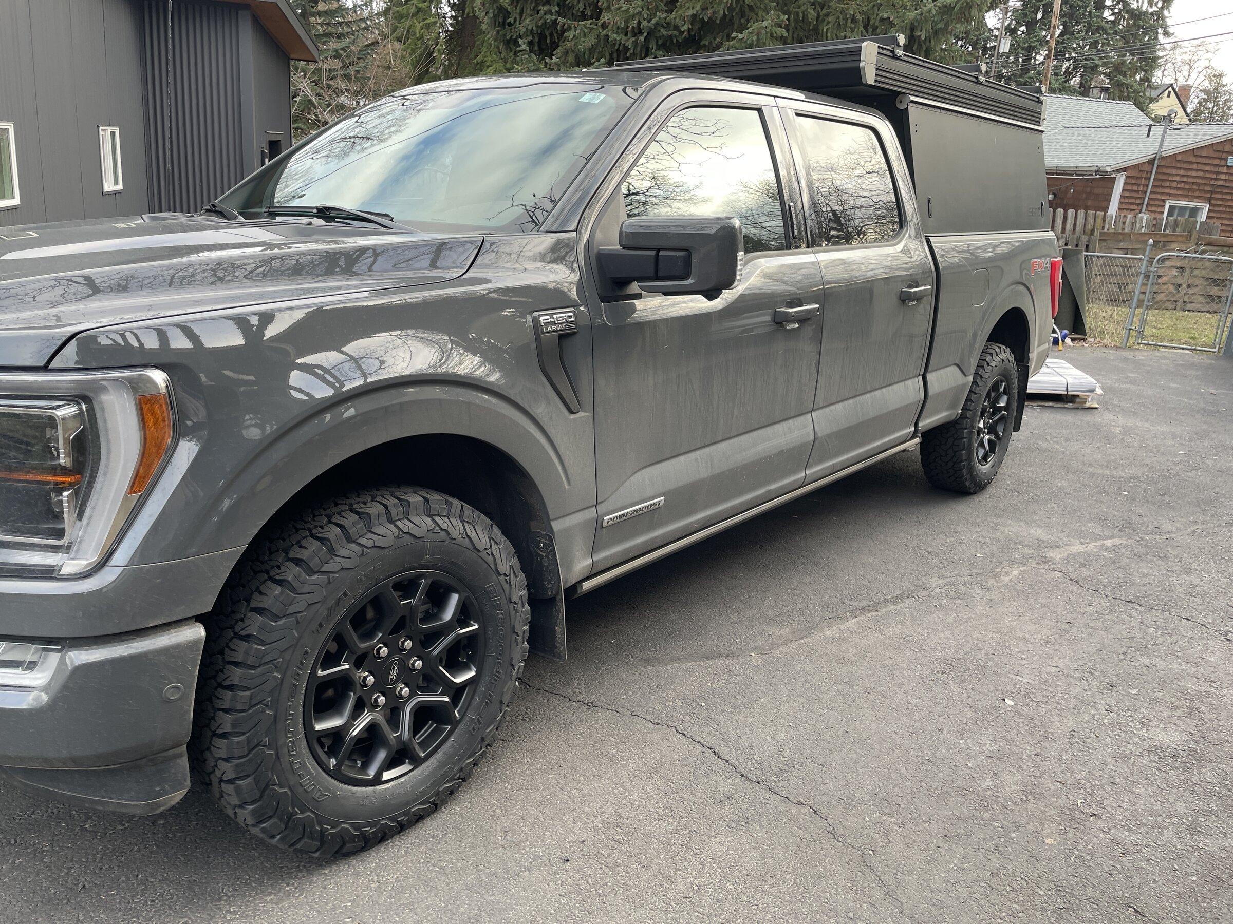

My PB came with the 20s. Since I have Max Tow, I bought a set of the 18" sport wheels on eBay (super inexpensive) and had them powder coated matte black. Wrapped in 275/70r18 KO2s, which are essentially the same size as stock (33.1" diameter, 11" wide). I had a set of 35x12.5x18 KO2s on reserve as well but decided to pass. I prefer a narrower tire off road plus better mileage.
Next up is a level.
