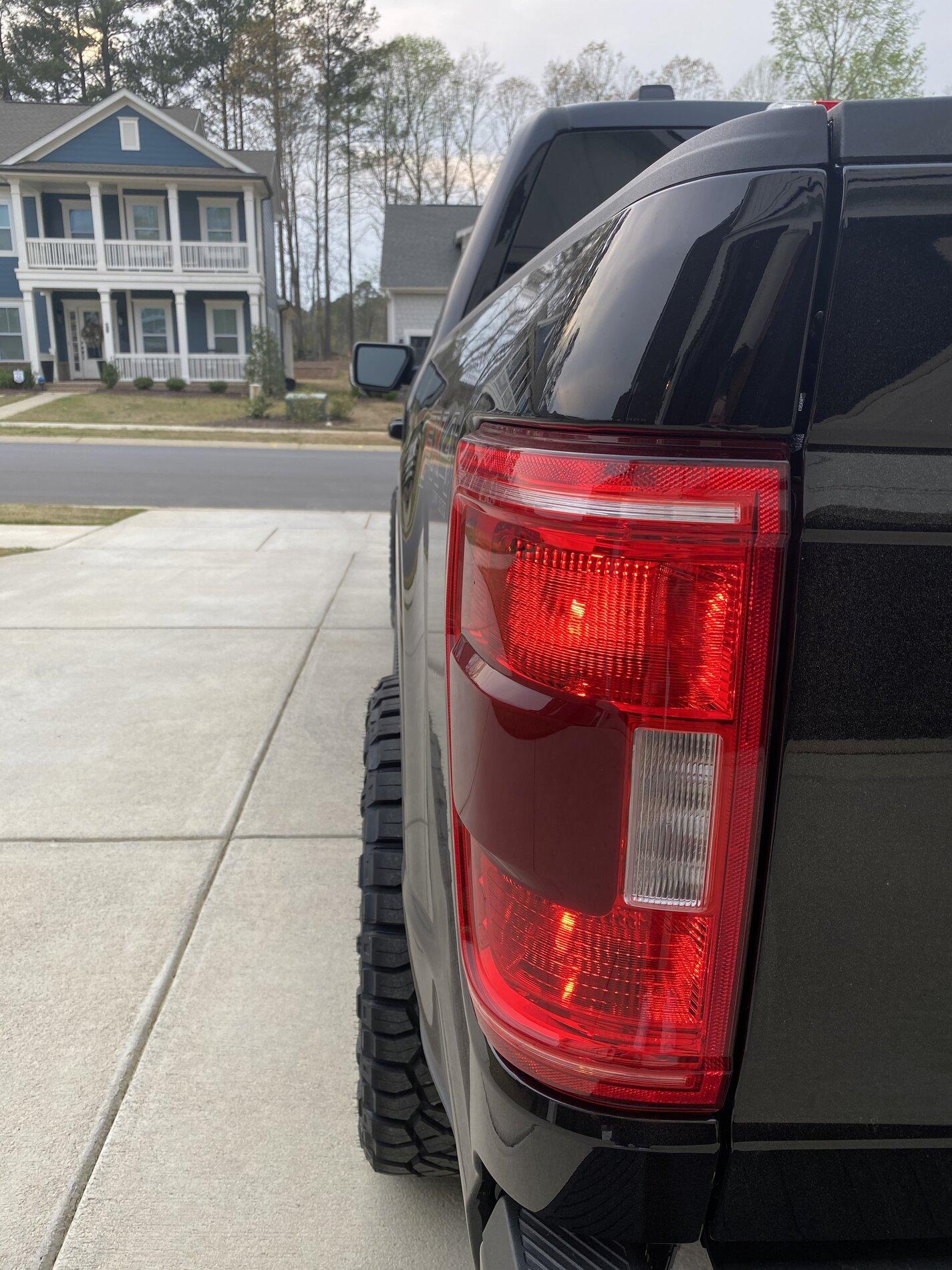

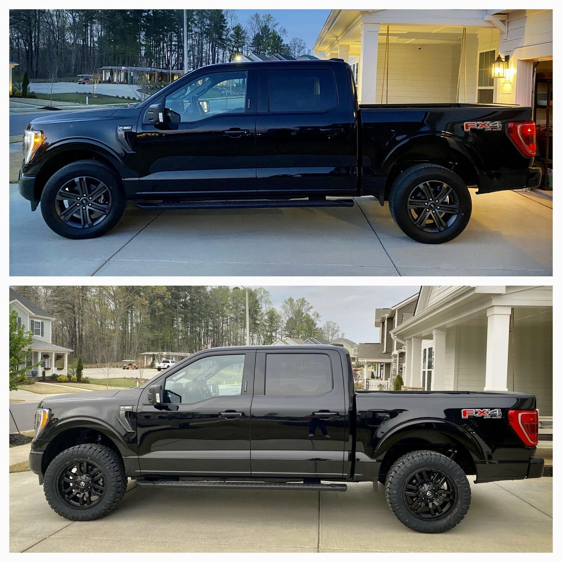

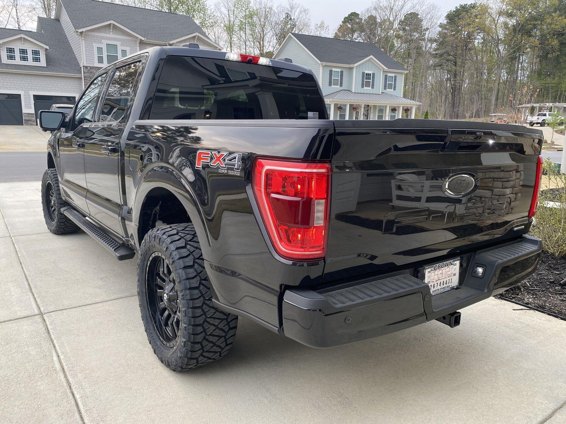

Got mine leveled and mounted today.
ProComp 2.25” level
Fuel siege 20x9 +1offset
295/55/r20 Nitto Ridge Grapplers
- a little more poke than I intended but it looks mean! No rubbing at all

Great looking truck
Reading some people say there are concerns with the 2.25" lift (seeing as its a 2020) and others seemingly having no problem
Whats your thoughts/experience?
The 2021 specific is a 2" I wonder if the 2.25" 'issues' are an urban myth
Thanks
So far I haven’t had any issues, nor have I noticed any difference in the ride.

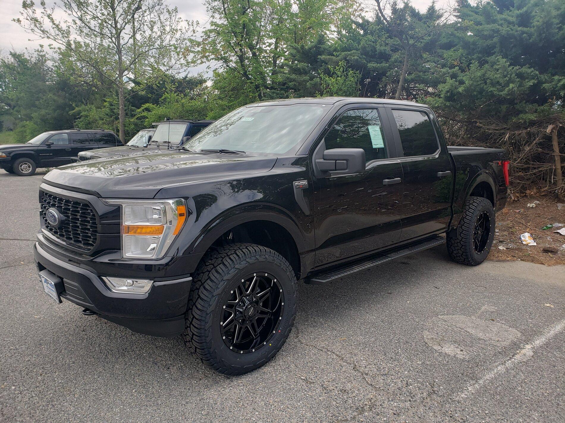

I do upfits for work. We just did this 21 STX. 2.5" level kit with 20" pro comp and 35x12.5 yoko. Crew cabs 18+ all have rub issues with 35s because the front crash bars. You can pry and adjust them to clear.

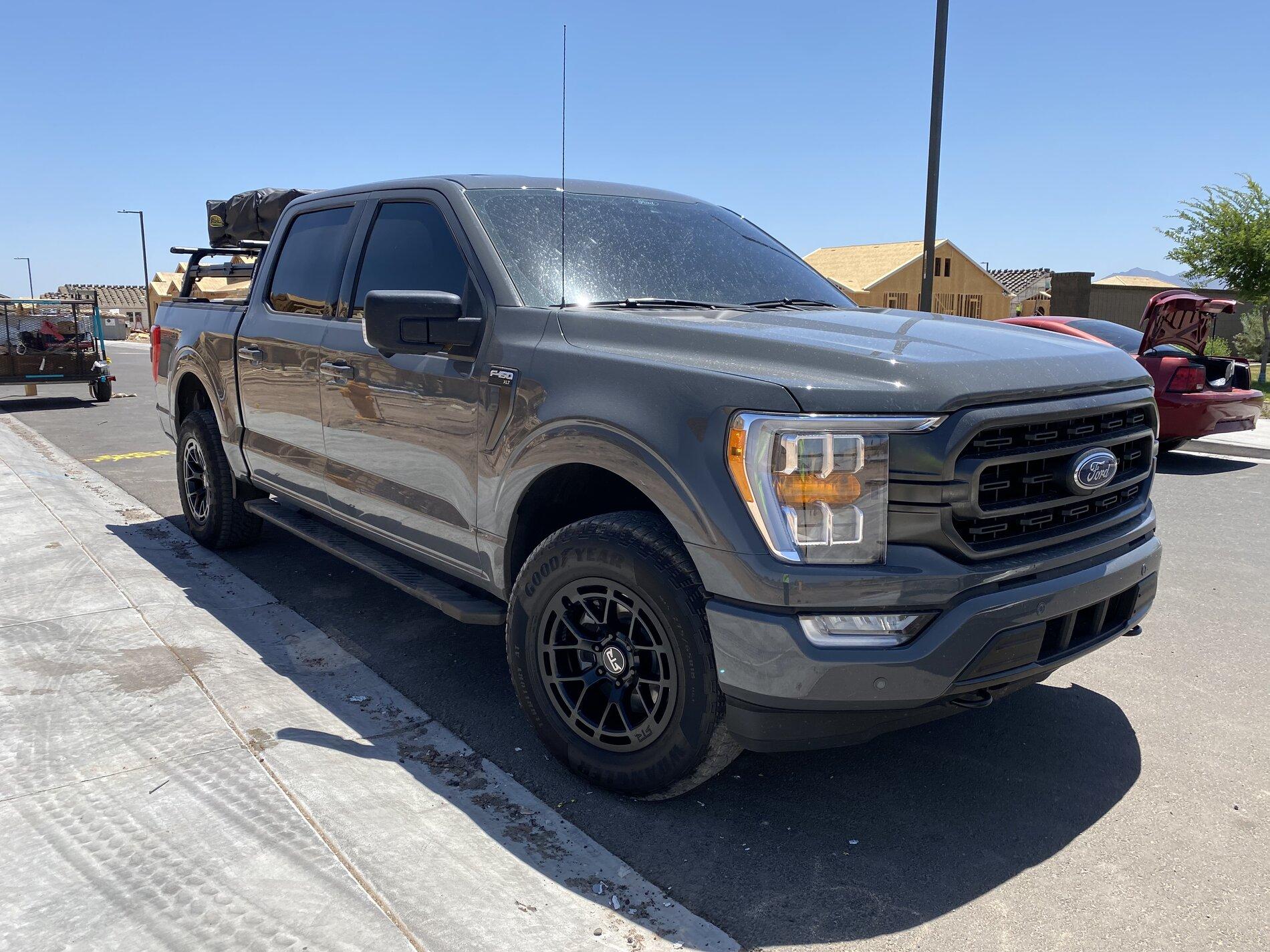

That’s exactly what I went for as well...
Thanks Nifty
Can you please confirm:
-Tire size
-Rim size (including offset)
-Choice of lif or level
Many thanks I'm pot committed now and parts will arrive soon I hope I made the right choices

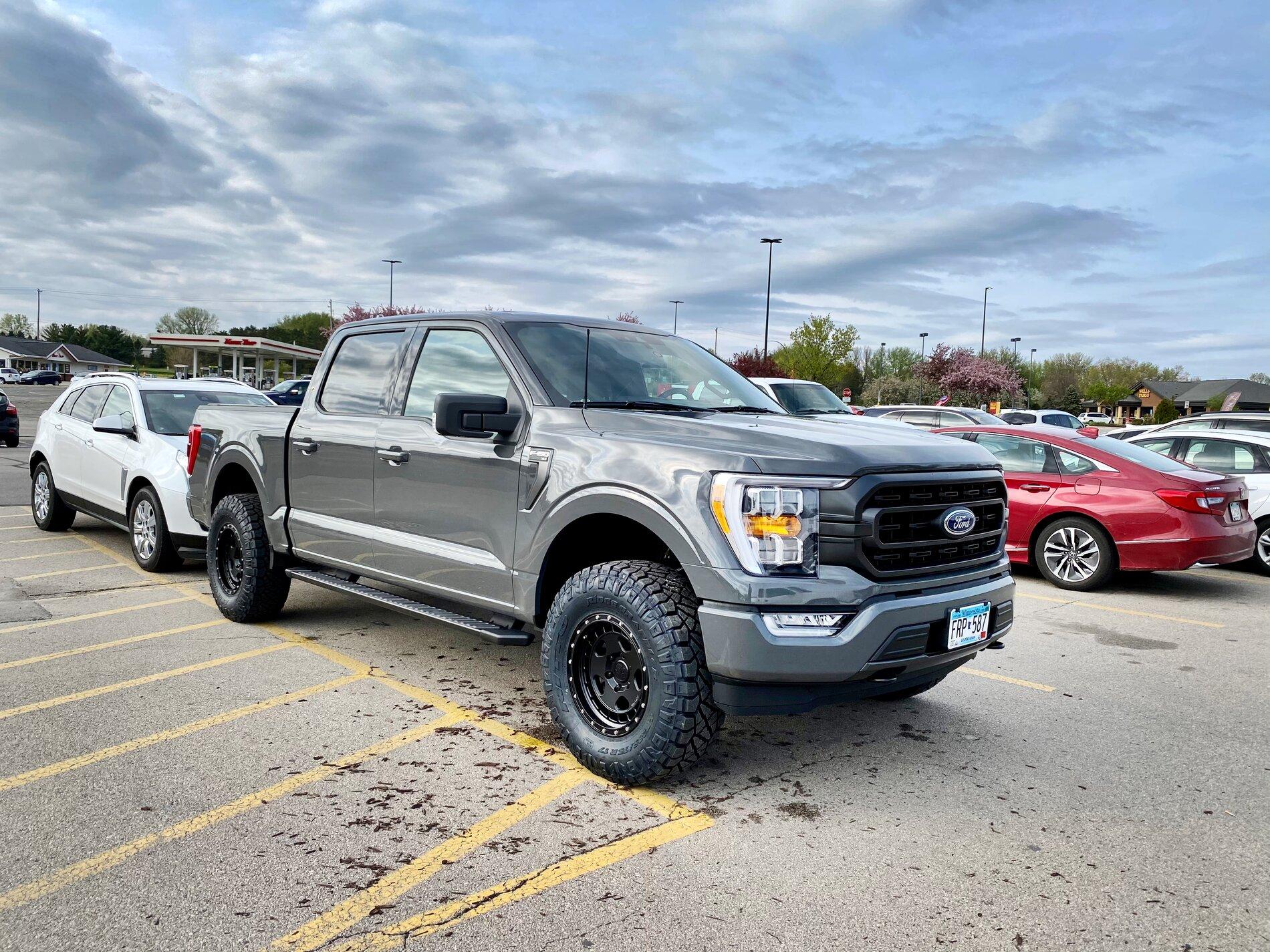

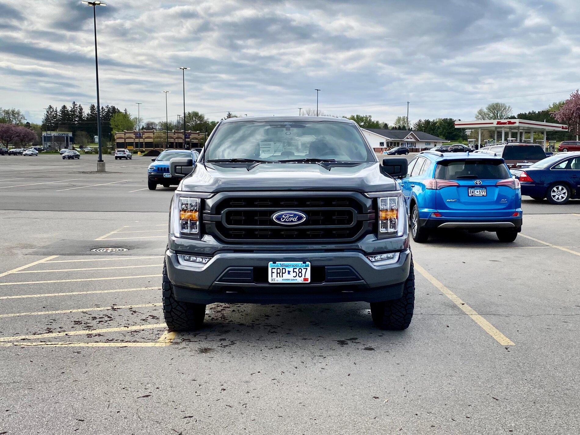

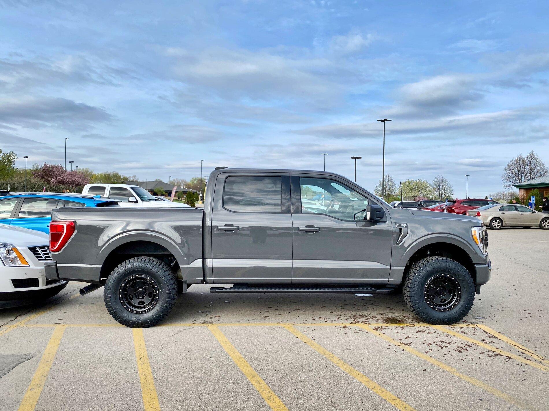

Tire Size: 285/75R17 10E Nitto Ridge Grappler
Rim Size: 17x8.5" ET0
Level: Supreme Suspensions 2.5" leveling puck
I hope this helps! I absolutely love the setup and have zero regrets.

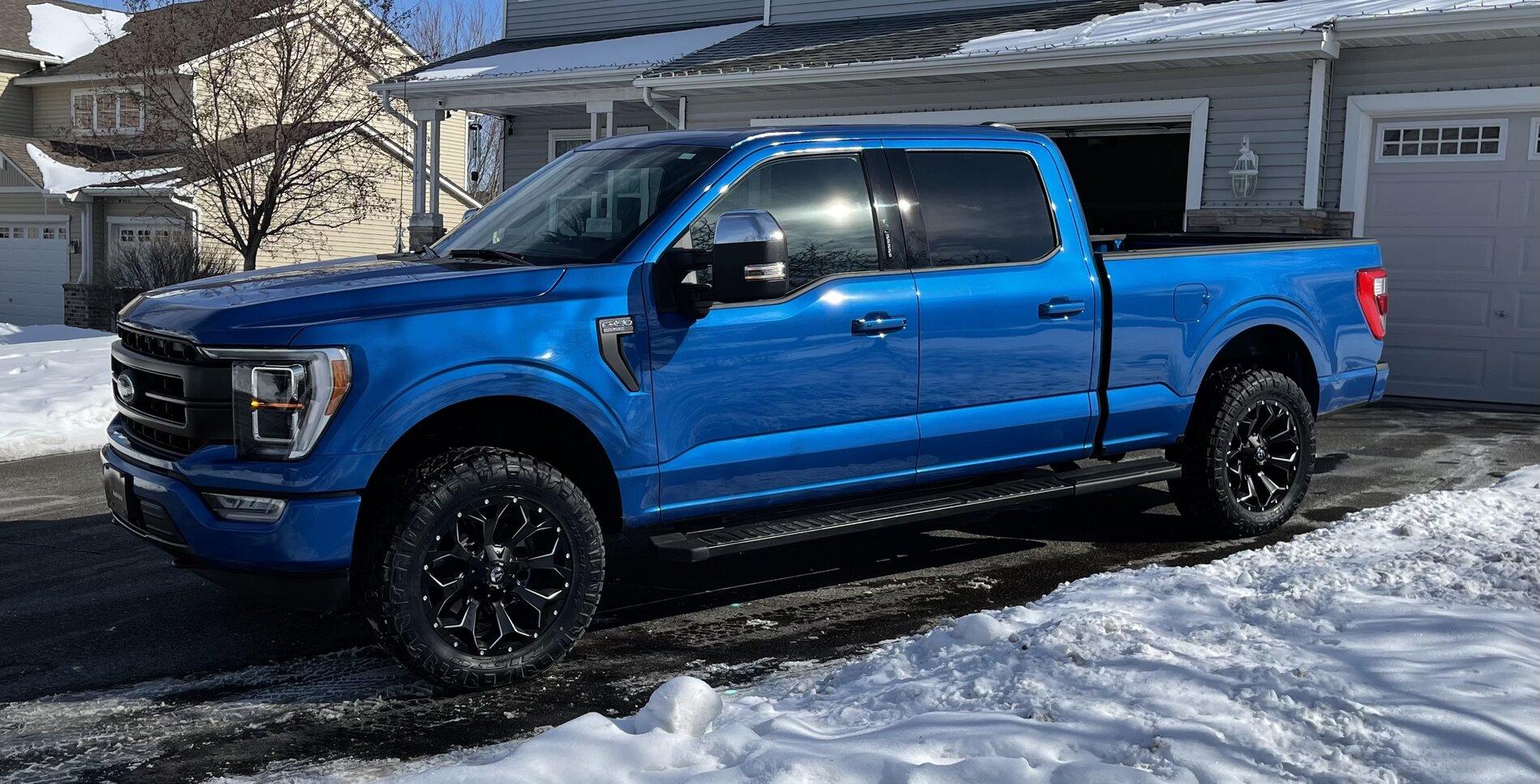

Just got my wheels on. Fuel Rebel 6-Anthracite / Black. BFG KO2 295 60 R20 +20 offset.
I like them, but not sure about the rear poke. I dont want to spray crap down the side, and these appear to poke out than previous setups I have ran. More of an issue with the rears than the front.
What are decent options?
-Fender Flares, Ive never done these because I hadn't ever wanted to drill....should I look at this option though?
-Ford OEM mudflaps. Im not sure this will provide enough coverage
-Clear Bra film?
