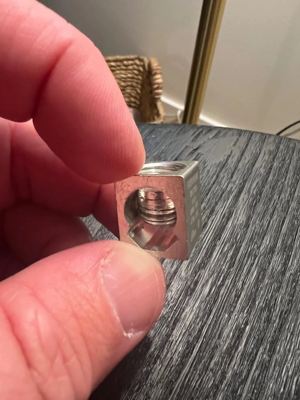

I am also looking for a replacement for this lug. The internal hex socket on the set screw is stripped on my FCSP. Fortunately, the screw was at the correct torque at the point it failed during a follow-up check.

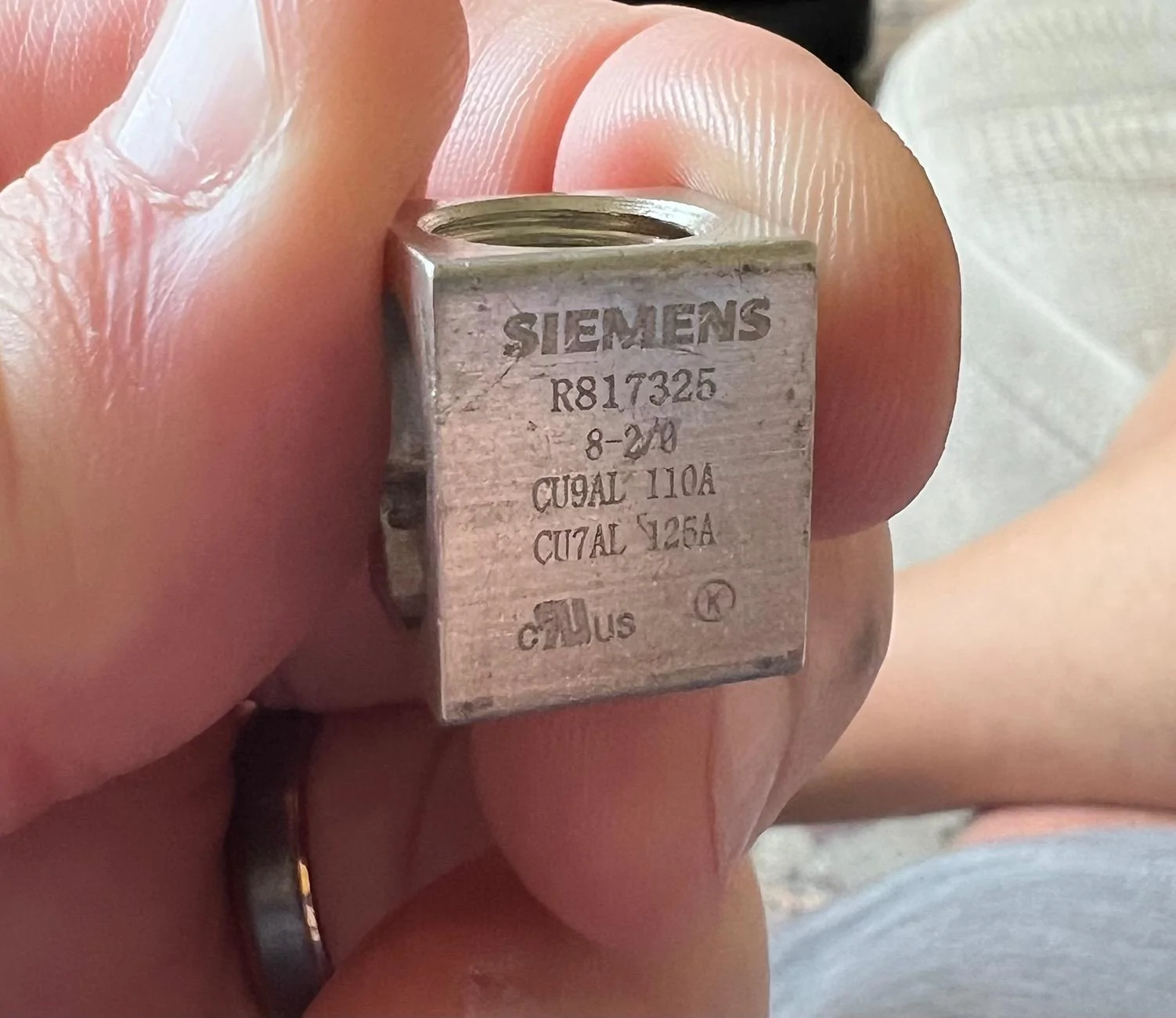

The marking at the bottom of the lug indicates it is a UL Recognized component. That means it can be used as part of another UL listed system like the FCSP. However, it may be difficult to source the part in small quantities.
In my case, the internal socket was a 4 mm hex. A ball head bit has not been used on the failed lug.

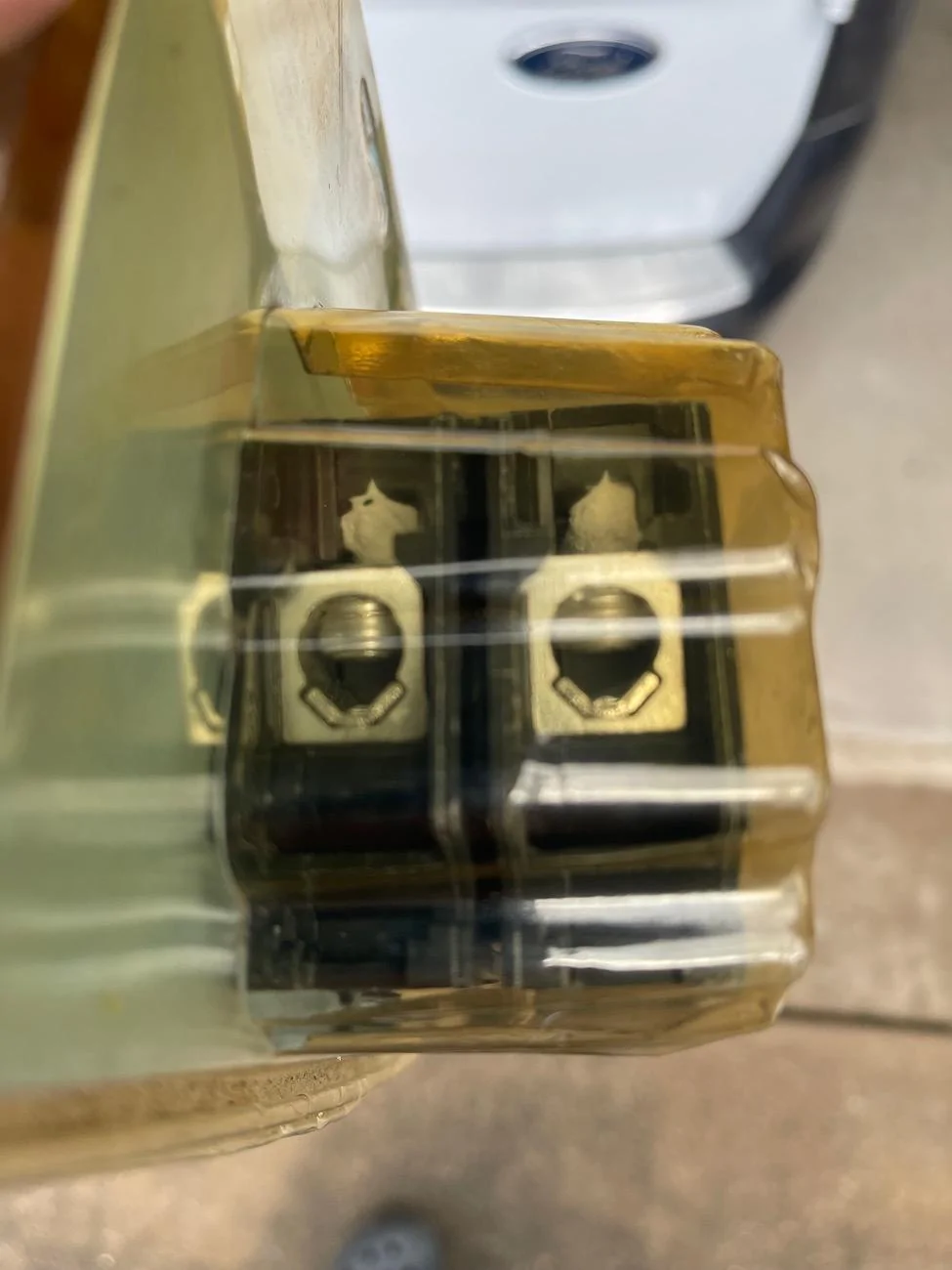

It's ridiculous how brittle they are. Definitely seem like a one-time use deal. This was the second install for mine and it was always going to be a problem.

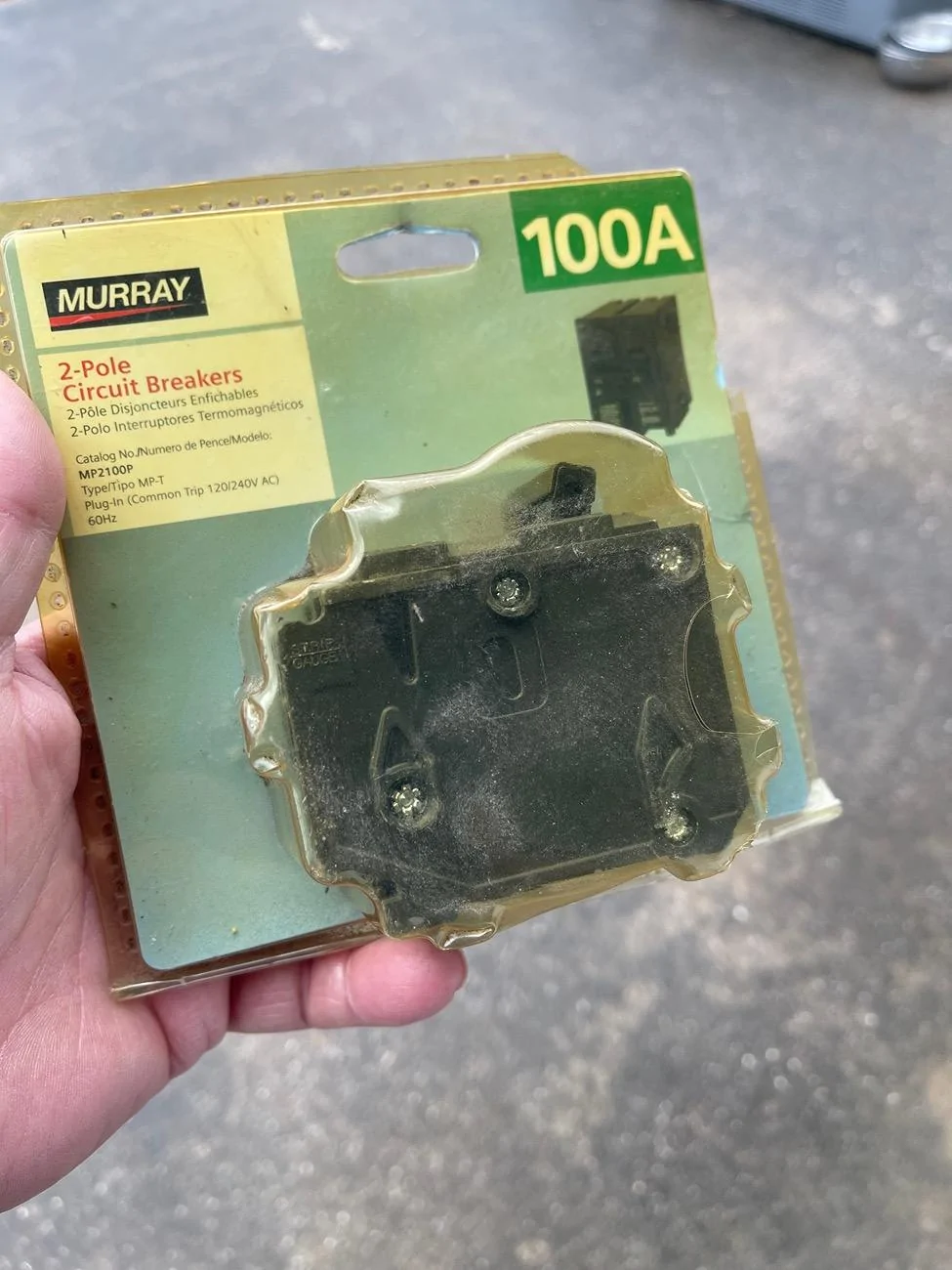

I'm following a couple of auctions on Ebay for the Murray breaker pictured above. May pull the trigger just for the heck of it to see what I can come up with.
