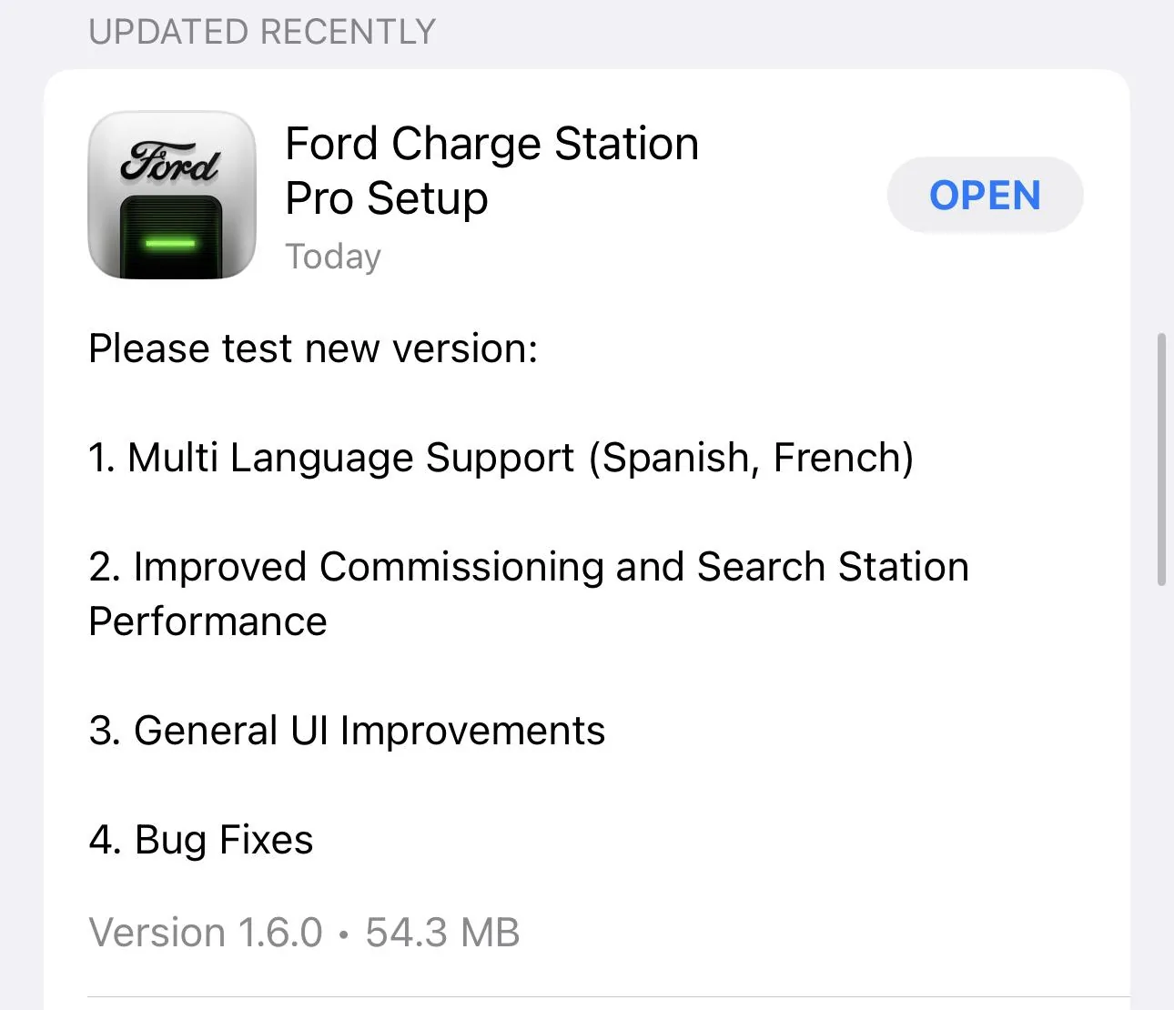

Also released 1.6.0 to Android.
I can confirm that it finds my FCSP much faster now, (logging into existing configuration)

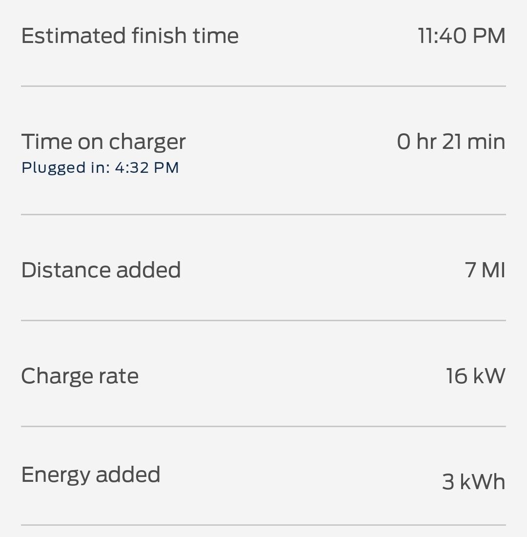

After using level 1 for almost 2 months, this feels like fast charging 😆

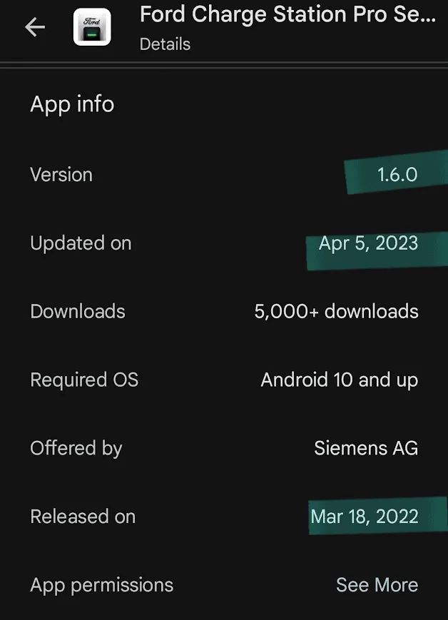

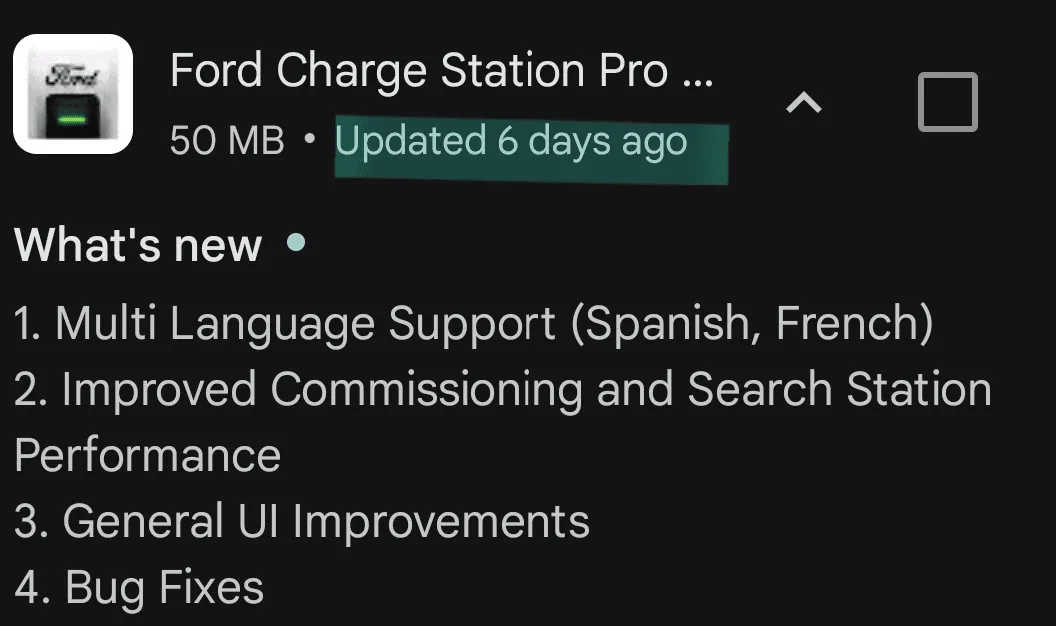

I was looking at my mobile devices Play Store app, noticed in the updates history that the Charge Station Pro Setup utility had an update 6 days ago, but looking at the version number & Release dates, it appears to still be the same.
It's working just as well as it has in recent weeks/months.
Maybe this is just a one off fluke concerning my phone.
