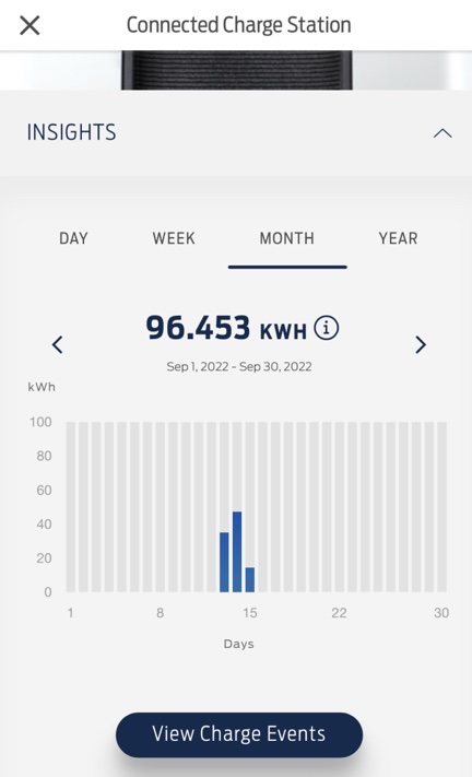

I charged yesterday and again no charger insights - seems since .70 update it stopped reporting.
that’s September in pic.

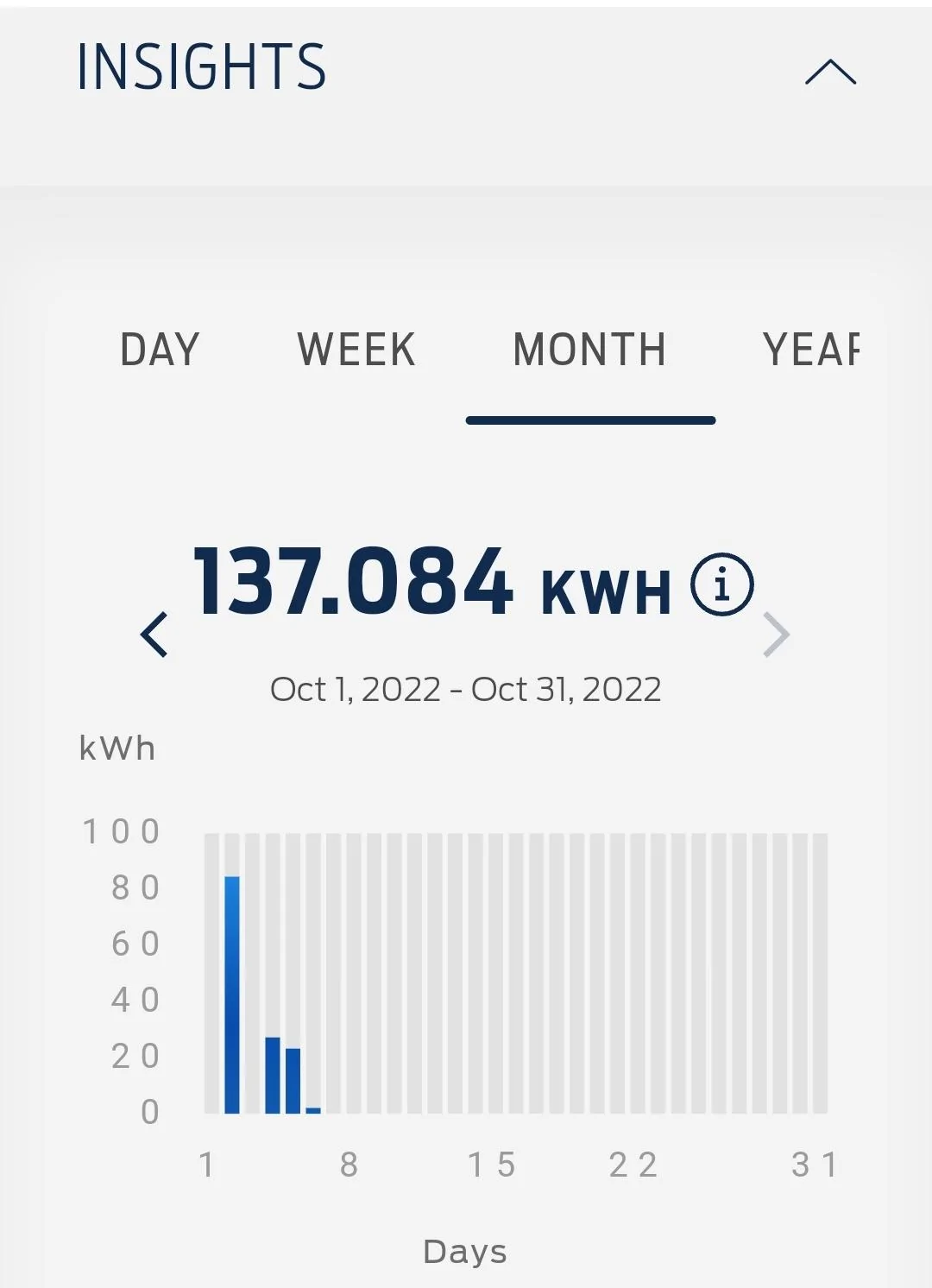

I'll check this evening, I'm not requiring a huge charge though with short trips so far.
This is October so far, had a road trip on Saturday, then charged back to 90%, which was 85 KWH in just under 5 hours

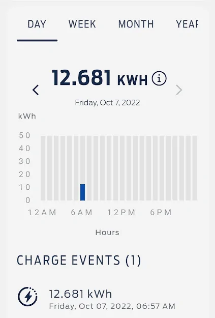

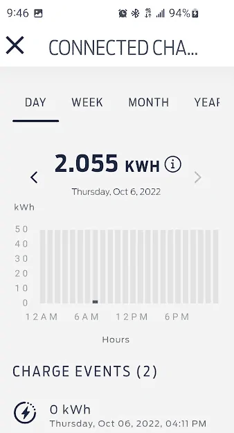

Last nights charge session was brief, only ran 45 minutes to get ~12.681 KWH to replenish the battery 81% to 90%, the charging log data will not post an update until I disconnect the truck from the FCSP, which has always been a operating behavior.

Oddly, the log data to the CH
Ford F-150 Lightning FCSP with dedicated new service to detached garage!! 1665158821118
Then this morning after data posted, it logged in as if the session ran from 6am to 7am, actually it was last night from 9pm to 9:43pm

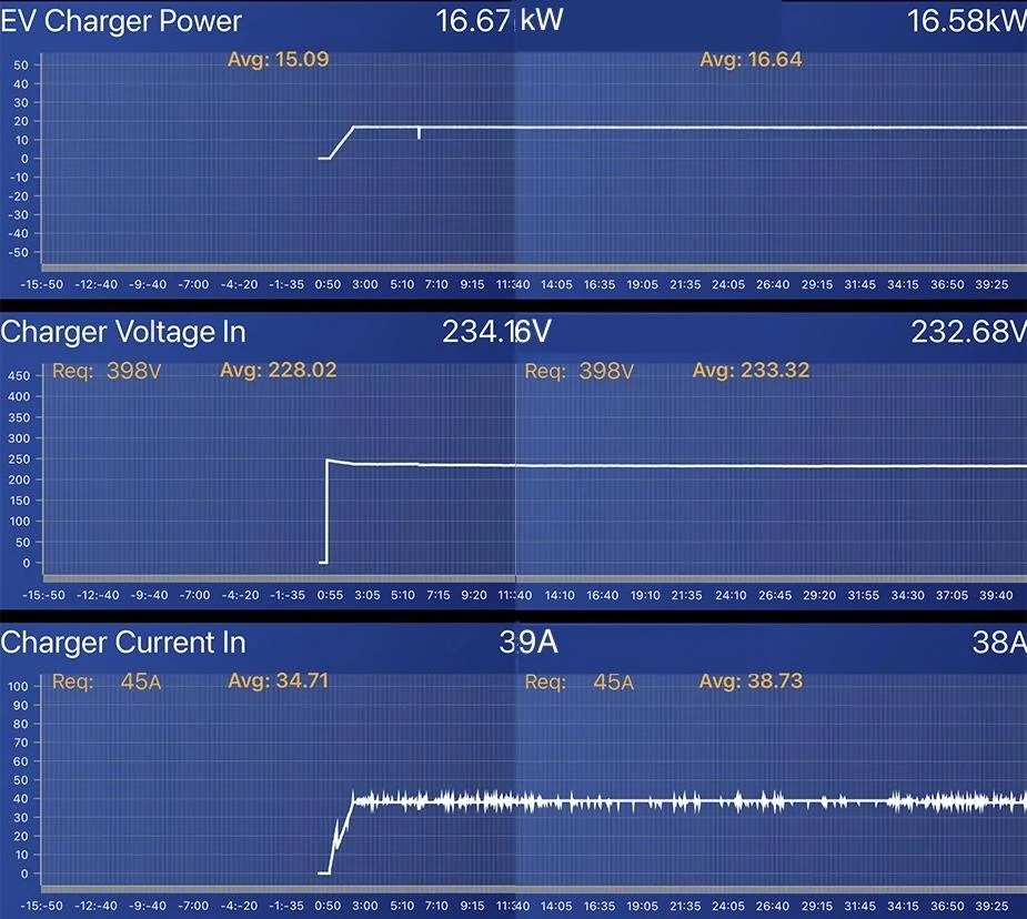

So, this discussion got me curious about what the FCSP‘s charging performance looked like. I’ve seen the DC fast charging curves, but not much discussion on the 80A/240V Level 2 FCSP.
Attached are the curves I observed on my CarScanner iApp for my last FCSP charge from ~52% to ~97% wher it auto stopped despite being set in my FordPass app to charge to 100%???
Note: I had to stitch the screenshots together in Photoshop and repair some of the text wiped out during the the stitching. The Lariat ER has two 40A AC to DC chargers, but I’ve only been able to find one of their PIDs to monitor. That is why the buttom of the three stacked graphs is only showing in the 30’s and below; however, you can do the math and see there is ~72A being delivered to the truck during the bulk of the charging session up to about 90% SoC where the requested Amps drops like a rock. I remember @FlasherZ mention his issues finding the PIDs for both onboard chargers in his postings about his use of the TorquePro Android app. I wonder if he ever cracked that nut????

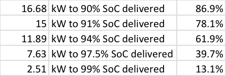

Also, I had to do a separate manual charge session to get it from ~97% to a displayed 100% SoC after the first session mysteriously stooped…..I added that observation to my list of observed kW delivered by the FCSP posted below.
Also, I’m only posting the graph from the beginning and the end of the session because the average charge rate kW delivered was fair constant during the middle of the session. These graphs document my following observations from the real time data:
Ford F-150 Lightning FCSP with dedicated new service to detached garage!! 1665169644308
The beginning of the charging session:
