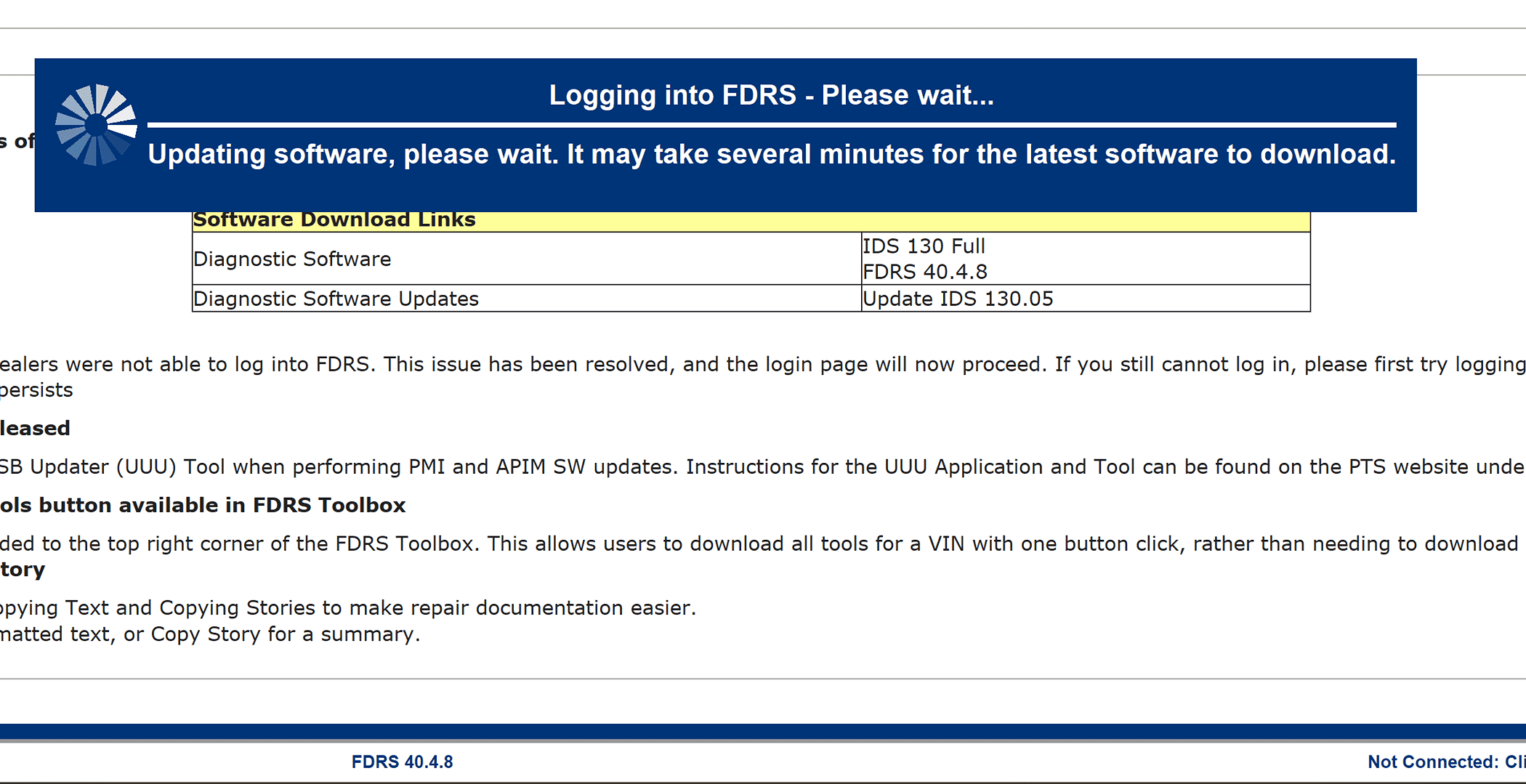

First time trying to use FDRS and its been stuck on the Logging into FDRS - Please wait... Updating software screen for about 40 minutes. I assume it should not take this long? Any advice what to try
Ford F-150 Lightning FDRS stuck at Updating software Screenshot 2024-06-21 190729
Seems to be getting stuck here in the logs:
2024-06-21T20:08:33,531 INFO basedata.dflt.UpdateBaseDataServiceImpl - Base manifest expired full base download needed.​
2024-06-21T20:08:33,532 INFO basedata.dflt.UpdateBaseDataServiceImpl - Base Manifest expired in offline mode. Deleting it to force update​
2024-06-21T20:08:33,535 INFO basedata.dflt.BaseDataServiceImpl - Installing base data​

Tried a different computer and was able to get past the issue. Too bad since the computer that works only has 1 USB ports and is below the system requirements 😬

Just restart FDRS or the laptop. I assume you got it working by now?

Nope, never got FDRS working on the laptop. Had to use another laptop for it to work. I tried older version, deleting the data, just could not figure out the issue
