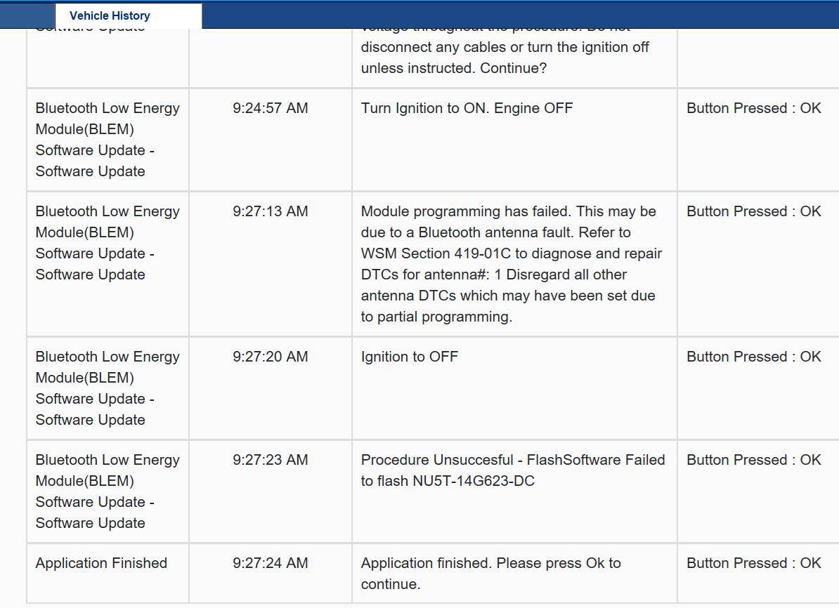

Picked up a 2 day license and got most of my updates caught up. Had a PCM, ABS, PSCM, SOBDMC, RFA, ACM, TRM, BECM, GFM2, SOBDM, SOBDMB, DDM and PDM available. I was able to run all of them successfully except the RFA which errored out (below). Has anyone seen this error before and/or knows how to get around it?
I did do the rotary shift mod, but I don't think that would be related to this. I did try to do a PMI on the GSM to see if it would work on the rotary shifter, but it errored out with "invalid hardware". I tried stating I didn't have the original module and then again stating I did. I was able to do a VIN Write successfully.
EDIT: Temporarily put the original shifter back in and it made no difference. Tried a PMI on the RFA as well. I'll next try a PMI on the ACM like rugedraw suggested below.

Hey Steve, if your license is out and you want to try again I have a year license which is still good for a few more months. I can loan you my stuff just sent me a PM.

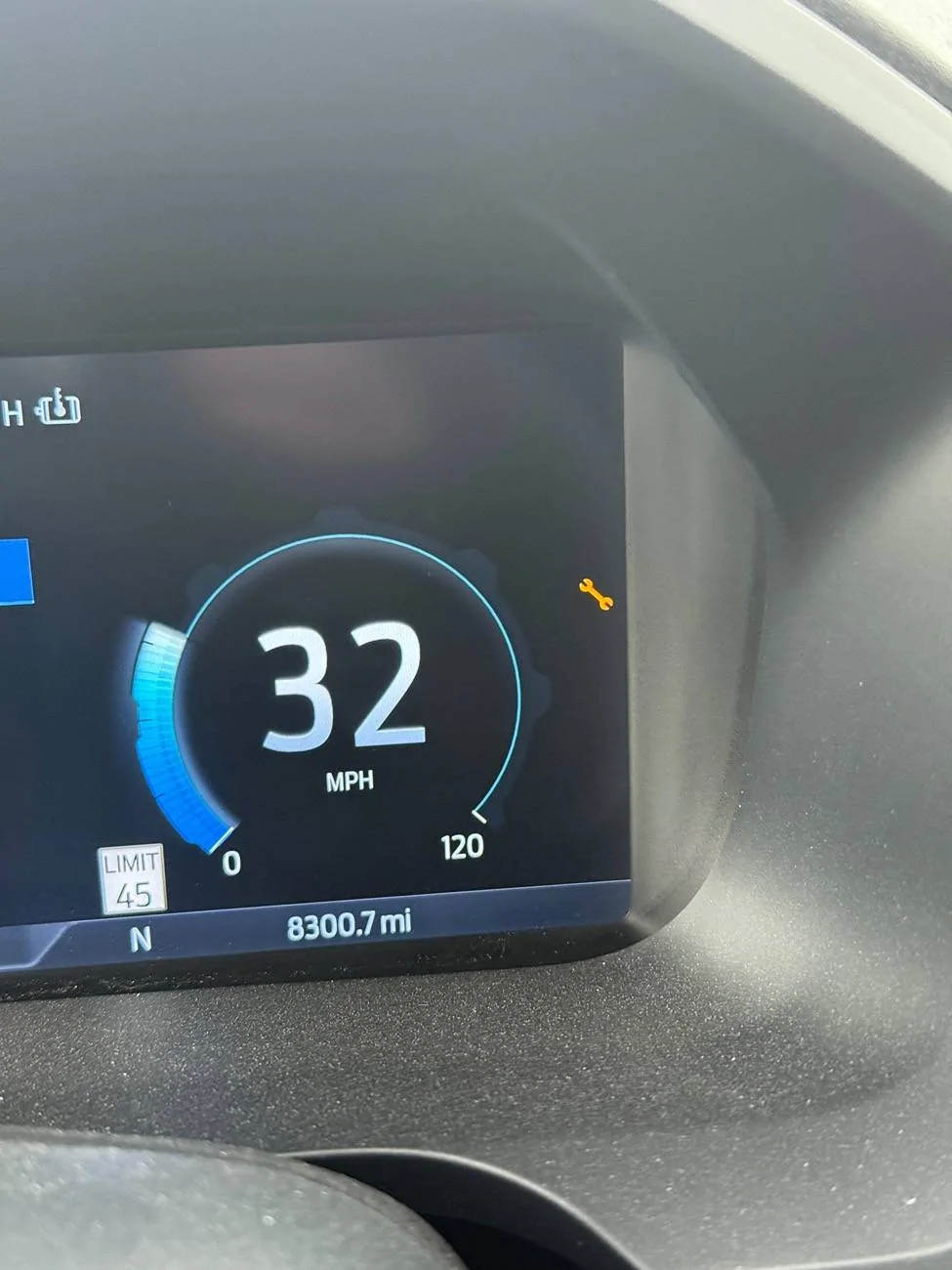

Welp, this happened as I was leaving work today.
Ford F-150 Lightning Lightning Software Updates using FDRS IMG_6091
Credit to my dealer, they got me right in so I didn’t have to risk driving 30 miles home tonight.
No idea if I broke something with updates or if it’s just coincidence. I heard of some people having module failures right after updates before. Fingers crossed it’s something simple…

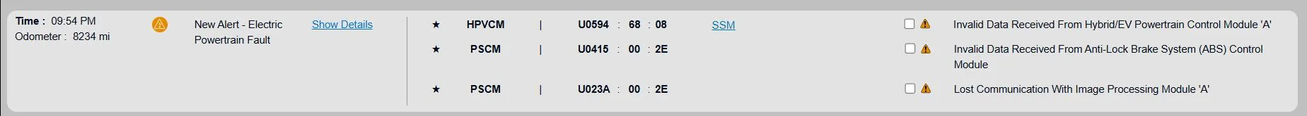

These are the codes that triggered the hard fault. The SSM referenced by the code is of no help (see attached).
Ford F-150 Lightning Lightning Software Updates using FDRS 1745362072656-z
It also reported this new code. The TSB referenced is also attached.
Ford F-150 Lightning Lightning Software Updates using FDRS 1745362185692-ag
However, it seems to be the first codes that seemed to have triggered the hard code on the dash.
Thanks! It’s interesting because those codes are time stamped from last night but it didn’t throw the wrench icon until around 4pm central time today.
Interesting. The codes were there today, too.
Dealer just called. Said the GSM needs to be replaced and the part won’t be here until Monday. Guess I’ll be rocking the loaner for a few more days.
Glad it wasn’t any of the modules I updated that caused the problem. Weird coincidence, though.
