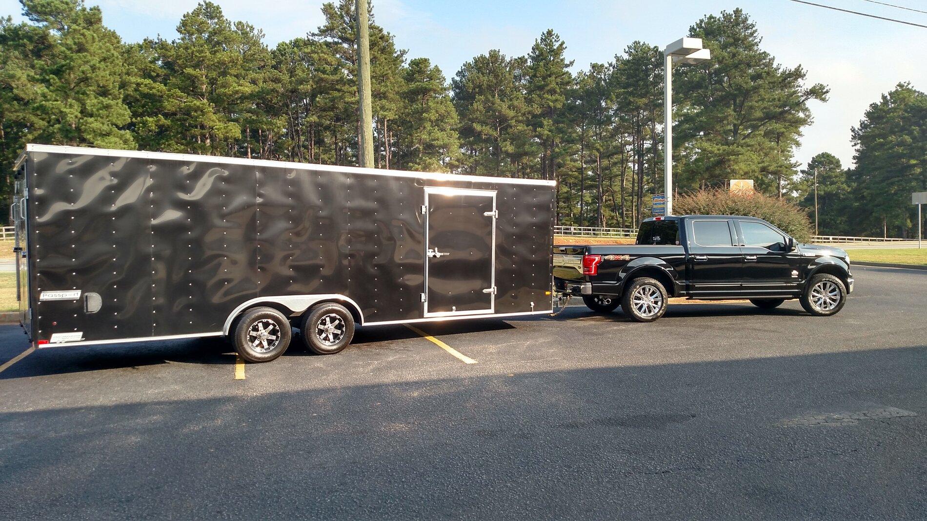

Ford F-150 Lightning First time Towing and Terrible MPG - PowerBoost IMG_20160804_085443999_HDR
I pulled a 24' enclosed car trailer with my 2016 F150 King Ranch 3.5l Ecoboost and would get 9-10mpg hand calculated on trips to and from Florida and Michigan.
