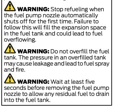

They also do silly things like their nonsensical "one click method" (topping off the tank after the first time the pump shuts off as gas reaches the top) which goes against the instructions in the owners manual (not to mention topping off only introduces inconsistency, it doesn't make the fuel measurement more consistent.)
https://www.ford.com/support/vehicle/F-150/2021/owner-manuals/
