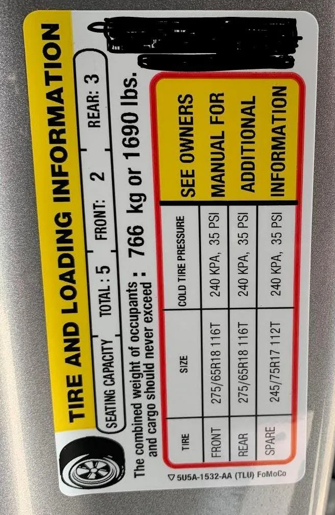

You might want to revisit your math a bit. Below are the specs of a 2021 XLT Powerboost. Payload is 1690. Given the 10% tongue weight (though it looks like you were using 8% earlier) for the 12,700 capacity:
1690 - 1270= leaves 420 lbs for a couple of passengers. It definitely can be done. You just picked the wrong options. Ford probably should have a specific tow rating for each truck for those who don't understand how tongue weight works but I suspect they expect someone with a trailer to have this basic knowledge. It is definitely possible but not with all configurations.
From a thread on payloads:
2021 XLT Powerboost, 302a, ProPower 7.2kw, Tech tow package, B&O sound, lock storage, power pedals and Sport package.
payload = 1690
price w. TTL 51K

I said nothing about a buffer. My truck has a sticker that says it can tow 12,700 pounds and another that says it has an 1,140 pound payload capacity. Both ratings cannot be true on one truck, full stop. I am VERY educated on towing, have a CDL license for use with my F-350 which has a 32K towing capacity when pulling the big car hauler on fifth wheel. I've towed to the four corners of this country and many places overseas. Stop patronizing. This is BS and you know it - throw out all the buyer beware - be educated crap all you want - 99% of F-150 buyers have NO IDEA that their 2" factory frame-mounted heavy duty hitch is rated to tow only 5,000 pounds no matter what the truck is rated to tow - UNLESS they use a weight distributing hitch. Burying qualifiers in off-page industry specs or even on the page in tiny footnotes is no way to do business - and the example above is Exhibit A of where it goes wrong - the truck virtually says - "here, do this thing with THIS truck" but then somewhere else says, "oh, yeah, but THIS truck cannot do this thing". Sheesh.

I believe it was me that used the word "buffer" right after I used the word personally, sorry if you took that as I was attributing it to you. Serious question, where is this sticker that says 12,700 located on your F-150? I also have a CDL as well as a resume , but unfortunately that doesn't exempt me from being wrong on any variety of things in the past. Up to this point --- I haven't been anything but respectful with you, including actually using the word respectful . I am genuinely trying to figure out where, A. your "sticker" is that ford put on your truck that says 12,700. B. Technically speaking I have a ridiculously small interest in Ford in the form of about $1286 dollars in stock, but I can assure you I'm not a special pleader for them. That being said, I have zero interest in making up 'BS' and giving "buyer beware" disclaimers. Maybe you are right about the '99%' of F-150 buyers not knowing what their truck is rated for, and if so- where does that leave you ? Every truck has those same stipulations attached and no other manufactures truck is different in this respect . Ford states this in their towing guide many many times (here's a partial example)-
"Maximum towing capabilities are for properly equipped vehicles with required equipment and a 150-lb. driver and passenger and vary based on cargo, vehicle configuration, accessories, option content and number of passengers. Maximum payload capabilities are for properly equipped vehicles with required equipment and vary based on vehicle configuration, accessories, and option content. See label on door jamb for carrying capacity of a specific vehicle. Horsepower, torque, payload and towing are independent attributes and may not be achieved simultaneously. For additional information, see your Ford Dealer "
Also here is said towing guide- 2021 Ford F-150 Trailer Towing Selector
You clearly can see it addresses everything you mentioned and more. If your arbitrary 99% number of F-150 owners that Have" NO IDEA " ( which Is kind of a direct insult to a lot of guys here btw , statistically speaking) read this, there's no more secret. What is underhanded or footnote-ish about this???? THEY LITERALLY MAKE A PUBLICATION EVERY YEAR SPECICIFICALLY FOR EACH VEHICLE??? to tell you down to the LITERAL pound, forget 'virtually' so your exhibit A is 'virtually' nonsense because Ford tells you exactly what your truck can do with respect to its capabilities in the form of the above mentioned publications. Sheeshx2
