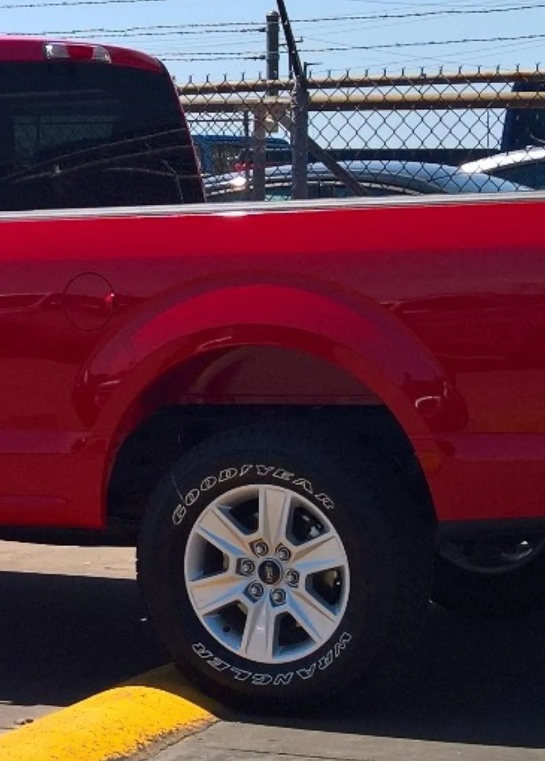

I know for many years the Max Payload option (HDPP) has only one wheel available and it's actually a stronger 18" wheel. And pre-2017, the HDPP wheel and hub was 7 stud rather than 6.
Here's the HDPP wheel for 2017 - 2020. (my brother's truck) 2700lbs of Cargo Capacity

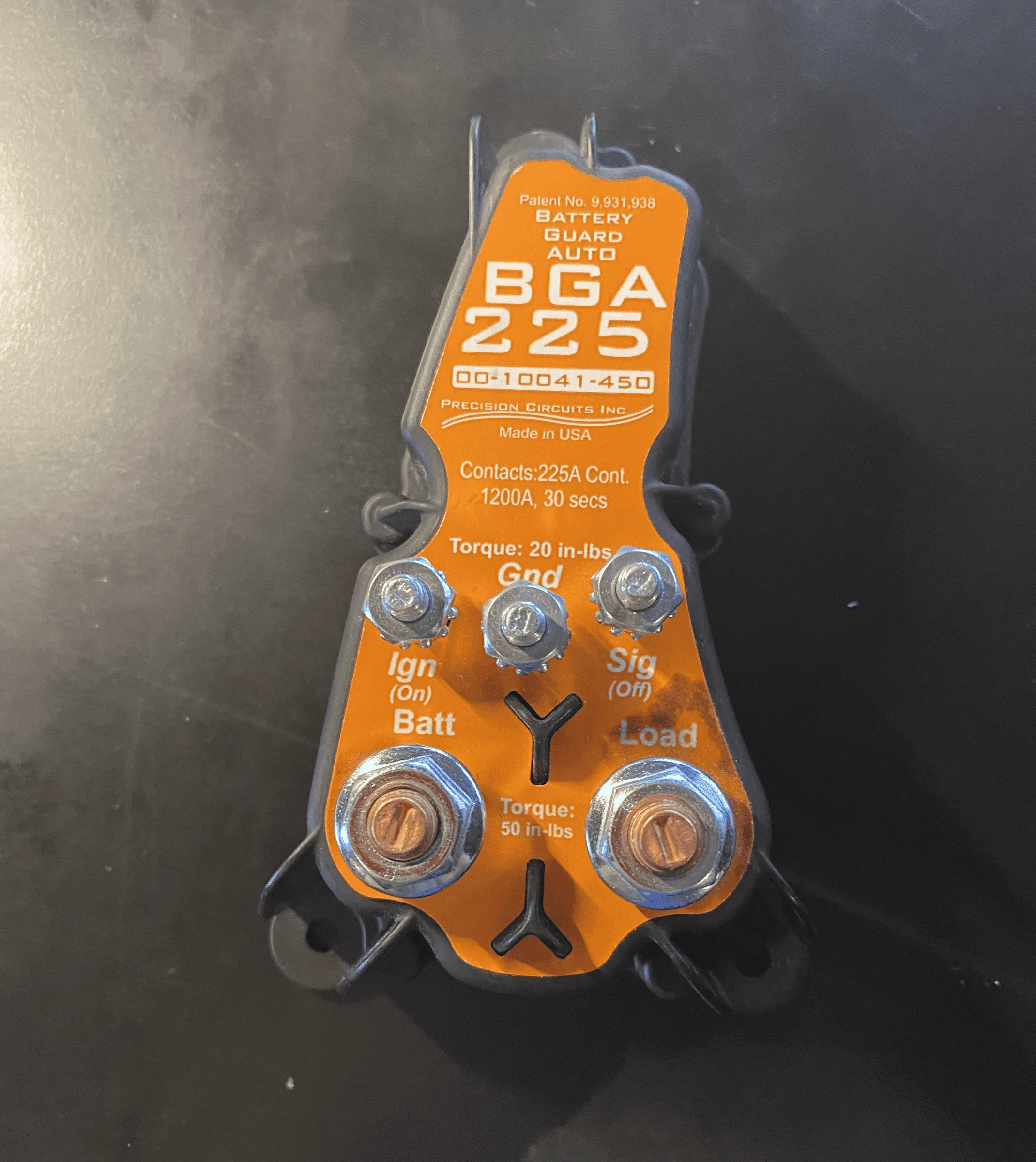

I just had my RV dealer install Battle Born Towable 30A 200AH GC2 kit into my trailer. The kit includes a Battery Guard Auto BGA 225 that apparently installes between the truck battery and the trailer plug and acts like a check valve and prevents back flow of power back into the truck when the trailer is connected but the truck isn't running. The dealer wasn't sure how to connect it because I have a '21 F-150 Powerboost Hybrid truck. Has anyone installed a BGA 225 in a hybrid F-150?

Not sure why you need that battery guard. My 2014 EB came with a that same sort of device that will not allow a trailer drain the chassis battery when the truck engine is shut off.
I'm almost positive I don't need it, since the truck is pretty smart. I just didn't want him messing around with the electronics.
Thanks for the reply.
