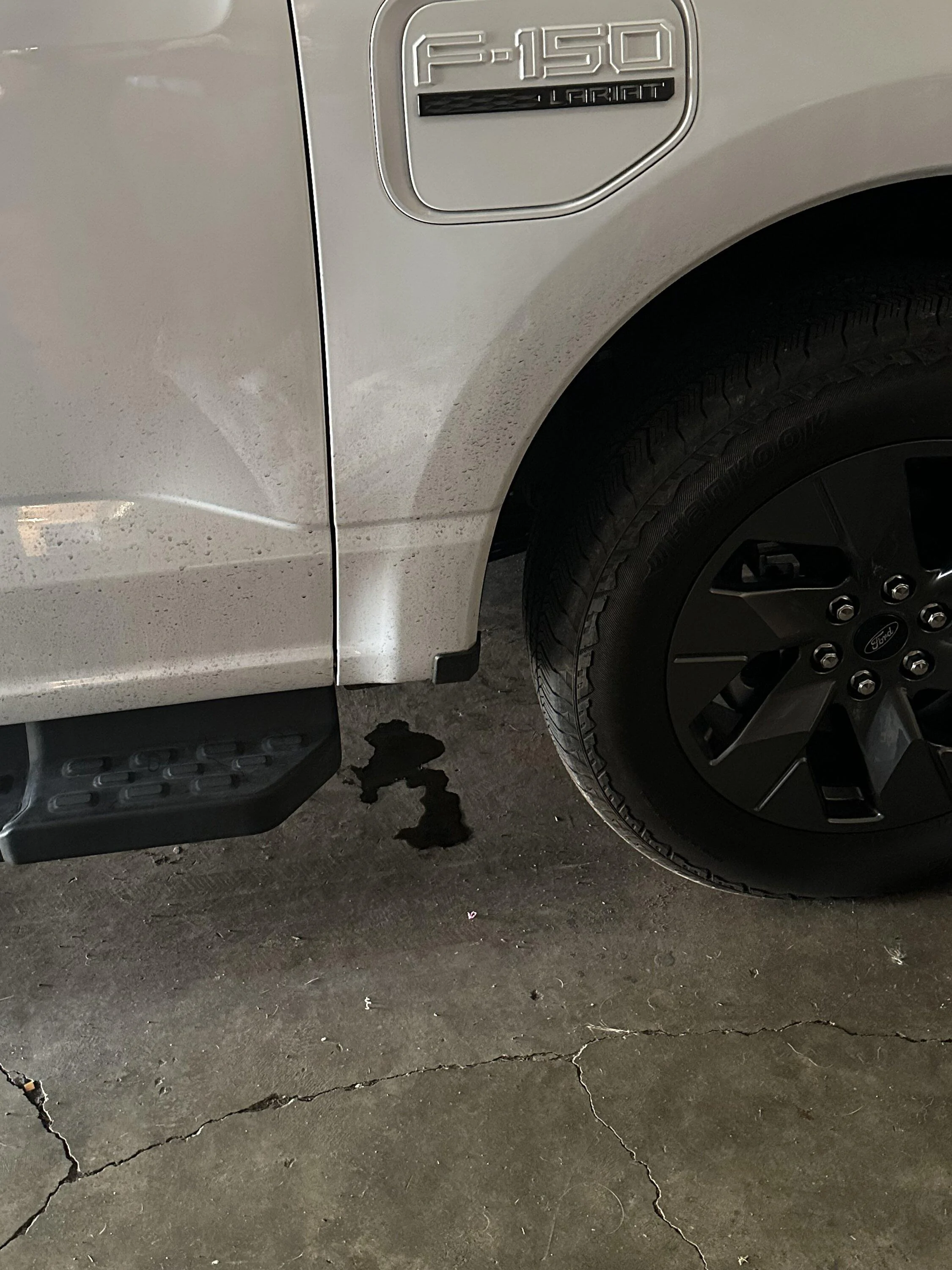

For the second time this week I’ve noticed a small fluid leak close to the front passenger tire like the photo. It hasn’t happened every day oddly enough. There hasn’t been any check engine light or alert.
Truck is new, purchased in Jan of this year and has 7000 miles on it.
Anyone know what this might be?
Ford F-150 Lightning Fluid leaking by front passenger tire IMG_2862

Water condensate from AC compressor most likely. Brake fluid and cooling fluid are on left front side of truck.

Yep, lots of AC use on these days. So it's likely just condensation and nothing to worry about?
Yep, if you see clear liquid it is almost always condensation. The fluid in the cooling system is neon yellow, and the lubricant in the motors is blood red.

There are also windshield drains that come out down there.
Condensed water comes from the evaporator coil of the air conditioning system. While I do not recommend tasting the liquid, you could dab your finger into it and smell it. 😉

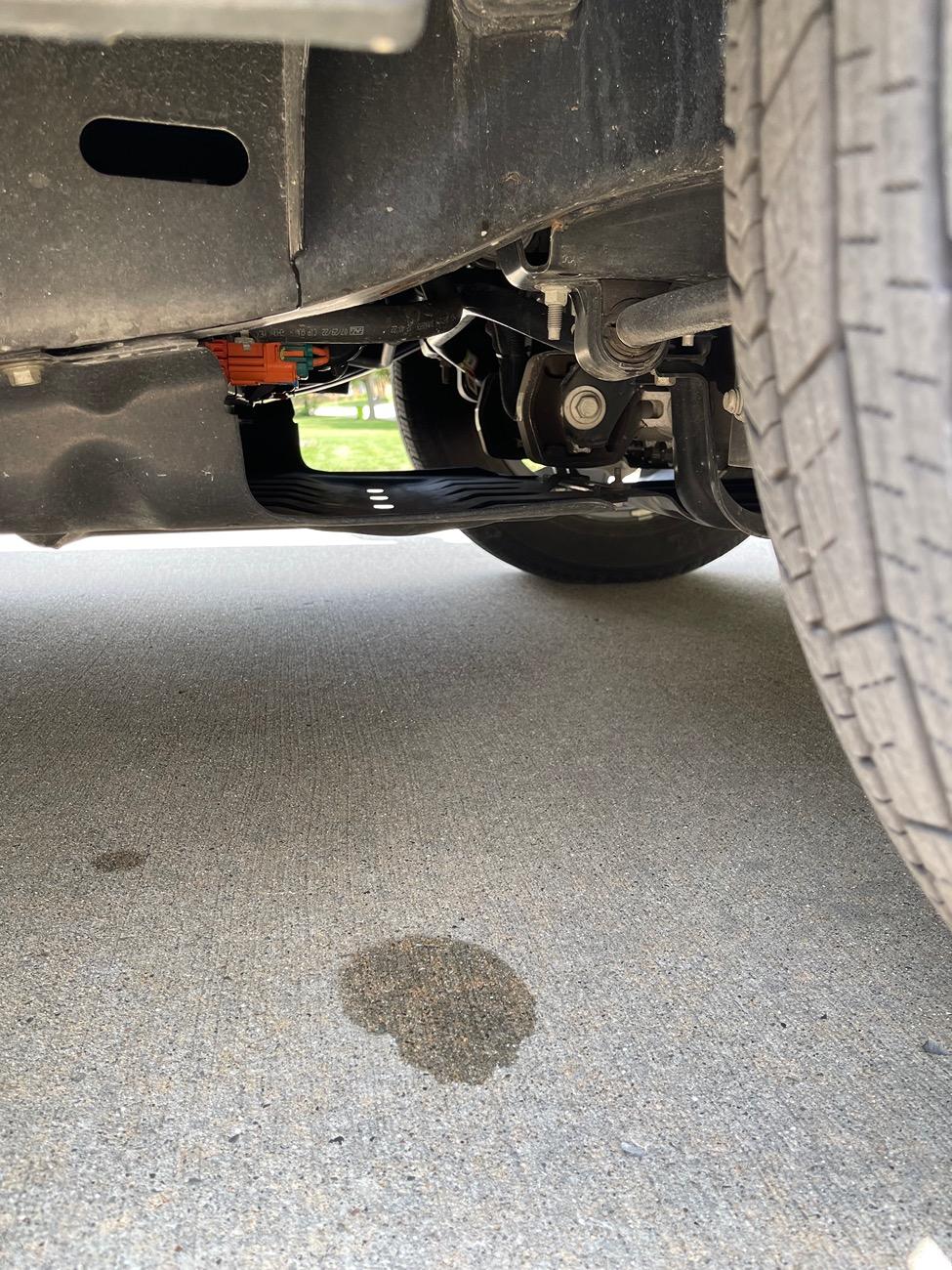

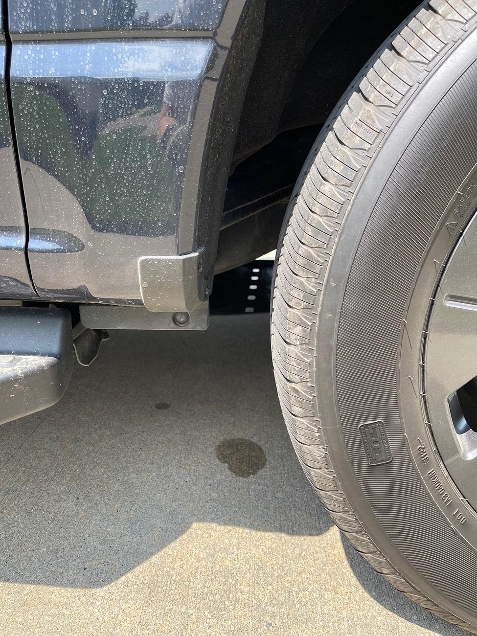

Hopefully it makes other feel better but I’ve seen the same issue twice this summer with the AC on and it’s really really hot and humid outside here in MI. Snapped a pic just for comparison but looks pretty same to everyone else. I was like what the heck until I saw other post on this thread 😁
