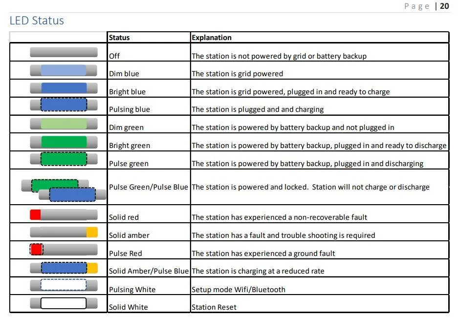

I woke up this morning to an 11% battery level like I left it when I parked and plugged in the truck last night. It seems the Ford Charge Station Pro "locked" itself overnight (flashing blue/green light, per the manual indicates the charger is "locked"). The manual doesn't say anything further beyond that. Resetting the breaker did return the charger to normal state and the truck did start to charge, but obviously this is less than ideal.
