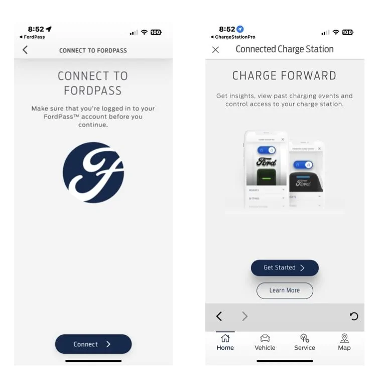

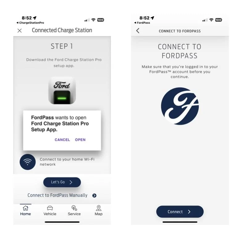

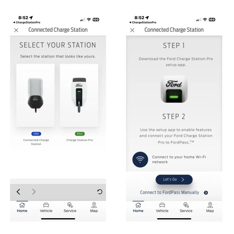

I try to connect my FCSP to FordPass and keep going round and round with these screens. It just keeps going back and forth between FordPass and CSP Setup apps.
Hit cancel, also turn off the mobile device wifi, use your cell connection.
This is assuming the FCSP has bonded to your home wifi
I’ll try it
