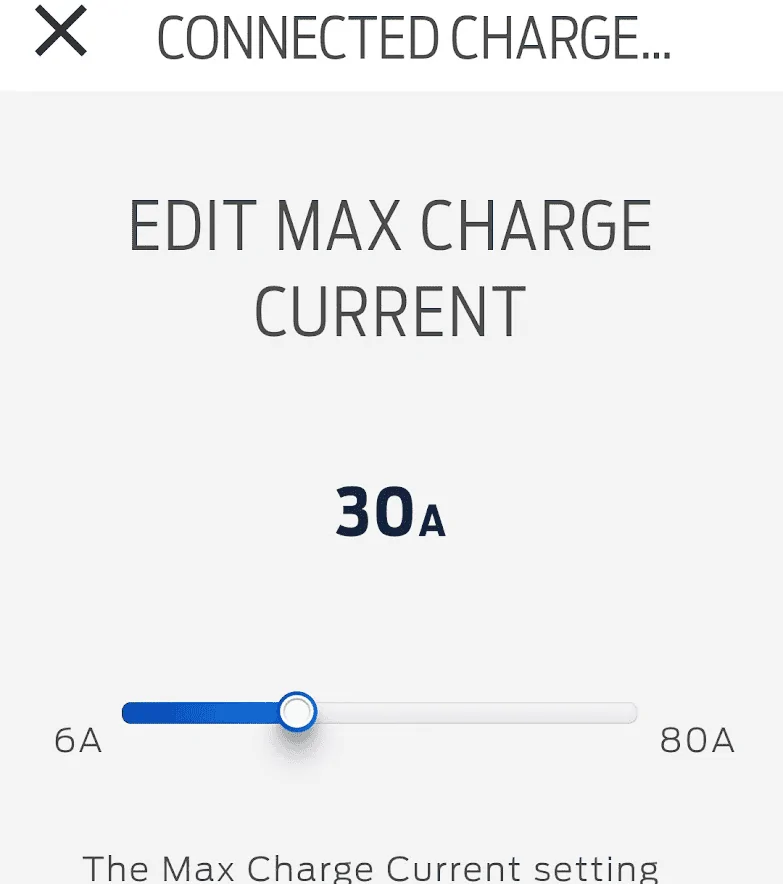

Hey, I just installed my Charge Station this week and it all doing fine except when I try to change the Max Charge Current through the app. I does show a massage that the setting has been successfully changed but nothing happens. I can tell you for sure that nothing is happening because the multimeter still shows a draw 78-79 amps and also because I do not get the amber light showing that it's charging at a reduced rate.
I have switch of the breaker for about 1 hour, then back on and nothing. The charger does update the status in the app when it's ready to charge, charging or just plug-in. Also it does update the Charge Events. But the it does not save the max charge current. I have also tried doing it when plug in to the car and nothing.
Does anyone have found a fix for this?

Yeah but I wanted to charge at a lower app setting most of the nights to take better care of the battery. I was thinking of lowering to 30 amps like the mobile charger and if I needed a faster charger then to go up to 80amps again. But the app setting says the new setting was saved but the charger does nothing, it keeps charging at 80amps.
I know I could usted the mobile charger that comes with the car but that would mean I’d have to make a new electric installation and also pack and unpack the mobile charger every time.

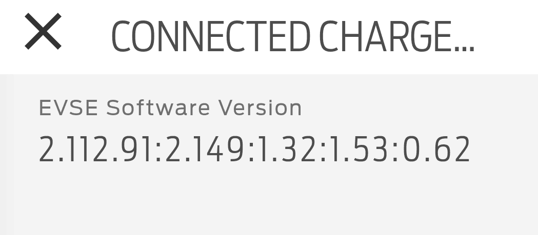

I tried before plugging it in, after I pluged it in. Also powering down the Station for 1 hour and then change the setting about 30 minutes after I powered it up.
The weird thing is that I do get real time information changes of the status of the charges. So the charger is communicating fine with the server except it does not apply the max charging rate when I change it even though it does say it successfully changed.
and last the firmware version is the same as the one you have.

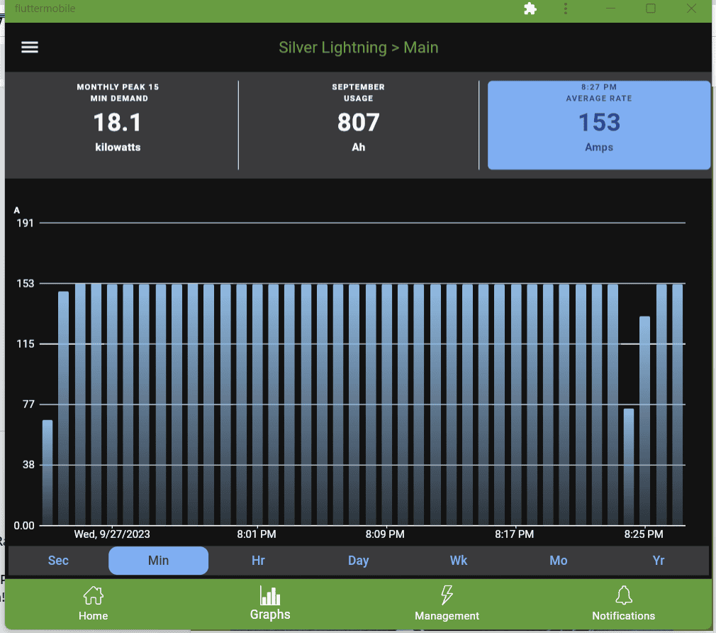

Note: my system was installed to operate at the full capacity of 80 amps on correct wire for a 100 amp circuit breaker. This chart shows my effective rate is 75.15 amps per line, the Emporia Vue2 adds the values seen in the chart for amps

Getting back to this thread, I have tried multiple times turning off and on the breaker to the FCSP and it only worked twice. I set the apps to 32amps and it did work for about 3 or 4 days. Then out of nowhere it went back to 80 amps. The next day I tried to power cycle it and nothing happened. The app says that the setting was changed successfully but it does not change. So I put it back to 80 amps for a couple of days and then tried again and it worked. Only for it to go back to 80 amps after a power outage of about 10 minutes. So I'm giving up on the app and went to plan B.
Plan B being to drill a 5/8" hole to the black cover and put a rubber plug on it. This way I would only have to remove the top cover and then remove the plug and manually put the FCSP dial to #3 o #4 (32 or 40amp) the then plug it back up and put the top cover. Literally it only takes 1 minute and it works.
I don't know if it's the app or the charger but for the $1,300 it costs I think it's very very glitchy. A friend has the Emporia charger and it works flawlessly. I wish the FCSP worked the same way.
And I know I'm gonna get heat from some people, but really all I want is to charge the car slowly most of the time and then if I need to charge it at full power just switch and go. And this is the solution that has working recently.

Mine did the same thing last night. After struggling to get the 40 amp software limit to take in FordPass, it went back to an 80 amp charging rate when I plugged in last night. FordPass still showed it set to 40 amps. As soon as I adjust it to 42 amps it took.
The problem with mine is that it will not take the new setting after it reset itself from 32 to 80 amps. No matter how many times I change and save the setting.
