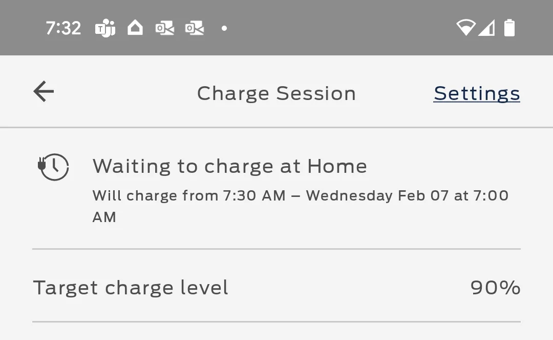

Meanwhile the app thought it was waiting to charge.

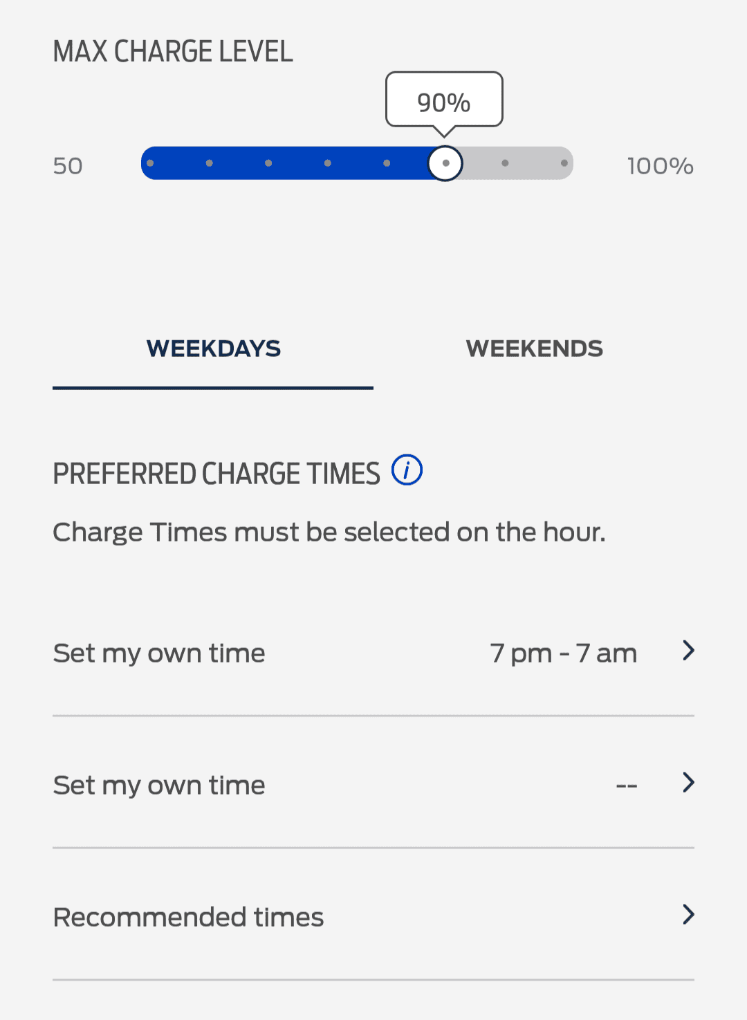

These are the settings, confirmed and originally set in the truck as well.

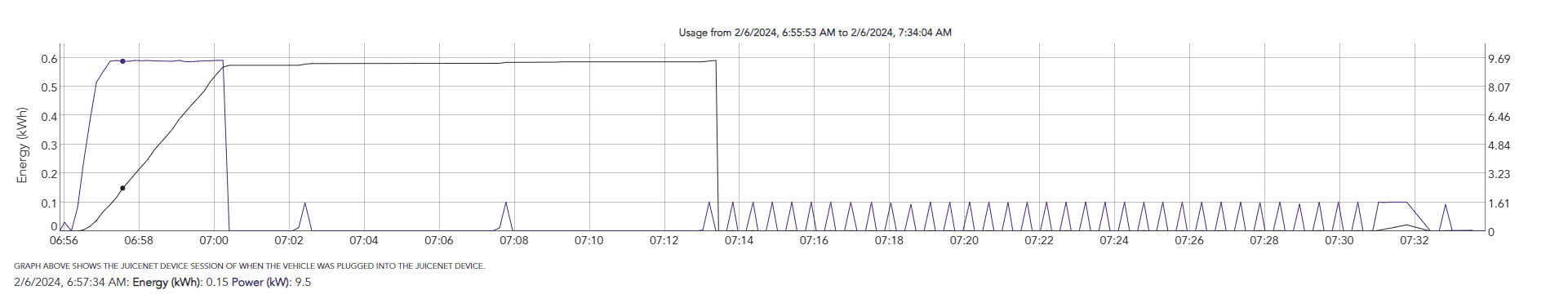

It only happens when I create a profile, and it seems to go nuts immediately after it hits the "Do not charge time". You can see on the graph above all the start/stop cycles starting at around 7:13am where it should not be charging at all.
