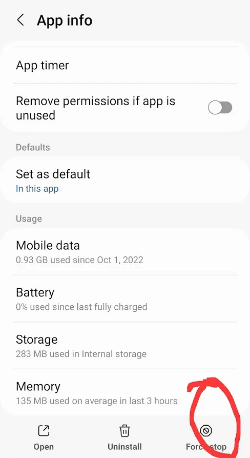

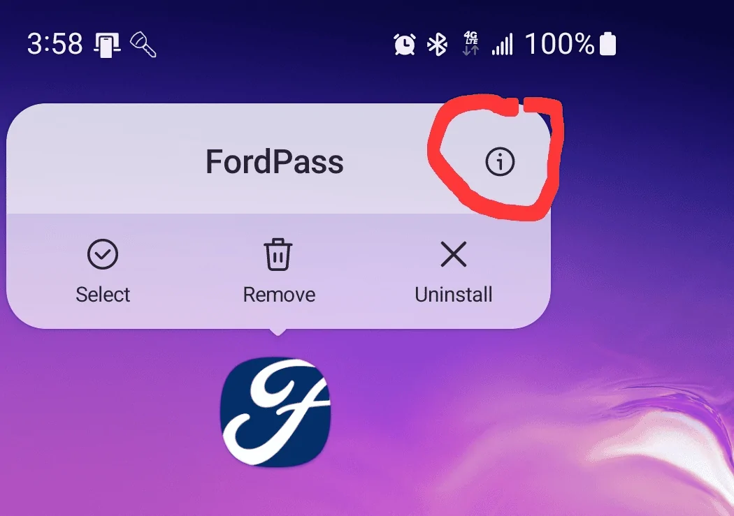

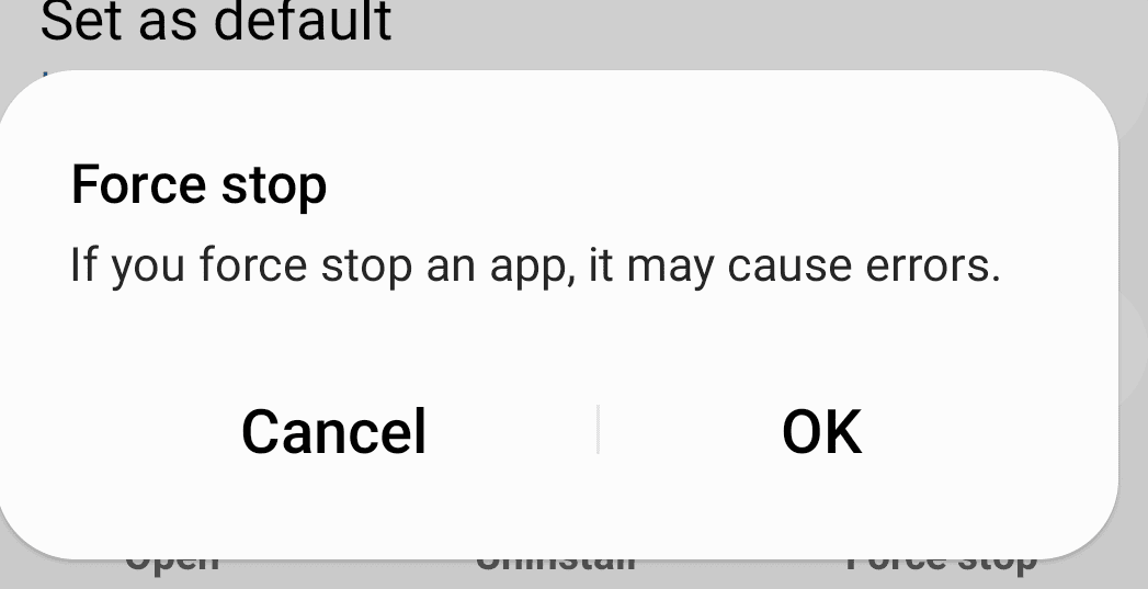

I did both and it didn’t work. How do you do a force stop?
press/hold the app Icon, the a context menu will pop up, click the i
Ford F-150 Lightning Ford Pass app no longer communicating with my truck 1673816419234
Click Force Stop (Android) and OK.

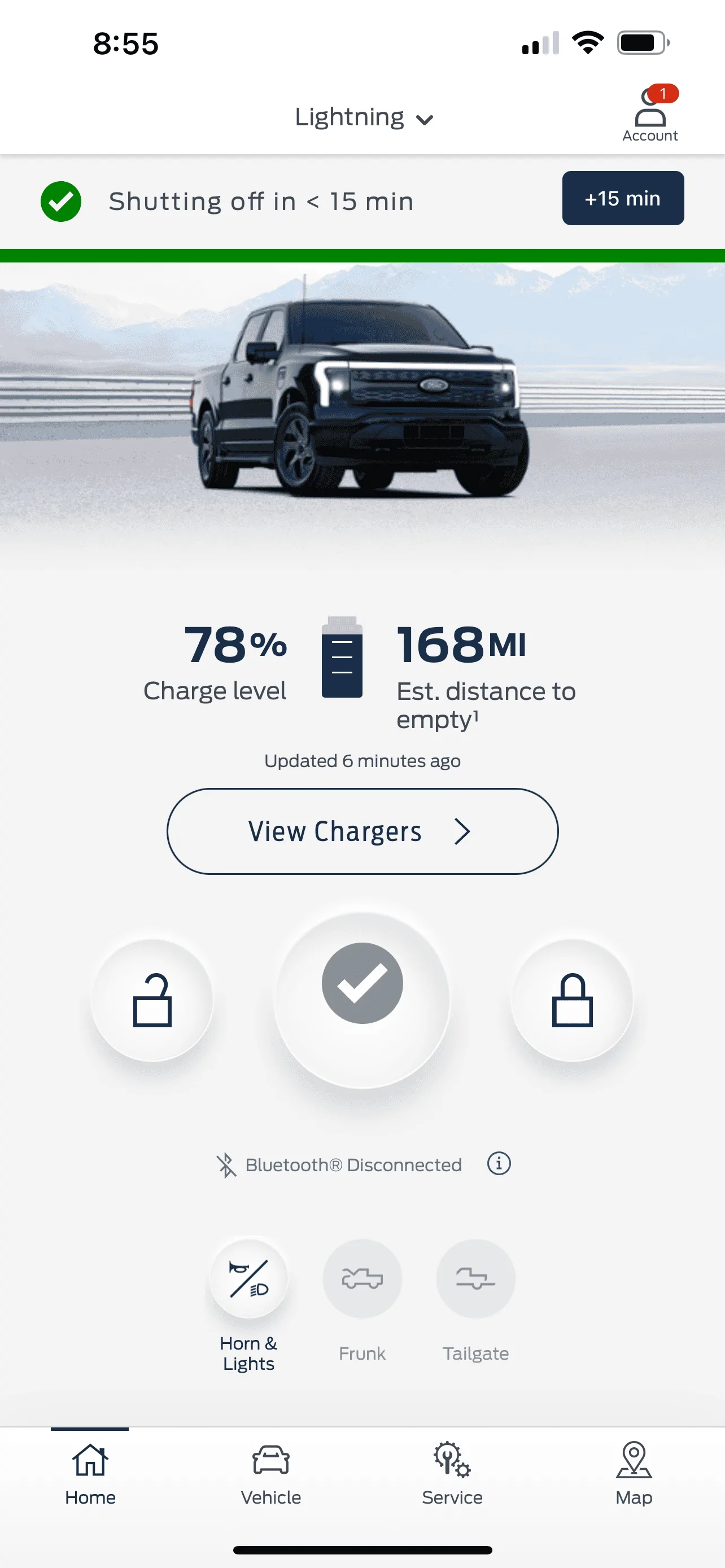

New delivery- I was able to set up PAAK. Lock, unlock, start all work.
Are you not able to open the frunk/tailgate with the app? Mine is greyed out
