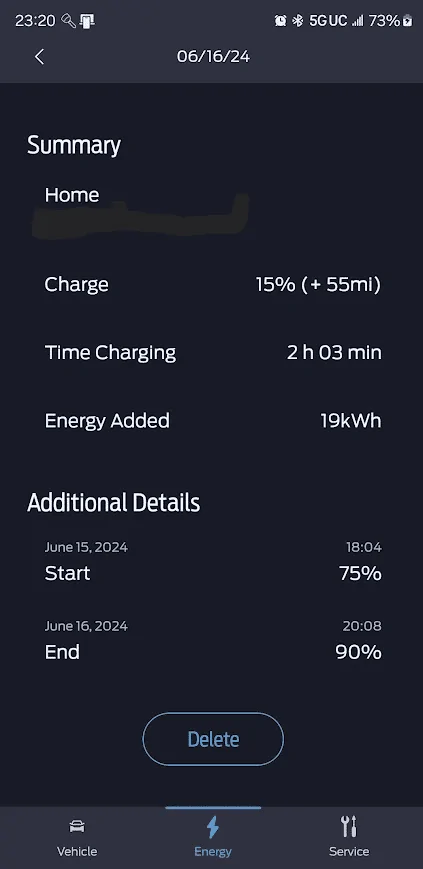

This is how tonights charging session log entry looks, pretty close what happened, but I've also seen the off the wall stat's like your screenshot shows.
note the end date shows June 16, 2024, but it was really the 15th Suspect UTC is being computed on the date value

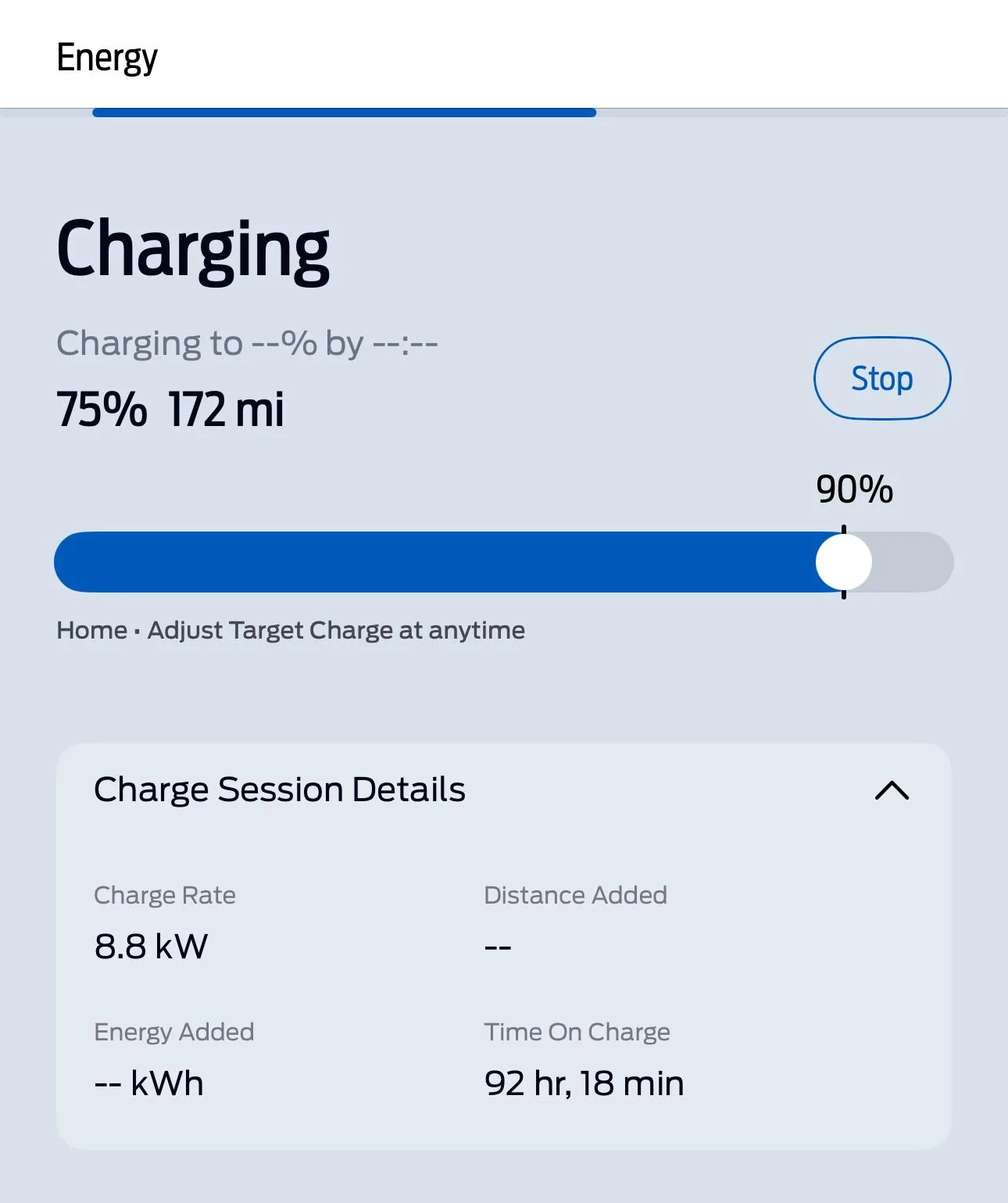

Mine just acts like it’s updating but never does. Keeps reverting to 100% after I select 90%. How can they get this so wrong in the FordPass development ART?
