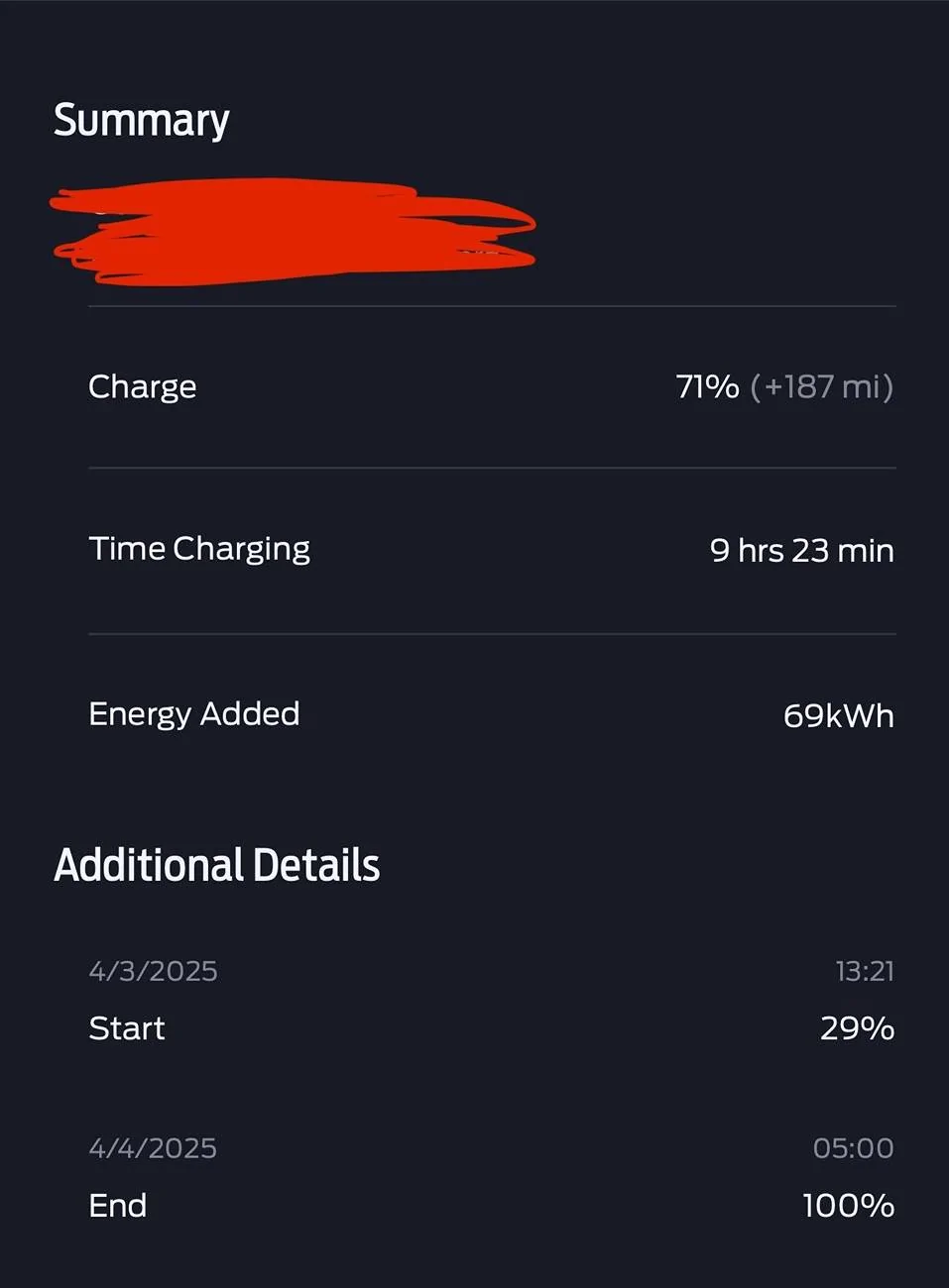

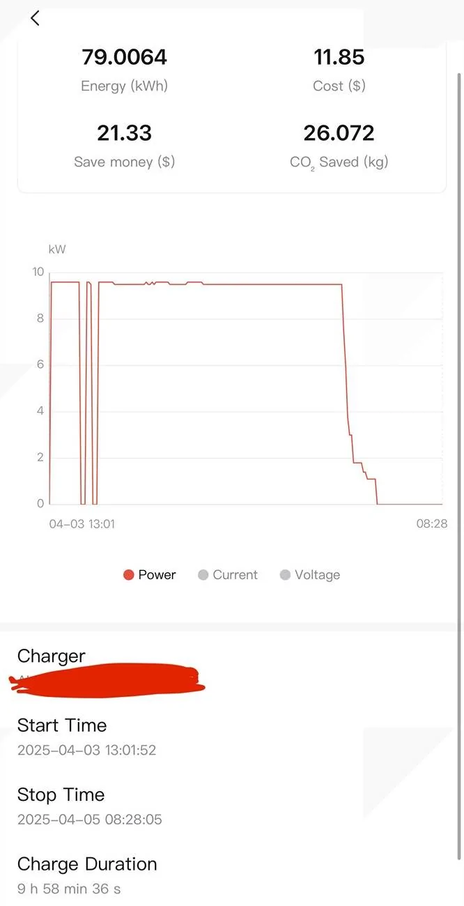

Here is a perfect example of what occurred yesterday. I set a charge limit of 80% and started a charge at 1:21p via the FordPass app. The vehicle started charging and said “Charging to 100% by ####time”. Obviously incorrect with having set a limit of 80% in the app.
So… with the charge ongoing I attempted to set the charge limit 80% instead of the 100% it was going to charge to in error. Each time I attempted to set a charge limit, it would display question marks while taking several minutes to respond in the app. Then….. it would stop the charge unprompted.
I restarted the charge several time and attempted to set a limit, each attempt resulted in the charge stopping as indicated on my Autel charge history graph. I have already submitted this feedback to production and beta versions of FordPass.
I will screen record this occurring and upload.
