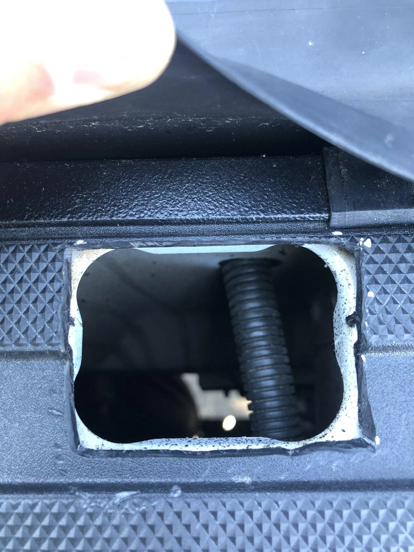

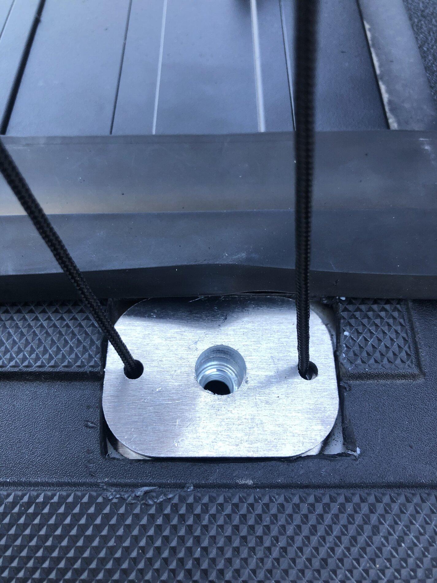

I cut mine out this weekend in order to mount an Adarac. Mostly followed this guy’s older video and the dimensions were spot on. I did find it easier/cleaner just to use a utility knife after drilling an acces hole (vs. dremel or jigsaw). Not factory quality, but turned out pretty good (and it’s covered anyway!). Note the wire bundle passing through each front pocket (in case you’re planning to insert something all the way).

I'm looking to do the same uncovering of the front stake pockets as you did to install a Thule TracRac SR using base rails along the edge of the truck bed. The rails are secured by inserting an expanding rubber block in each of the pockets and tuning a screw mechanism to expand the block and anchor the track rail. My concern, based on your picture is the wire bundle running through the lower part of the pocket -- can you remember the distance from the bundle to the top of the pickup bed rail? I think I only need about 1.5 to 2 inches of depth, but before I start cutting I'd like to make sure that I'm not causing an electrical problem by using the stake pocket this way. Thanks! -- Greg

Unfortunately, I did not measure, but I believe there is only about 1" of clearance until you hit the wire bundle. However, the bundle is flexible and can be pushed further down. The trick would be if you need the whole stake pocket space - that might interfere with where the wire bundle enters and exits the pocket (hope that makes sense). I don't think you'll cause any damage if you open up the pocket and do a test fit of the rubber block.

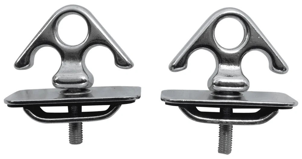

I don't see why you cant use something like this. The pockets that are covered near the cab don't have a reinforced pocket but are still useful mounting points.

What I saw on the front passenger side after I cut the pocket out was a black corrugated plastic sheath, roughly 3/8" in diameter. Not sure what's on the inside, but looked like typical protective wiring shroud. It ran across the width of the hole, maybe 3-4" below the top surface. Regretting not getting a picture, but it's all buttoned up now...
Would you mind calling out where you found these? I did buy Bull Rings for the rear, but like the idea of these for the front. Potentially less water ingress and easier to install. Thanks!
