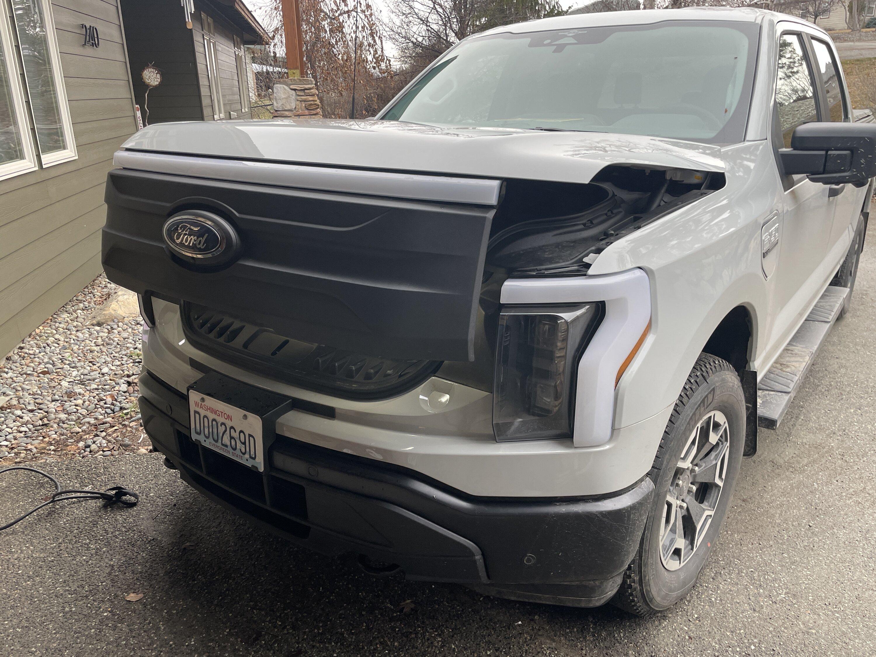

Hello all, I'm looking for a little help. I recently followed the online threads and tips and installed a hood light bar on my SR '23 Pro. Install was a little bumpy but I got it in and working!
however...
once fully installed, my hood frunk release button didn't want to work at first and I was afraid I had shorted something. It did however start working again - but fast forward to this week and when I tried to pop the frunk, it only raises about 12" then stops. It will go back down and latch but from all buttons, key fob and emergency latch inside the frunk, I can only get it to open part way.

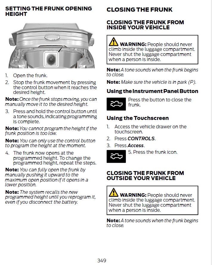

i have also tried to reset the height limit but that also doesn't do anything...
