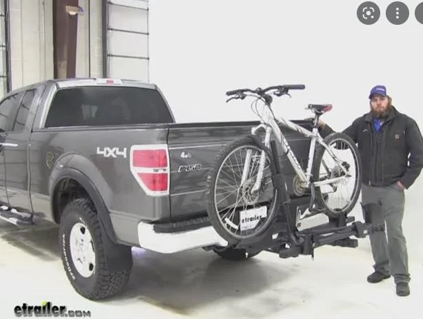

We're getting our RetraxPro XR & spray-in bed liner soon. Later this summer we're going to be driving about 2k miles round trip with a couple of mountain bikes. Options are either a hitch-mounted carrier or rack-mounted across the bed. I'm biasing toward rack-mounted because it'll make backing up better (no false alarms or blocking the camera), but curious whether people have a perspective or experience as to which is more efficient. I'm not thinking it should make a big difference either way, but since we'll be driving across the southwest and dealing w/ lots of charging I figured I'd ask just in case anyone had a perspective.

I'm going to keep my hitch mount because of bugs. I also have a bike bra for roof racks, which is the most like Option A. I'd suggest one, if you go that route, except that would be like an air dam. Then again, bugs may not be an issue where you are.
The bugs alone would make me favor Option B. It also would seem to be the most efficient, although aerodynamics back there are pretty wack.

I'd go with option B as well. The bikes will still mostly be in the draft of the truck while option A has them hitting a lot of fresh air, even if they have a narrow profile.
Do they make racks to mount in the bed or are you using a tonneau and storing stuff in there? That seems to be the best place from an efficiency standpoint.

I’d go with a hitch mount just for the fact they are so much more convenient to get the bike on or off. Kuat hitch mount can’t be beat.

I'm going with Retrax / Bed mount (and I already have a Thule hitch mount that's great) simply because the truck is long as is and I wouldn't be able to fit it in my garage with the bike rack mounted to the hitch, nor would I want the hitch mounted rack sticking out in parking lots.

Option B disrupts any laminar flow that might have been created from the tonneau. Using Poiseuille's law , I'm going for option A.

I put a Rockymounts rail system across the center of the front bed wall and got locking mounts. Didn't love the idea of having to remove the front tire, but the bikes feel safe and secure and don't inhibit towing or sensors/cameras.
